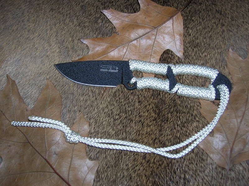

I have never had a knife like this one before. Can some of you guys that know how to cord wrap (or other wraps) post some info here about how to do it, where to get supplies or who I can send it to to have it done.

First, take all the guts out of about 6' of paracord - color of your choice.
I'd do it this way: Run 5' of that 6' thru the rear hole. Run it up to the front hole nad thru that as well. Now wrap back. AT some point, you're gonna get back to hte rear hole. TRY and wrap it such that you can pass it the same way thru. Tie it off somehow and then perhaps make some cool looking lanyard.
The key is holding it very tight as you wrap. If it's not thick enuf, take even MORE cord, start wrapping immediately after passing thru the rear talon hole and then wrap back to it.

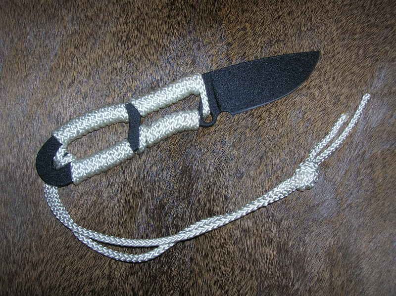

I did this while eating lunch today. Left about 8 inch tail from the rear lanyard hole. Just wrapped around the upper and lower "bones" of the skeleton. I used some light rope, about 1/8 inch diameter. I don't have paracord. It makes the grip bigger and easier to grip and doesn't add much weight to the knife.
