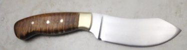

This is a straightforward using knife. I wanted to play with 80crv2, and I know of someone who got a hamon with a clay heat treatment. So, I wanted to explore the possibilities.
Well, I clayed the blade with satanite, just like I would a blade of W2 or Low Manganese 1075. Guess what? the whole thing hardened! I guess this is a successful experiment but a fail as a hamon.
Let me know your thoughts on the knife and the heat treatment.
thanks,
Kevin

That's a fine looking knife. What grit did you sand up to? The hamon may be visible right after heat treat to some degree then disappear as you start to sand then reappear at the higher grits. Here is an 80CrV2 blade I'm working on now. I did a simple edge quench. The hamon was evident after HT and followed the progress I mentioned. This picture was taken at 800 grit (I'm at 2000 now and still going). Of course I can't wait until I etch so I can watch the magic happen.
thanks for the advice. I didn't see much right after ht when I ground into it, either. I have had hamons be hard to detect during the middle grits, though. I kept hoping, but there wasn't any different feel to the steel, either. I think this is not as shallow hardening as w2...
kc
By right after HT I mean as soon as it comes out of the quench before you grind it. It would probably be visible at that point. Then you lose it as you start to grind. No this isn't a shallow hardening steel. I think the Chromium content allows it to through harden. As long as the knife hardened and makes a useable knife there isn't a sad ending to that story. The other thing I was thinking about was that my blade is 1/4" at the ricasso. If your knife is thinner, say 1/8" thick, there may not have been enough of a difference in thickness between the clayed and exposed parts to create a hamon. Another way to say that would be maybe you didn't have enough thickness in the spine to hold heat long enough to create a great enough difference in cooling rate between clayed and exposed areas, therefore not forming a hamon (whew! Now THAT'S a run on sentence! haha). It's just a thought.

Hamon wise from what I have scene is usually the basic line like posted. Not any activity or anything but a visible line. I think all the factors like the blade thickness as mentioned or edge quenching are gonna be what it takes to get a visible hamon easily. I think its more on the lines of 1084 style hamons.
Wanted to add maybe as J Doyle about it. He has gotten some nice hamons out of 1080+ which is suppose to be the same thing.
thanks guys. Matt Parkinson got a good hamon with this steel, but he posted a pic of his clay and it was way thick. So, he had to really work with it to coax it.

I think I like it. It is definitely very abrasion resistant. It is very fine-grained. There are also both chromium and vanadium to form some very hard carbides even though the steel is eutectoid. So, it should hold a very fine edge (not too many big carbides), and wear well, with the fine grain and some carbides for hardness.
