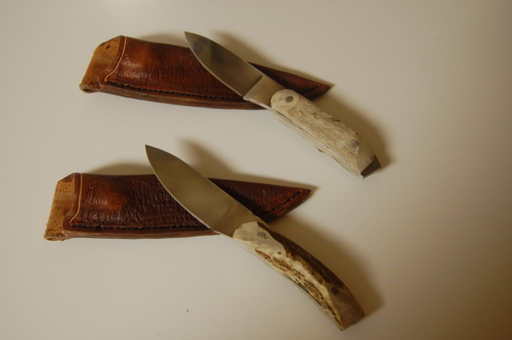

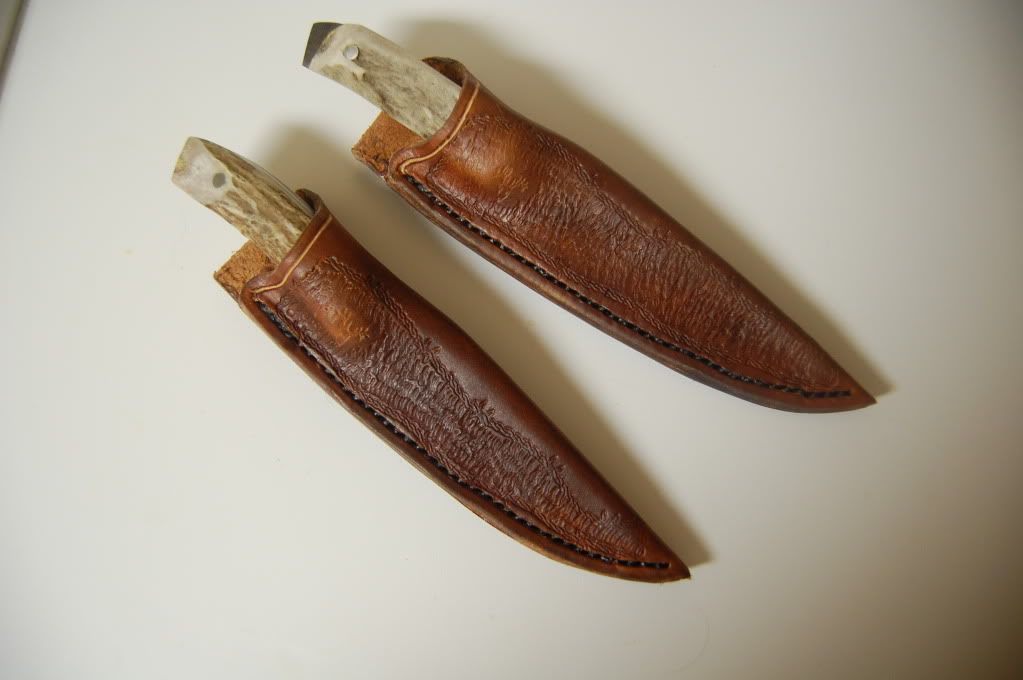

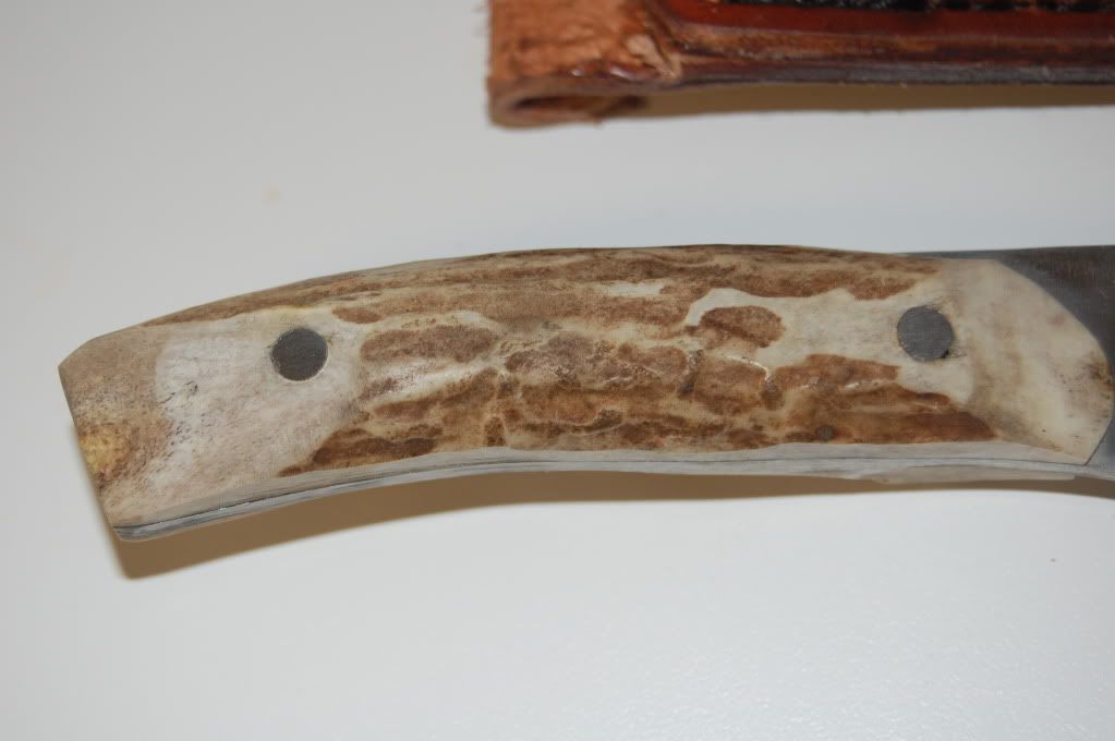

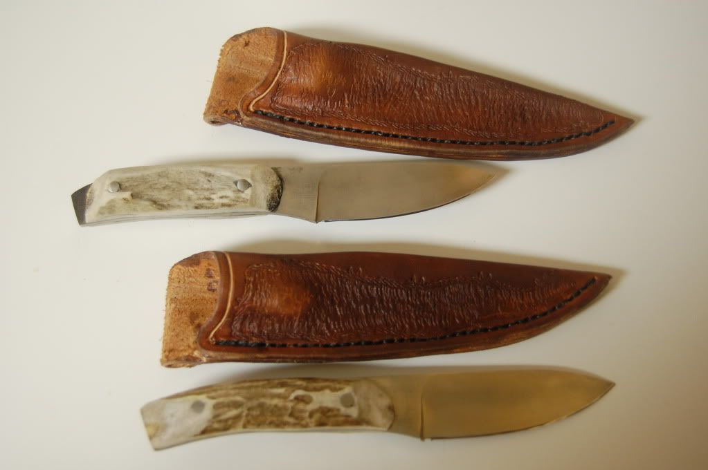

These are two I made for one of the guys at work. I hate trying to make full tangs with antler scales. The customers that want antler handles always want me to use their antlers, too. I'm just up front with them that if they want their own antlers on it then you might end up with what we have here, which is one that's pretty good and one that the scales aren't big enough to cover the whole tang. I think I'm going to get out of the antler business altogether soon. It's just too much damn work and waste.
They're 1/8" stock removal O-1. SS pins. 3" edge, 7.5" overall.
