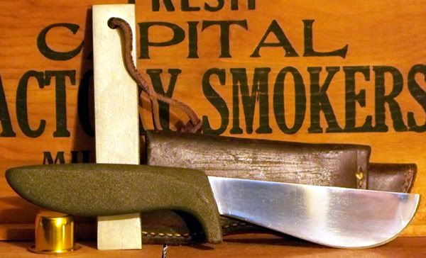

I have skinned small game (rabbits, squirrels), medium sized (coyotes), and large (deer), and long ago found the easiest ways to deal with each. Small game requires a pocket knife and hands to simply peel the hide turning it inside out as you pull it from the head down to the tail using a folder to make the incision at the head and to cut the joints at the feet. For everything larger I use a Gerber Flayer I have had since I was a kid. It is not a drop or upswept point, rather the spine is straight. I tried a Sharpfinger as well as a Loveless style drop point but nothing has done the job as well as the Flayer. The big belly and big round tip just makes skinning easy, especially around smaller areas (legs, neck). The Flayer blade is also thin and flexible like a fillet knife which also helps.
