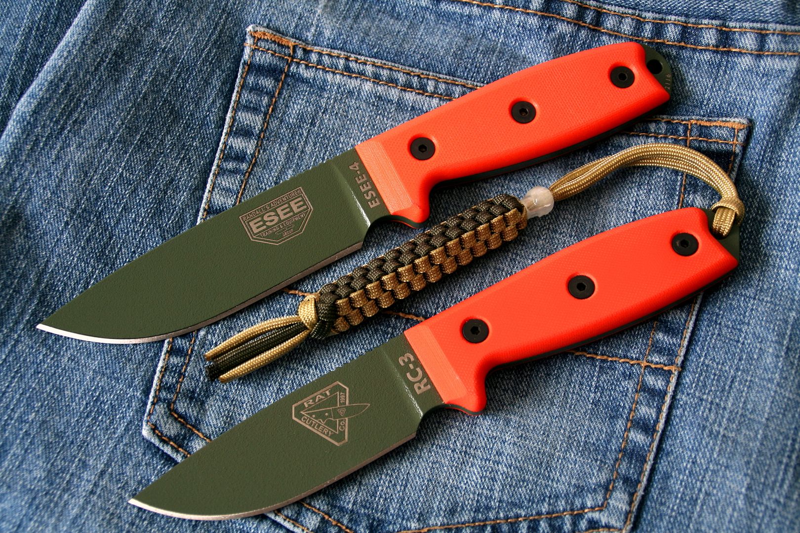

So I recently added a few 3's and 4's to the collection -- the 3's impressed me, and the 4's impressed me even more:

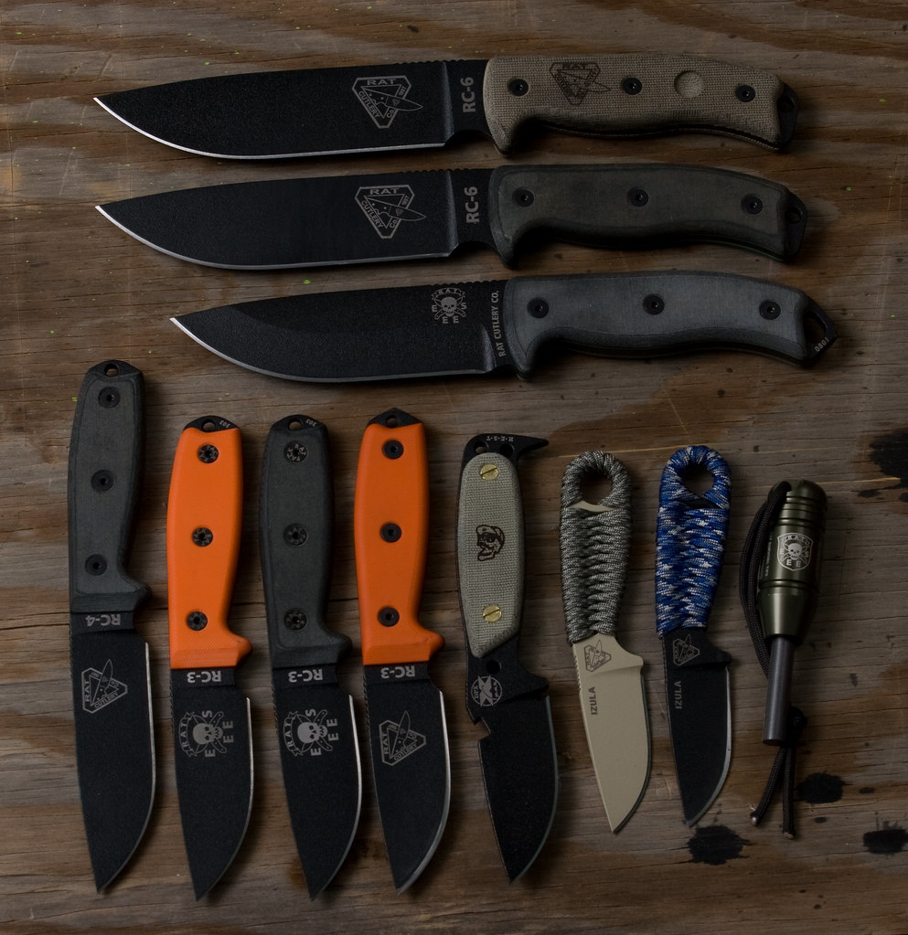

I have two 6's if that tells you anything :) (time for a new family photo...I've added a few (or more) more)
