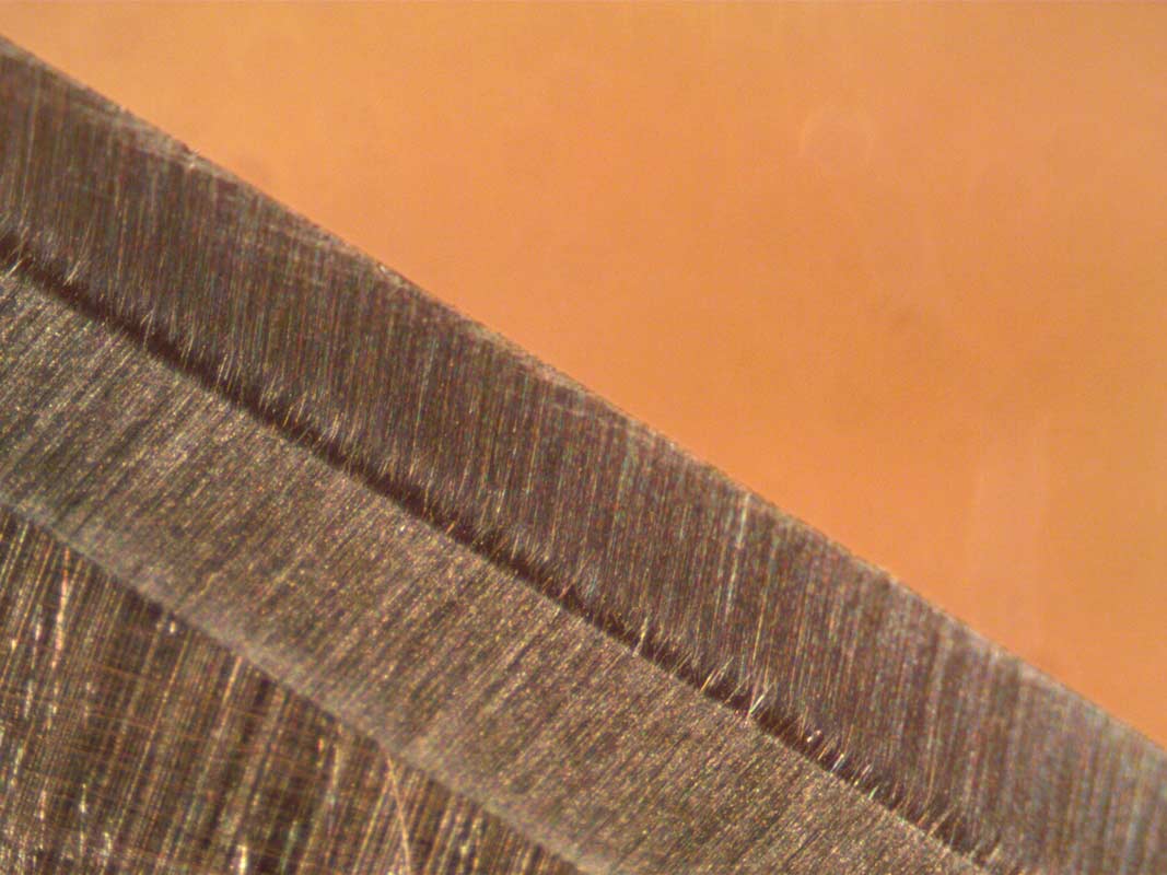

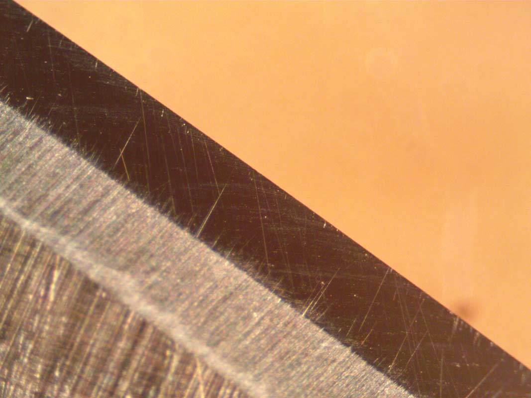

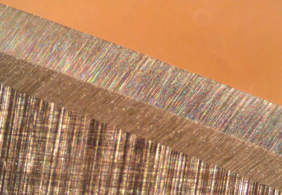

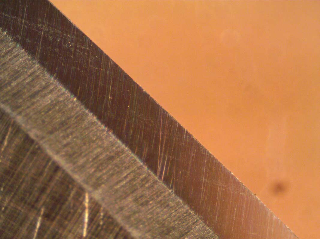

Here are some photos. Keep in mind they show a lot of sharpening mistakes but I was mainly interested in the polish. I know I have a lot to learn. The main bevel is around .01" wide for scale. The lighting really highlights the scratches on some of the photos, which is what I was trying to do. The knife is a Henkles paring.
1000 grit stone
2.3k polishing stone, obviously missing the edge here.
3k tape
4k polishing stone
1000 grit stone
3k tape
4k polishing stone

Appreciate the pictures my friend. Hmmm it looks like I can safely skip the 3k tape?..
