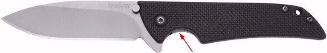

The Kershaw Skyline is a great knife, and gets good reviews here.
One downside, though perhaps minor, was that the linerlock was difficult for me to
release due to the scale choil nearly covering it up...as shown in the production pic below.
Skyline, as produced...

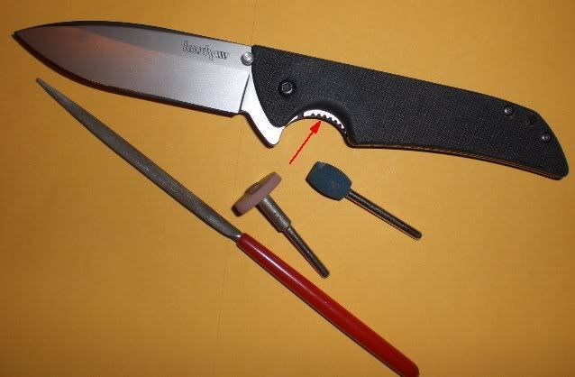

My cure for this issue was to relieve the choil somewhat, using a Dremel tool, with rubber/abrasive disks.
To prevent abrasive dust intrusion into the works of the knife, poke some bits of toilet tissue into the
front and back frame openings, and between the blade and the scales.
I then used a half-round machinist's file to 'fair' the Dremel work smoothly into the lines of the G10.
This leaves the glass fibers of the G10 exposed, but these are easily polished up using Carnauba or
Beeswax, leaving a shiny surface. The pic below shows the finished mod, and the tools used.
With this slight scale relief, the lock is now easily released with gentle thumb pressure.
Skyline, with choil relief...
