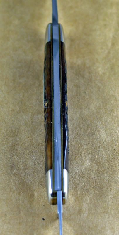

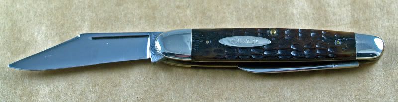

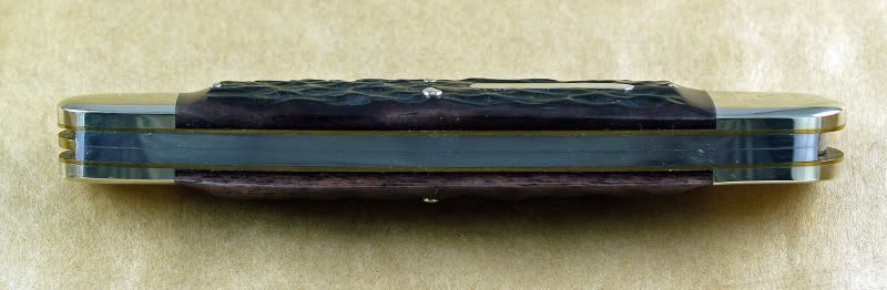

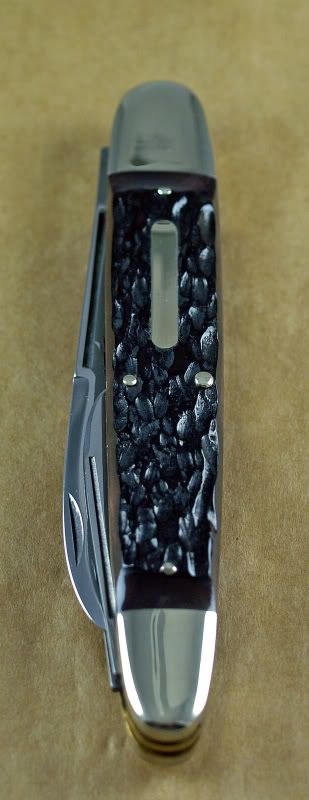

Here are a couple of Sleeveboards, one with a single back spring and 1 blade on each end. Masterblade on wide end, second smaller blade on narrow end. A sleeveboard whittler with master blade on wide end and 2 blades on narrow end with two springs and a catch bit. You could have a sleeveboard whittler with a split back spring and one with a split back and tapered wedge as most modern whittlers are made. I haven't ever seen a 4 Bladed Sleeveboard but maybe there is such a pattern. You can certainly have a sleeve board pattern with a single blade on the wide end of the frame. If you put the blade on the narrow end to me it would be a swell end Jack pattern.
Sleeveboard refers to the handle shape only. It can be a pen pattern with blades at opposite ends, or a jack pattern with both blades at one end (can be either end). That is what Bernard says. It has to have rounded ends to be considered sleeveboard.

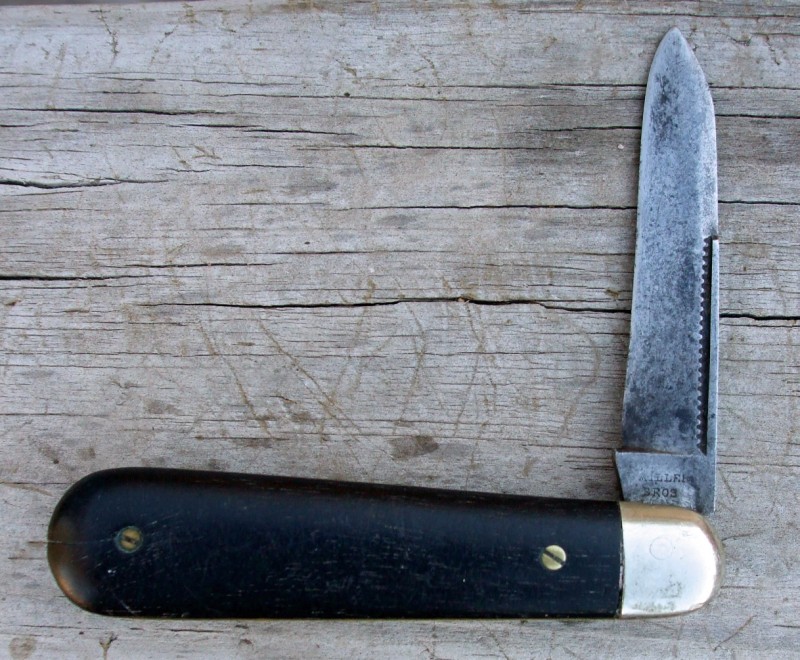

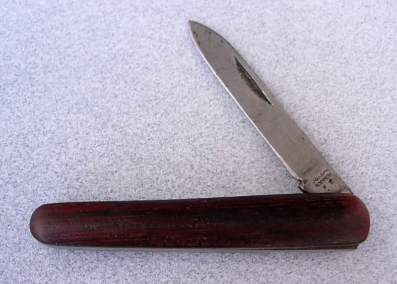

would this be a swell-end or sleeveboard?
Anon that second knife would be a regular jack or swell-end jack depending on who's doing the defining but definitely not a sleeveboard.
The definition becomes blurred at anon's last knife. The rounded ends allow it to be called a sleeveboard, more or less. A regular jack is more often seen with somewhat squared-off bolsters, but SOMETIMES with the rounded ones.
But calling this jack a sleeveboard will mislead someone who can't see it, but is trying to visualize it.
The language isn't black or white, but if understanding is the key (and I hope it is!) Call anon's knife a regular jack, with a rounded bolster if you will,
and reserve the name sleeveboard for a tapered, rounded-end knife, with the master at the big end.
