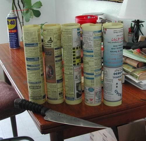

Here's this 13 inch OAL slicer design, the first in my new "Bush Kitchen Series". It's forged from 1/8 inch thin 1095, with a distal taper and full tang construction. The scales are walnut wood, pinned under the wrappings. The wrappings are woven cotton cord, and the entire handle is sealed with 100% natural pinyon rosin. The edge is a bit thicker than your average chef's knife, for added strength,... yet "ludicrously sharp"! It's good for splitting kindling wood and all your kitchen slicing and dicing needs.

Do you think it can make this cut?

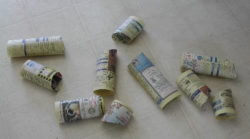

5 rolled tubes of phone book paper with one swoop,... got it on the first try.
wow!!! did you have to stabilise the tubes or not? I have never seen a knife do that!!!
The tubes were free standing. A few of the bottoms stayed standing on the table, but I put them all on the floor for the photo.

Mr Goo,
After I saw your cutting test pic I decided to try a similar cut.
I don't have a phone book so I got an old TV magazine (very thin shiny paper) and made some "tubes". I tried repeatedly but didn't make a single clean cut. The knife I use is as sharp as I can get them. I'm no sharpening wiz but I tried very hard. It makes push cuts through the same paper without any problem. I tried it on a plastic Coca Cola bottle filled with water and made the cut on the first attempt.
I feel that my technique must be wrong, or I attacked the wrong type of paper. When you do the cut, do you hit hard or do you control the cut to "slide" the edge on the paper? I hope my question makes sense :)
I hit it hard like swinging a bat at a baseball. The more of an angle downwards the easier. Try one tube first, and work your way up. As you add tubes you also have to adjust the angle upwards and more straight across,... which makes it even harder.
I've never tried the slick magazine paper. The phone book paper is basically the same as newsprint paper. If you have trouble with that try computer paper. It is a little easier.
I used a black hard Arkansas stone and a cork/paper strop with MAAS crème for the final edge. The angle of the edge is aprox., 25 degrees.
