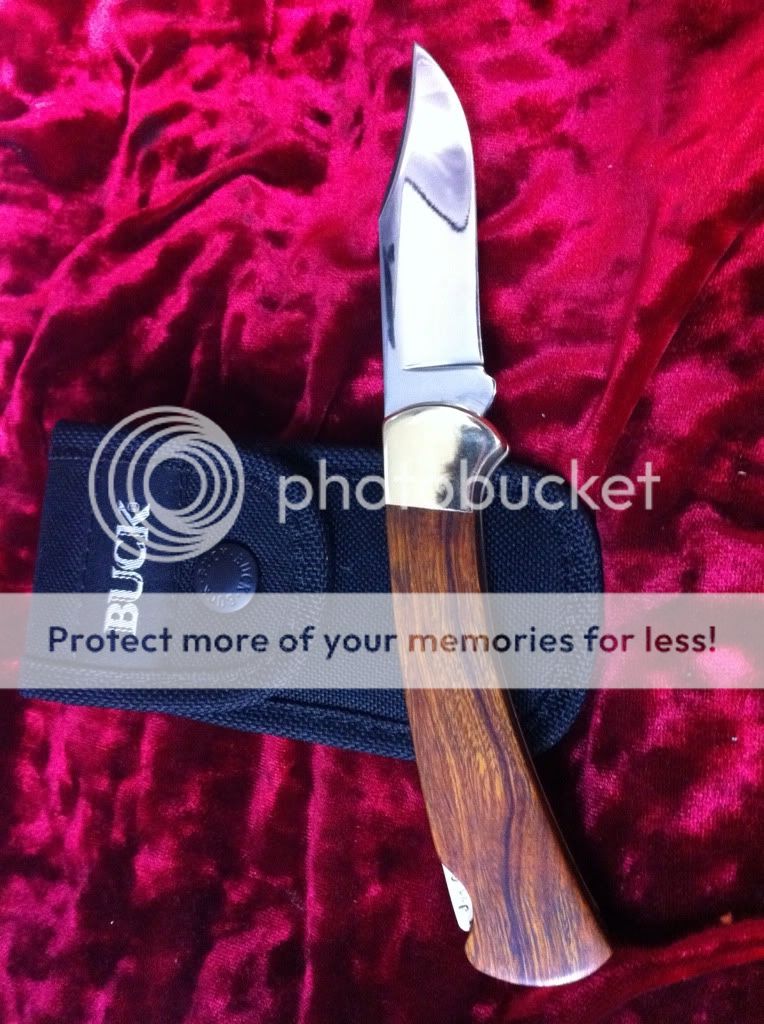

I just recently slimmed a 112 round style not like the old 2 dot. Look at the thread 112 modification i dropped a different blade in also. Took alot of weight off it. But it still dont feel right in your pocket. But it works great in a watch pocket! :)

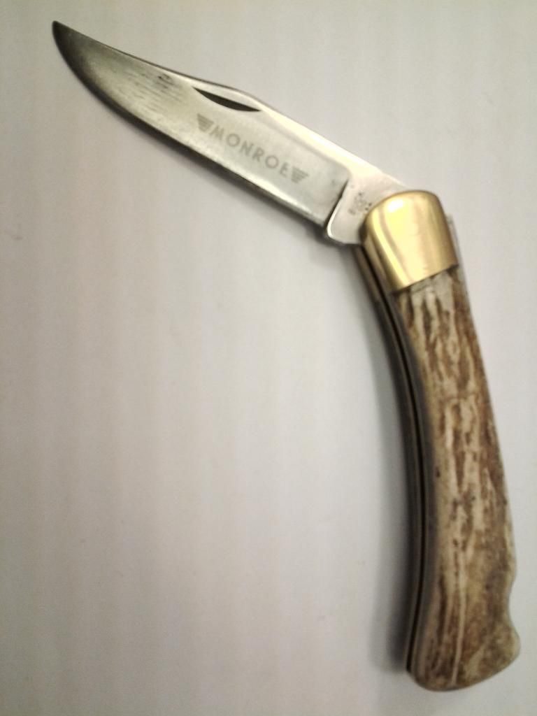

KN nice knife, back to thread might be nice to go with a bare rear bolster, I did that with a 110 and antler, dropped a lot of weight but still bulky could slim more with right material. I might have to try something on that order with a 112 for a pocket carry.
