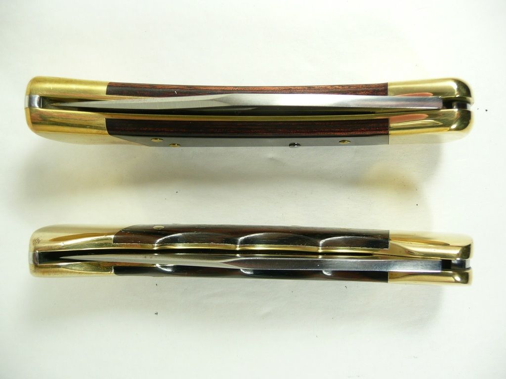

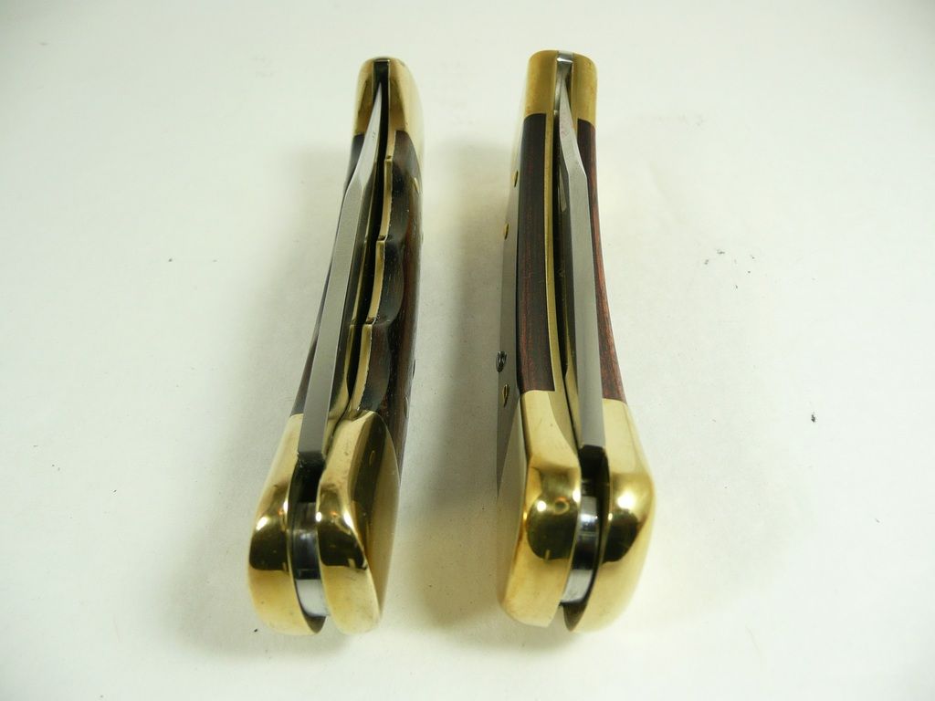

I took the pins out of a 560 Titan, ground 1/32" off the inside of each handle, and reassembled with screw sets. The screw sets are 1/8" diameter barrels with #2X56TPI internal threading plus a #2X56TPI screw for each side of the barrel. The knife was originally 7/16" thick. Now it is 3/8" thick. The older 560's (with the stepped handle edge) were 1/2" thick. The newer 560's (with the chamfered handle edge) were 7/16" thick.

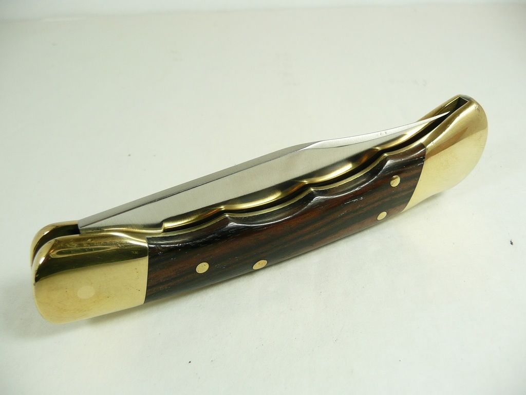

This is a two dot 110 with a factory slimming done for a Buck employee. Thought you might like to see it. The slim weight is 6.5oz. I have no talent to do a modification like this, hope yours turns out good. I really like the feel of this knife.
