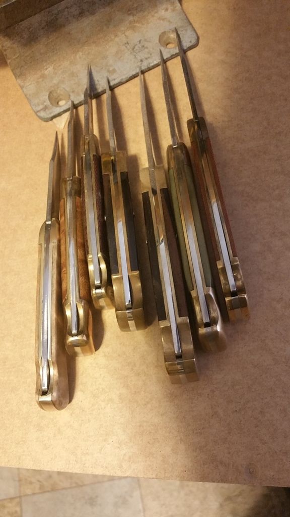

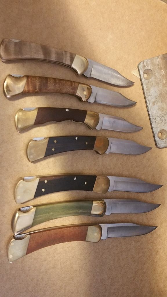

Well Mr. Badhammer, I have several that I have done just for fun, Just because I wondered if I could.
The last is the 112 barehead. Just for fun I cut off the Rear Bolster, reshaped it for the spring spacer. Not sure of the fit so I soldered it to the frame.
Tools? 2 bench sanders, a bench drill press and a bench band saw, files, lots of files, sand paper and a buffer.
I'm not into anything fancy, just having fun.
Dave T
375, Did you take any knives apart (besides the bare head)? It looks like you removed material from the outside of factory knives by sanding or grinding. When I mangle factory knives, I often add pocket clips and thumb studs in addition to removing material to reduce size and weight. Good looking stuff by the way!
Thanks Tiguy, I would say that over half of the time I pull the knife apart. Originally I was leaving the knife held together for ease and fear but now I normally pull them down for cleaning at least. I have trouble peening to a nice head on the scale so I cover them. I have several I would like to put a pocket clip on but have not picked up the screws and taps yet.
I have spinning tools that put heads on pins which project above the scales. I use them for smaller knives. On the Bucks I use screw sets or cap screws and Helicoils.
It is good to have your knife apart when tapping for pocket clip screws.
