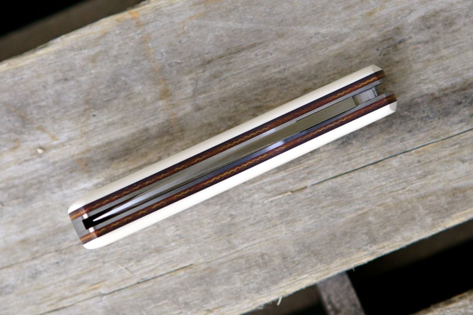

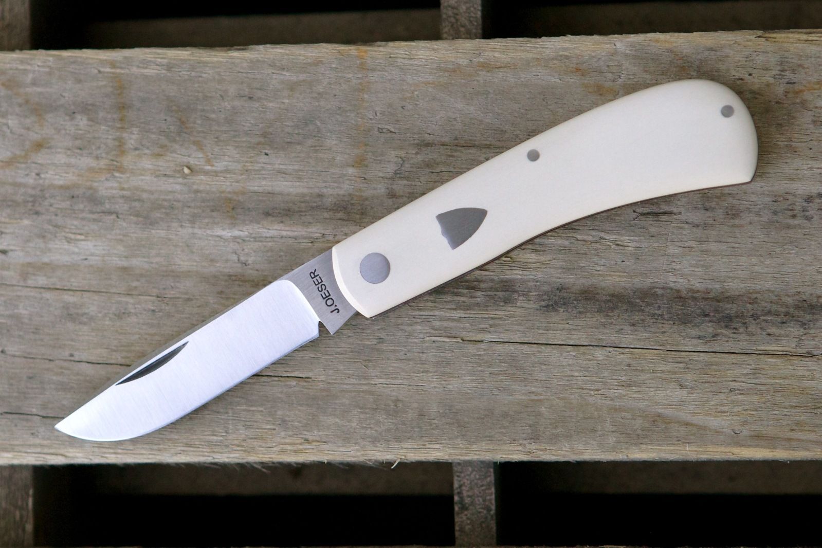

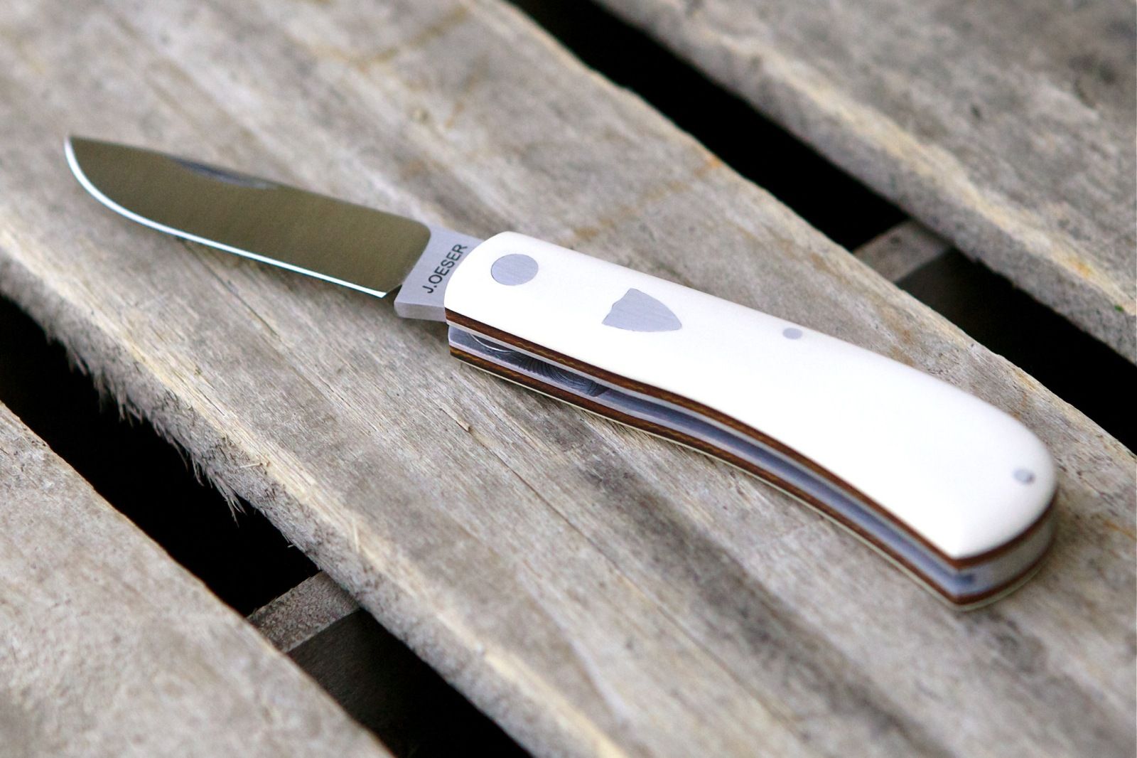

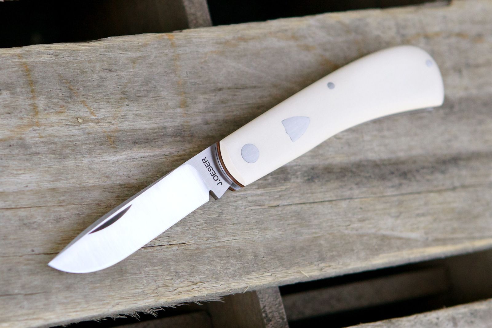

Here is my third attempt at making a slip joint knife. This is also my first one made using my new mill. The nail nick is much more crisp and it has mill relieved liners. This one came together a lot better than the first two and I am really happy with the results. I made this one out of CPM 154 at .105" thick with stainless liners and shield. It has ivory paper micarta over black G-10 over natural canvas micarta on the handles. This is also another first for me. I created this pattern myself using other sodbuster pictures as a guide to shape and size. It measures about 3 5/8" closed. Blade is dead center when closed and it has great walk and talk with no play. Flush in all three positions and about a 7 on pull, easy enough to pinch open.
Any comments welcome and thanks for looking!
