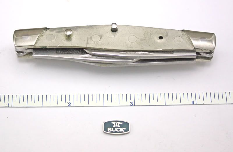

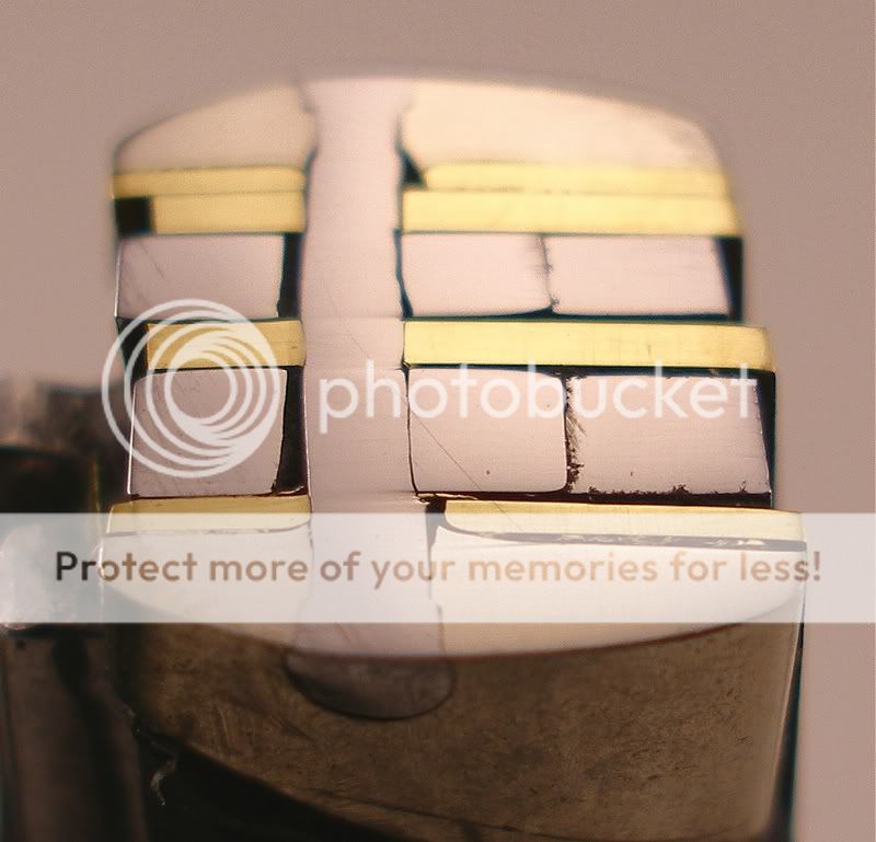

Here is photo of Camillus Buck stockman I sectioned. It's not a scale pin but it does show the swelled ends of a blade pin in the bolster. There should be lot of threads if you do a search showing folks putting on custom scales with pins and/or glue 300
I found a photo of a Buck Dymondwood scaled 303 that I took apart to rescale. It shows the original rounded head scale pin on one end the other pin did not survive 'demo day'. The spring pin is not rounded as much. Custom or factory the process is the same, place scale pins in the liner and peen, or in the case of a factory stamp the end flat. Then place on scale material and round head of scale pin by a spinning press. By hand you have to have your pin at proper length and then if you are good peen the round head or use a rounding stamp with the liner and bottom end of pin on a block. But, what do I know I have only mangled production knives and only tired scale pins once. After that I just used epoxy.
