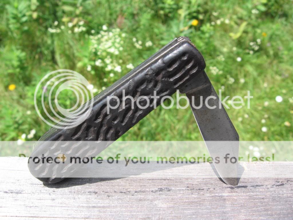

I posted this in the Maintenance, Tinkering and Embellishment forum but I thought I'd share this with you. I have this old Kingston slip joint I found at my great grandpa's house a few months back and I love the knife but the plastic scales really bothered me. So I decided to rescale it.....with leather.
Here it is with the scales popped off

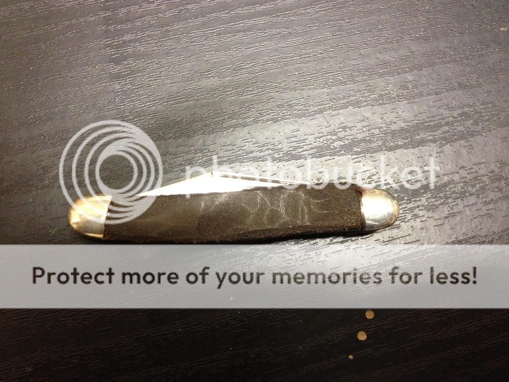

And here is where I'm at tonight. I redyed the leather and then saturated it with superglue for a hard finish. I've done a little sanding but I still need to do some more to smooth it all out. I'm hoping that it will have kind off a buffalo horn look to it
I'm hoping to finish this up tomorrow and share with yall

Wow, finally found someone else who has tried it. That looks really sweet. The super glued definitely hardens then leather up pretty well. I'm going to work on it some more today on my lunch break. I'm excited about this project.

The scale pins on the Case were still there sticking out though the old leather scales were coming off. I used the existing pins as guides and pushed the new leather onto them. Obviously there was no way to peen them, but they helped hold the leather in place for the DUCO cement to do its work. This is also one of the nice things about scaling with leather... its very flexible and forgiving until you harden it.
Well, I think this is about as finished as it's going to get. I put another coat of glue on it and then wet sanded with 220, 600 and 1500 grit sand paper. Then I went to the garage and hit it on the buffing wheel with some green compound and then some red rouge on a soft wheel. Finished up with some mothers mag and aluminum polish. I'm much happier now!
