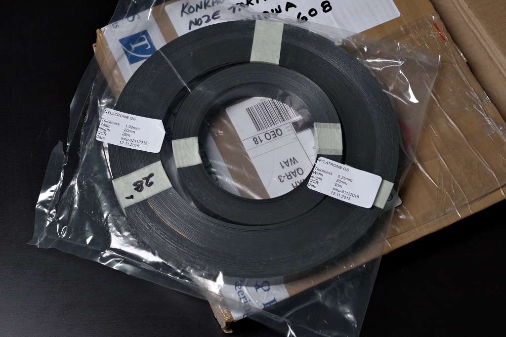

Also I thinking about to use on my slipjoints a Nylatron GS 0,25mm washers.

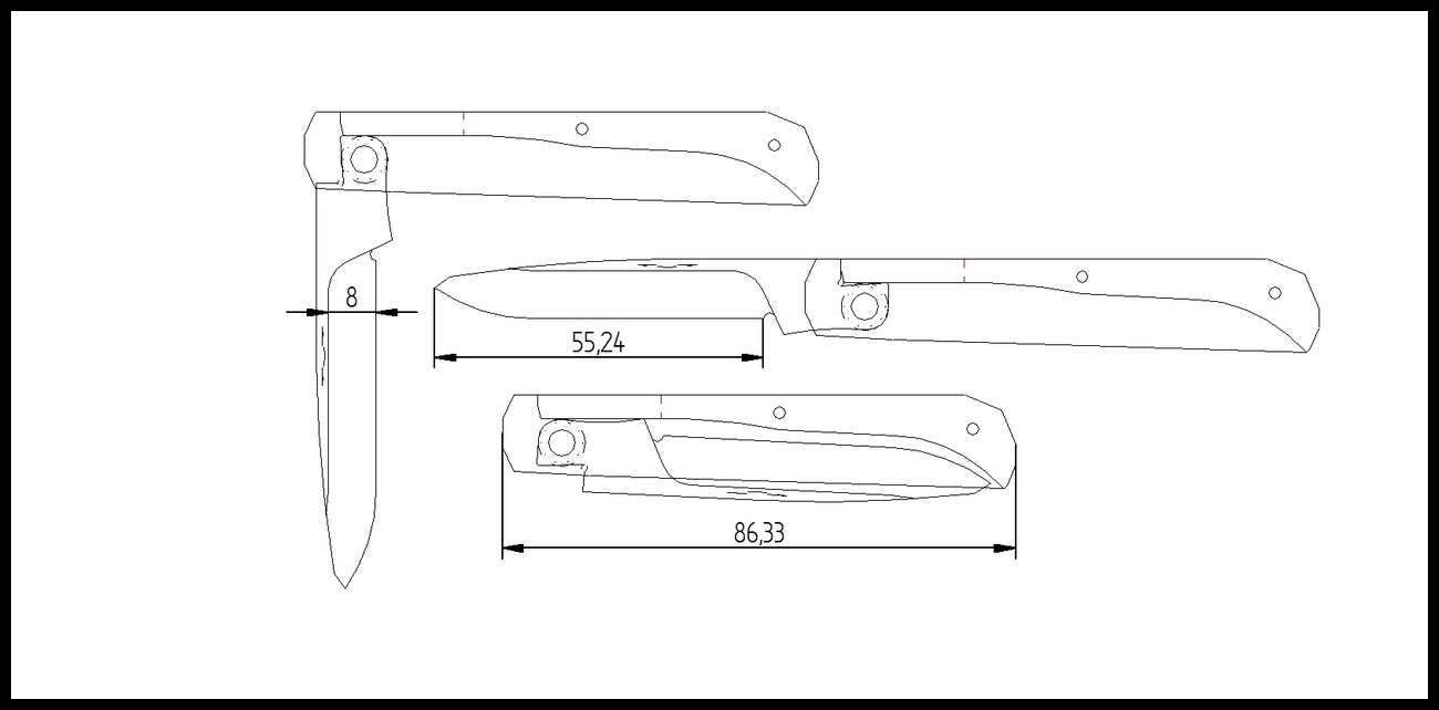

Show us some drawing. Really like your work and attitude so most certainly will buy one of your first batch of slipjoints.

Nylotron GS will be good in liner/frame lock ?
Because I got a nice amount of nylatron...
I ordered 10m x 20mm strips 0,25mm and 1,02mm. And I got 28m of 1,02mm and 30m of 0,25m o.O
Your spring needs to be longer. Also the geometry of the tang when in the closed position is wrong. It will not hold the blade closed very well and will not snap closed at all. Otherwise it looks good.
On the blade, where it contacts the spring, one corner is radiused and one is fairly square. I haven't made that many slipjoints, but found that only a small radius is needed, equal on both corners- maybe one of the more experienced guys will chime in on this one. The totally rounded corner won't keep the blade closed.
Also the back pin i would better center in the handle...it's the pin that keeps the butt closed, against prying the liner apart from the spring's little "tail". You don't want pocket lint catching gaps near the butt and nearing the pin to the center helps
The new design looks much better mechanically but there are two issues that I would be concerned about. First, you don't have much clearance between the tip of your blade and the spring. I suspect it will hit when it snaps closed. And second, it looks like you have some fairly sharp corners in your spring where it goes around the 2mm pin. You'll want to blend those out to minimize your stress risers. If you make that semicircular piece into more of a long smooth lump it will also be much easier to do finish work on.
Texaswade got it right, also remeber the spring stiffness comes from its height, way more than stock thickness.
In this case i'd probably move the center pin backward 4-5mm. Along range spring will help when tuning.
You could always skimm the spring to lessen the stiffness but doing this too much it would bend awkwardly, adding difficult to get flush in the 3 position. Another option is giving only very few preload, but it is not a straightforward method since it is very easy to end too stiff or too soft....too little range to play with.
