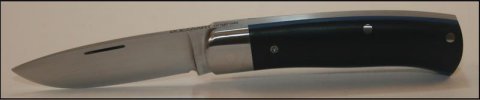

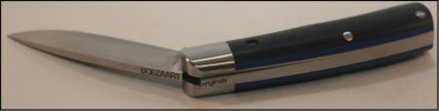

I recently started playing with slippies. I made a few prototypes, and when I was happy with the design, I made three of these. This one has a G10 handle, the other two were stabilized Hawaiian Mango and African Blackwood.
Here are some specs:
Blade: CPM 154 (RC 59 - 61)
Backspring: CPM 154 (RC 46 - 48)
Liners, bolsters and pins: 416 SS
Handle: Blue and black G10
Pull is a nice 5 or 6, and it sits completely flush in all three positions. The blade is 2 7/8" long, 1/8" thick and 3/4 high, OAL is 6 5/8" and closed length is 3 3/4".
Thoughts/comments/questions are always welcomed.
Thanks for looking!
