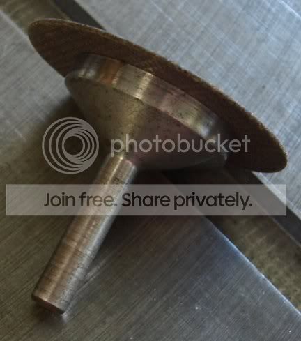

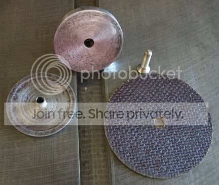

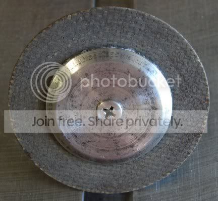

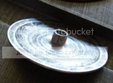

Washard, I use these cut off discs and they don't wear out for along time!
http://stores.fastenerworldllc.com/Detail.bok?no=458
You can buy a mandrel for them or make one if you have access to a metal lathe. I made a mandrel years ago and it still works fine.

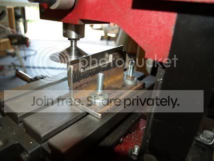

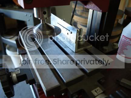

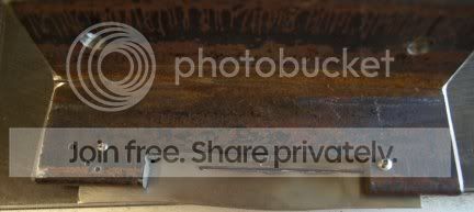

You'll need to have a jig to hold the liner while you cut the lock tab.
You can easily make one like the one I use. It's just a section of angle iron with a notch cut out where the disc cuts the lock tab. Here's a couple pix.
You have to mount a pivot in the right spot and then line the lock tab up so it will be parallel with the base of the angle iron and mark the position of one of the tapped holes in the liner. Then drill a hole in the jig so you can attach the liner to it. If you need any help, shoot me an email or sing out in this thread!!
Here's some pix of my mandrel.
