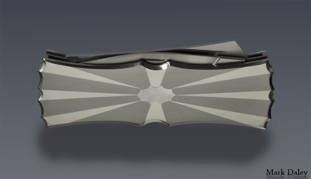

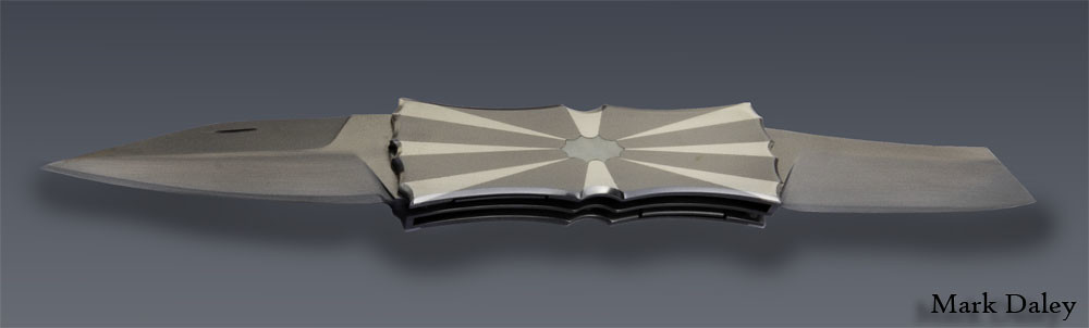

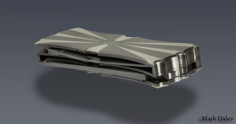

Sliver, steel fancy 2 blade
Scales are silver and mild steel .
Liners are titanium.
Gold lip inlay.
Blades and back spacers are 1095.
Overall length 8 1/16”
Closed length 3 1/16”
Blade length 2 1/2”
Liner lock
The scales of this knife are silver and steel soldered together with gold lip pearl inlays they are then riveted to the liners. The knife can be taken apart by removing a screw inside the liner. I hope you all like it.
I have had a really hard time getting good pictures. I'm not sure i have been successful but here is what i have come up with.

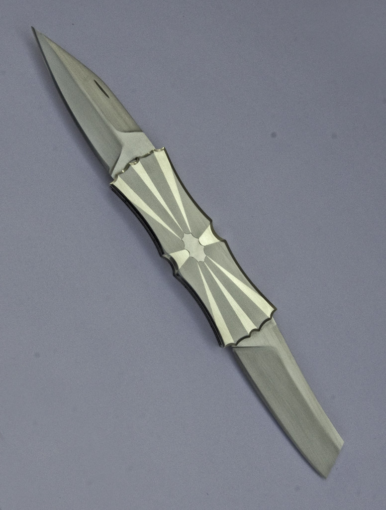

looks like the image is B/W so it is not possible to see the GLP. O/w a very neat little project. also try to run the knife on the diagonal not the horizontal on the background for a more effective image.

I think this might be what you mean. I do like it better. The more I look at my pictures the less I like them. I still need to disassemble this knife to have my name engraved inside the back spacers. When that is done I will give the pictures another try. Thanks again for the suggestion.
