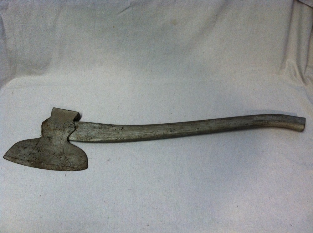

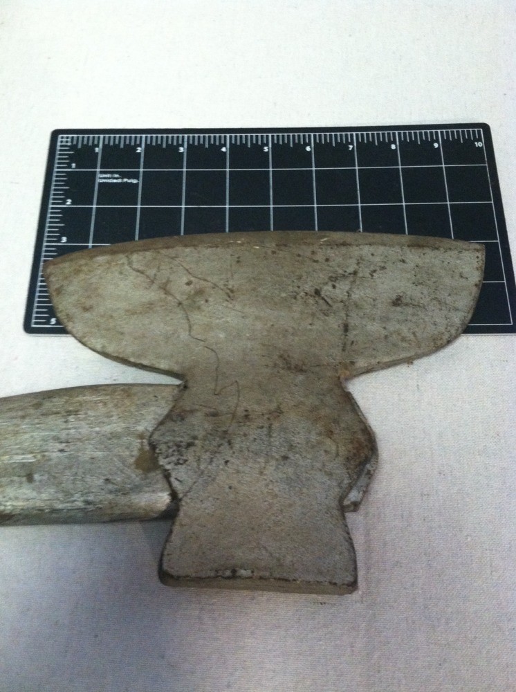

Hello, I'm a brand new member. I'm a woodworker and collect tools. I just recently purchased a broad axe on EBay and I was hoping someone could help me out with the history of it. It is marked SLOCOMB and under that WARRANTED. Searching Slocomb all I can find is J.T. Slocomb manufactured micrometers.

That's a lead and the only one I've got so far. The axe came from Texas, so - ? Maybe an axe maker stamped the stores name on it; warranted was a big deal back then. Thank you for the information. I'll update when I discover more.

So it sounds like a Slocomb axe would be a true antique, with surviving examples appearing only rarely online. Perhaps it would have the greatest value to a Civil War reenactor looking for a real "Confederate brand" from that period?

I absolutely love studying history and collecting old tools and some coins. You are a wealth of information, Mr. Steve Tall. I very much appreciate it. There are also some initials stamped into the axe "C.V.R.". It would be nice if I could date it back between the dates 1822 - 1833. The axe is definitely pre 1867 though by what you've supplied and I've read.

Wow, you're impressive, Mr. Steve Hall. You're definitely more computer literate than I am. And, I'm not a slouch. I'm going to restore the axe and use it. Most likely make a handle a little shorter. I'm 58; used to swing pick axes all day, (still do, rarely) but I'm thinking short strokes now. The railroad connection makes a lot of sense. What made me pull the trigger on this one is the very well made curve in the blade. A talented person made this axe.
Interesting marks. Graphite scribbly?
