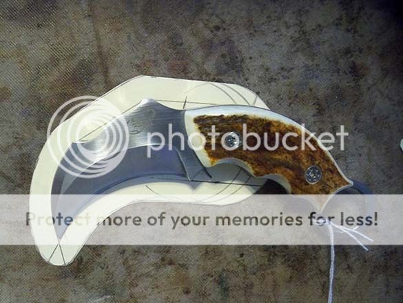

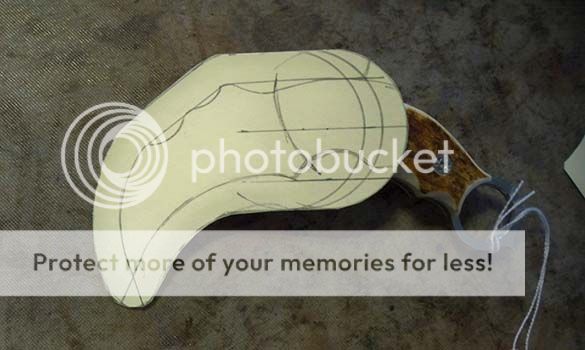

Yeah, well around .25-.50" gap. That's when I'm making a paper pattern. If it's a pouch I lay the spine (edge up) on the center line, then roll the knife over Stohlman style. This is specific to a simple pouch. Obviously the welt must accommodate anything in the handle that would block an easy path. Honestly, I shouldn't have said "specific rules" because it's not exactly accurate. I have my own guidelines that I try to follow, but as with everything else, we all have our way.Strig, you leave a 1/4" between the edge and welt? I dont know if I understand it the way you describe but ......

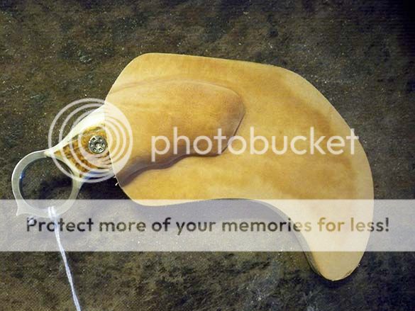

Makes a lot of sense. I decided against snaps on the prototype and tried the rivets I had left over. In your picture the leather seems double folded. Very cool. I will try snaps on the next try, as the knife is just too loose. Might also secure the strap with a snap.
