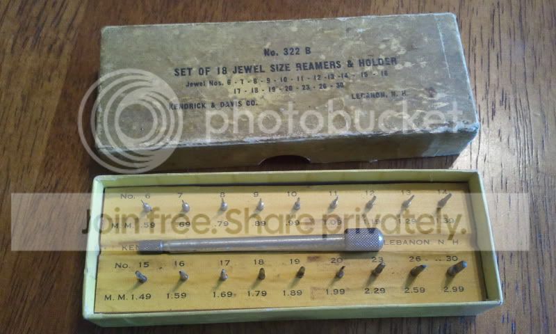

I have a set of tapered reamers designed for jewelery making. My understanding is that you can get tapered reamers in almost any size you want in increments of .0005 or so. Here is my set...
I use mine by hand because they are so small. I found mine second hand, but a quick google for tapered reamers should yield results.

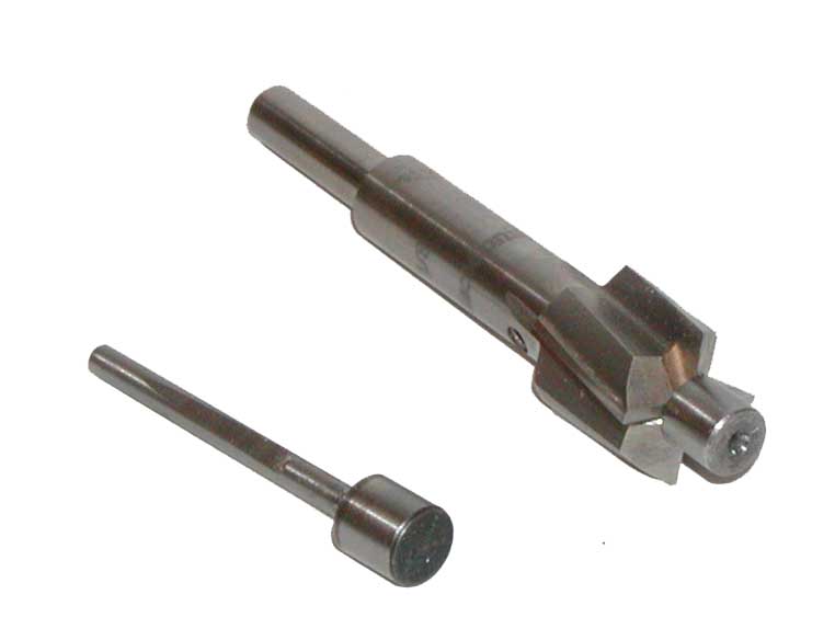

If you wanted to plunge to a blind hole with nice flat bottom, I would use a counterbore.
Drill the small hole first, follow with a counterbore that has a pilot to center the tool.
different sized interchangable pilots are available.

On the subject of reamers, If your drill press runs very true like .001 tir or less, and you are doing a through hole then I would use your drill press. If your Total Indicator Runout (tir) is greater than .001 you can cause what is called bell mouthing that can cause problems, then do it by hand very carefully. If you are trying to make a pocket for your pins I would recommend either a countersink, or as the count pointed out, a counterbore. A reamer is not the right tool for that process.
OK thanks Chuck, I guess I need to be looking for small diameter counterbores then because that is more what I had in mind. I am tired of trying to do it with a drill bit and it catching the material and sucking into it and messing something up. That is basically what I was wanting it for was making a pocket for the pins!nThe only counterbores I have right now are to large for use with pins!
