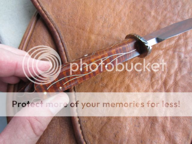

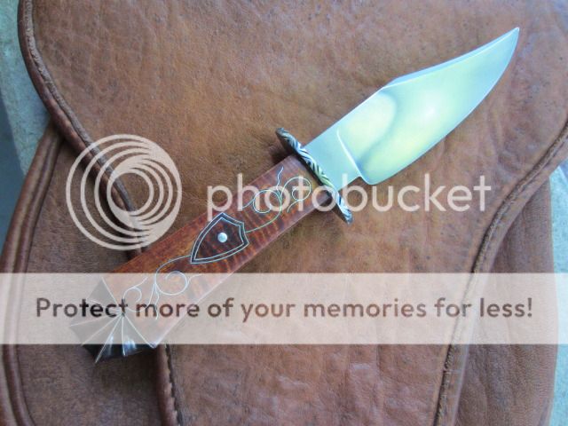

Just finished this knife, I'm keeping it I think!

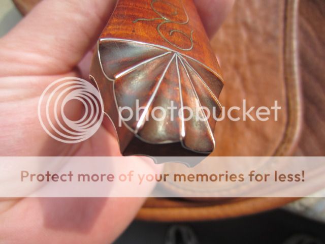

Forged 1084 clay quenched and etched. 4" blade 8 1/8" OAL. File worked mild steel guard. Two tone stained curly maple coffin handle with silver wire and domed silver pin in the shield, and scallop work. Tung oil finish. I will make a fancy pouch sheath for it soon. The background is a Possible's Bag a friend of mine made for me that I will use this season.

Superb small Bowie.... :)
Yes, your handle work and wire inlay is extremely nice and a fitting touch on such a fine knife.
VERY nice work Steve. The work on the pommel is especially nice. The blade looks GREAT too!

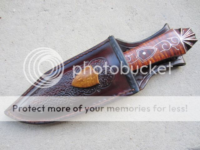

Just finished the sheath, first time making this style. Basswood lined, 8-9 oz leather with some tooling with a stained whitetail antler shield.
