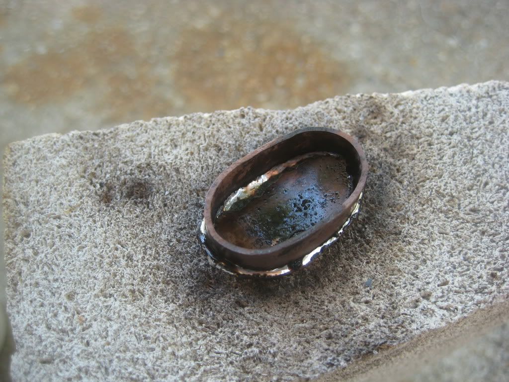

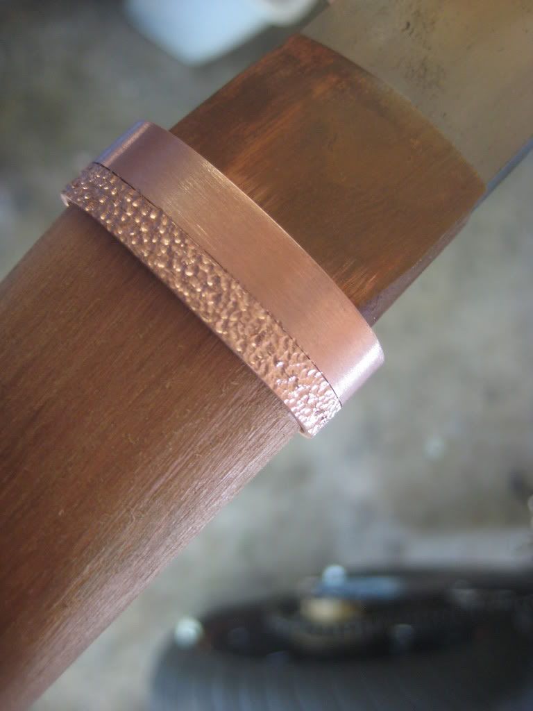

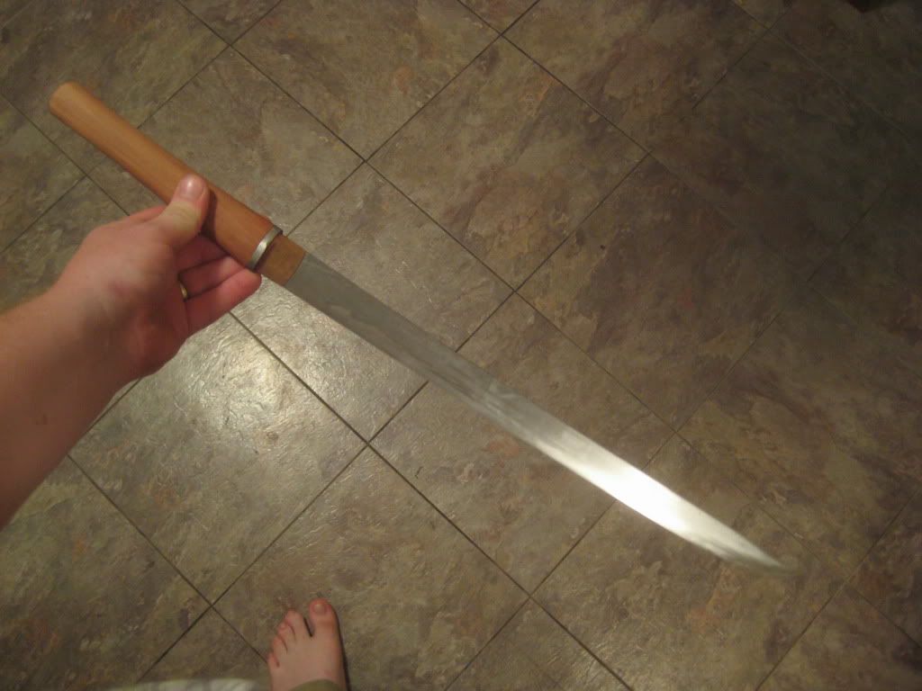

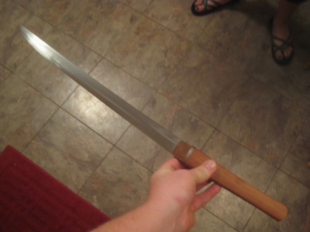

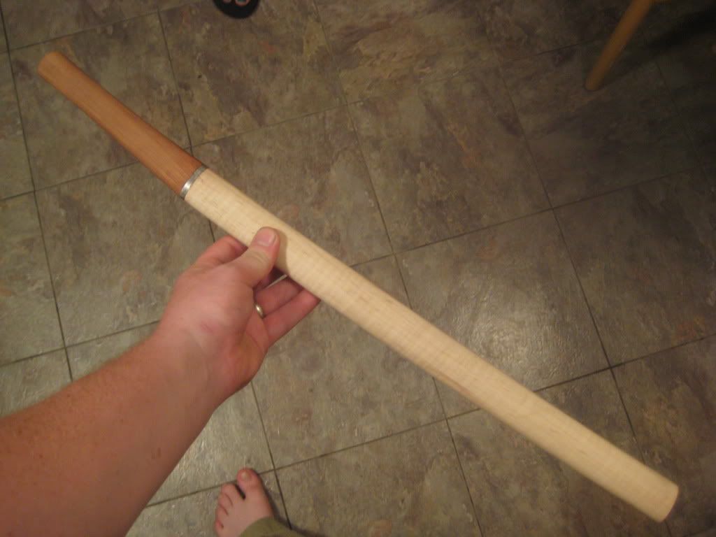

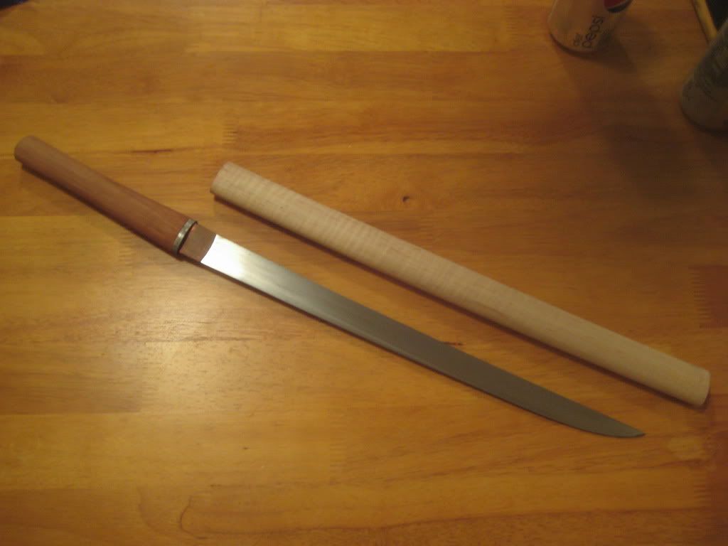

been a while since i did anything big. and this blade as been almost finished for a long time, and been collecting dust. so i thought i would pull it out and finish it up.
it is a san mai blade with cable damascus on either side of 1095. The blade is aggressively distal tapered which makes is lighting fast and light in the hand. it is a slim package;a small wakizashi. Kind of a macho tanto or a girly wak. The fittings are all copper and old wrought iron. it will be getting a light colored silk wrap to go with the tiger maple saya. i haven't fully polished the blade yet but it should have a very interesting hamon.
here it is as it was when i got it off the shelf
making fittings:

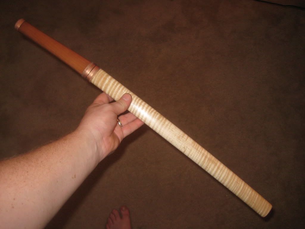

and where we stand now:
i would really appreciate your opinions.
thanks
~chris
Hey Chris,
Good to have you back. It seems that this is going to be another awesome blade coming from your shop. I like that Slate too :)
Looking good!
Some details:
1) I think the size is great — I've always been a fan of smaller wakizashi.

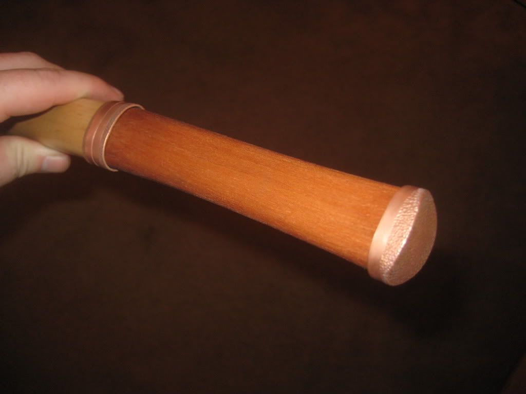

2) The hammering on the kashira and fuchi are really classy. A minor point, though: The fuchi is hammered on the ito side, whereas the kashira is the opposite. I think it would give the handle a better symmetry if they were either both hammered on the inside or both hammered on the outside.
3) The metal koiguchi is really ballsy, and I bet it makes a great sound when you sheath it! Would it run the risk of damaging the edge, though?
I can't wait to see it when it's polished!

1. i also am a fan of small swords, plus.. it is able as big as i can heat treat in me forge so it works out for me!
2. I will have to get some pictures of the parts, but the fuchi is actually a copper band soldered to a wrought iron "tsuba" incorporating the two parts into one, and the fuchi/tsuba hammering mirrors the Koiguchi on the saya, where the hammering is on the same side of the fuchi and kashira. i may end up "hammering" the whole kashira, especially since it is small and will be partially covered by the ito.
3. the Koiguichi is just a band around the throat of the saya the actual mating surface is wood all the way around. the saya is kind of thin around the habaki because of how slim it is, and i wanted some added strength there. i also stippled the back of the habaki to match everything, but again you cant see it in the pictures too well.
i am currently making some really simple using knives for a hunters function a friend is putting on so this is taking the back burner till i get those done, but after Tuesday i will be working on this baby again.
thanks for the feedback!
i used Jesus Hernandez's tutorial on his website for the habaki. everything else was just trial and error.
