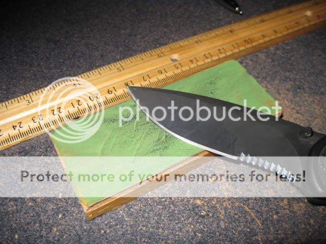

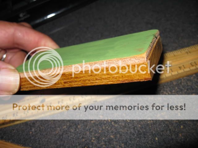

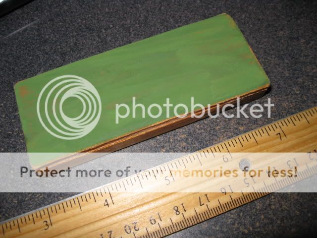

I whipped this one up in about 10 minutes this morning using a scrap of leather and Osage Orange.
It measures 4 x 1-1/2....works great on smaller blades up to about 4".
Taking a tip from someone on another forum, I sanded the leather to a nice velvetty surface prior to loading the compound. Then heated it a little by holding a lighter under it......the compound then seems to melt into the leather a little.
Works great.;)

This is very similar to the strops I've made for myself. They're sized so that I can 'freehand' strop (about 5-1/2" x 2-1/2", on 1/2" thick oak), holding the block in my left hand while stropping the blade with my right. They're even just big enough to handle my kitchen knives too.
I also have discovered the benefits of sanding the leather just a little bit, to give it that nice 'nap'. It holds the compound very nicely this way. After using it for a while, the green strop has become a bit 'shiny' and VERY GRIPPY on the knife edge, and this is working out very well. I think it's actually improved in performance with use. I also use the sanded leather on my bare strop for finishing up. Been very pleased with both of 'em.
