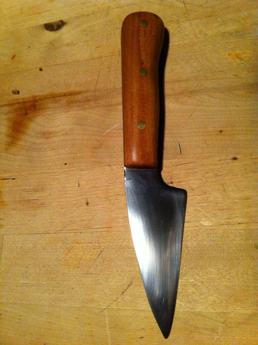

Making a small kitchen knife for my mom and I've got the profile roughed out.
Looking at the handle and I am kind of torn between a bump or heel on the end of the tang or thinning it out?
What do you guys think?
Untitled by rlibson, on Flickr
First of all, I love the design. as far as the heel goes, I would do it depending on the size of her hand. If her hand fits inside, it will probably be pretty nice. If her hand is too large and ends up traveling onto the heel, then it is going to be uncomfortable. I have chef knife that I absolutely love but is uncomfortable becuase my hand is too big to fit between the blade and the heel easily. With a paring knife like that, though, you are almost always doing pushcuts, and so I wouldn't worry too much about needing a heel. That is just from my experiences.
it fits my hand so...I'd bring it over for a fitting but it's a Hanukkah gift, so I'm cutting it a little close.
That's a good question not sure...cherry maybe? Its got a nice little pearlescent thing going on though. Both the handle are finished to 800. The handles finished with tru-oil the blade will get some sort of food safe wax rub after I take it to the 1x30 and bring itto the stones for the final edge.
The next one will be better- I nicked the blade spine with the grinder near the handle when I was contouring it post epoxy. Can't seem to get to full slab completion before epoxy. Even though I looks good at the time, when I glue em up I always seem to want to take more off.
Thanks for the compliments.

That's a sweet little knife, it will get a lot of use. The color on the wood is excellent. It looks like cherry to me too.
I do 85% of my handle shaping AFTER everything is glued up.
Only the rough cutting needs to be done before glue AND the front faces of the handles must be finished before glue (unless you're a masochist).
Shape the handles down to the spine, then sand them all together to get them mated.
I just use files to do most shaping. They remove material aggressively, but not fast, and don't cause overheating problems. Then sandpaper.

I use a granite surface plate and some 60 grit sandpaper to make sure everything is dead flat, takes only a few minutes. You could also use glass. That said I do have a disc grinder but I find this method just as easy.
I tried that method and I am sure that it could work with enough patience but cutting my slabs with a miter saw leaves them pretty uneven.
To cheat on this one I just cut one slab off of both ends that had been trued up with a joiner/planer by my furniture making buddy, then I used the uneven cuts on the outside.
Do you have a grinder with a platen? you could roughly flatten it on the platen and then use a granite block to finish it out. Just an idea, but that's what I do.

I recommend a 9" disc. It can use standard size 9"x11" sheets of sandpaper. And yes, they really get stuff flat.
Make sure you still flatten on a granite surface or something similar after that. The jointer makes little dips in the wood. A drum sander is really the answer for this job.
