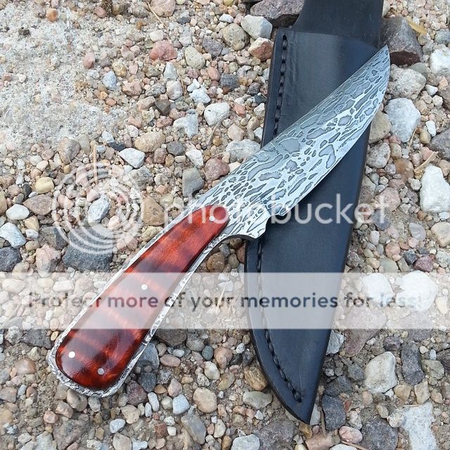

J jonwelder Joined May 12, 2015 Messages 14 Jul 16, 2015 #1 Here is another bearing knife I made, this one a little smaller and full tang, again I dyed the curly maple..
LX_Emergency Joined Jun 28, 2007 Messages 3,215 Jul 17, 2015 #3 That's very nice! Ball Bearing damascus?
J jonwelder Joined May 12, 2015 Messages 14 Jul 17, 2015 #4 Damascus-? You be the judge on the term.. I made it by the canned steel method, 3/32" bearings--- forge down to weld, then grind away the can.
