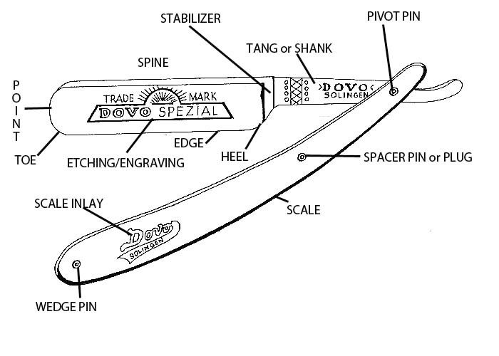

I think we have a problem in communicating what is meant by shouldered and shoulderless razors. This may help http://straightrazorplace.com/srpwiki/index.php/The_straight_razor#Shoulder_styles . A shouldered blade will have one or two stabilizers. I do have full hollow ground razors that are shoulderless.
When you say wedges do you mean you can lay a straight edge from spine to bevel and see no light between the straight edge and blade face? There is no concavity to the blade at all?
Looking forward to seeing photos later in the week so I can actually see what you mean.
Bob
Yes, by wedge I mean FFG on a flat disk and lapped on lapping film and surface plate and by near wedge I mean ground on a radiused platen at either 72, 48, 36, or 12 wheel. When I say shoulder, I'm referring to the plunge area where the blade and shank meet. Though its not part of the blade, I still consider it a shoulder. In regards to shoulderless, the transition point is ground with a swept plunge to avoid any area that could interfere with honing.

Now more questions as I know nothing of the technical part of creating a blade. What is FFG on a flat disk, Flat Fing Ground? If that forms a true wedge then honing it in a traditional manner would mean the entire side of the blade forms the bevel, no? Would not mind seeing a toe on shot of one of your wedge grind. By shank I take it you mean tang.
Bob
FFG is Full Flat Ground/Grind. Its true that it IS a chore to sharpen a true wedge due to having to flatten the whole bevel but most use a few pieces of tape along the spine to sharpen it. Yes, shank, tang, and shaft are all used interchangeably.
