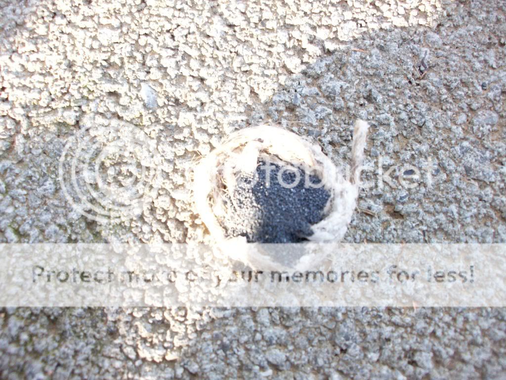

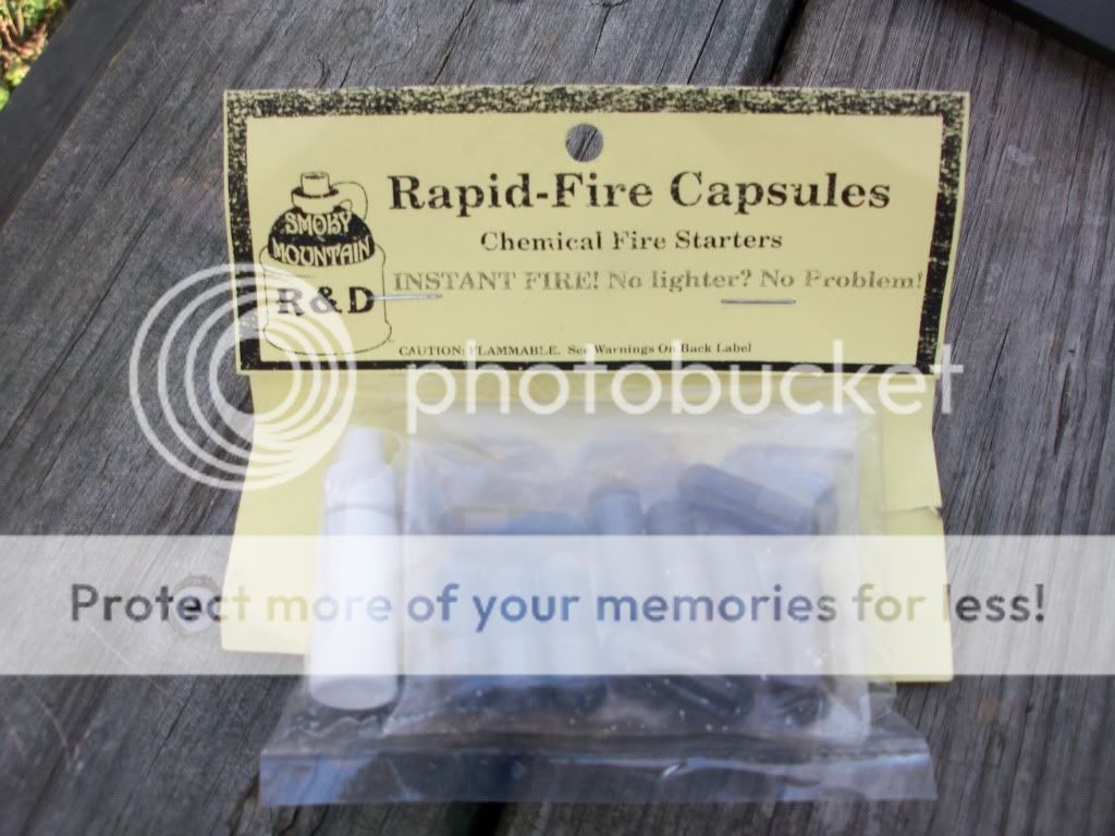

The kit contains 10 capsules of PP, 10 waxed jute "nests" and a small bottle of glycerin. Instructions are on the back. Basically, place nest in a safe area, pour PP onto the nest, in the center. Stack tinder around it, put 6-7 drops on the PP and wait. Keep away from children.

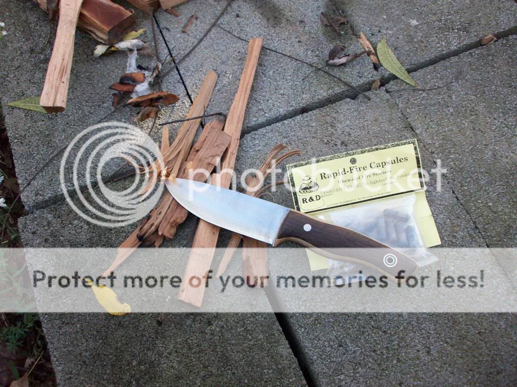

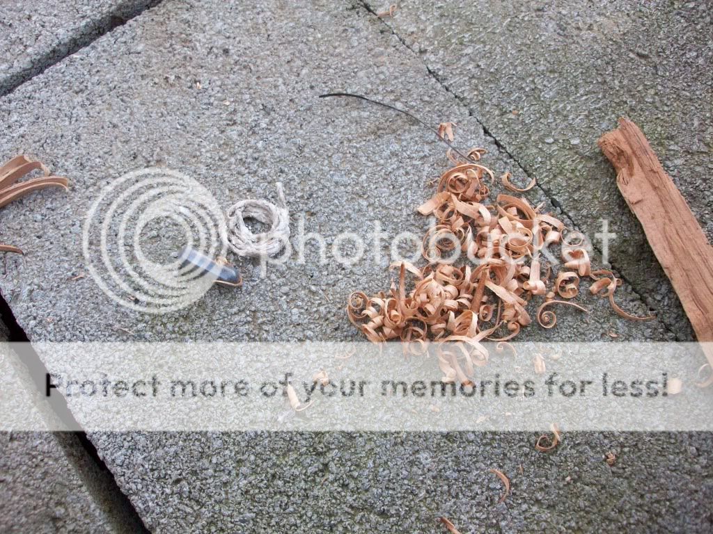

Lets get too the FIRE!! I grabbed up some Red Oak that has been outside for the last 3 days in a TORRENTIAL DOWNPOUR. Seriously, 3 days of heavy rain. I used my Fiddleback Hunter to whittle some shavings, and grabbed some of the more damp pieces to place on the pile.
I set out 1 nest, 1 capsule, and the drip bottle. The nest works well for keeping the PP contained and the wind from blowing it around.

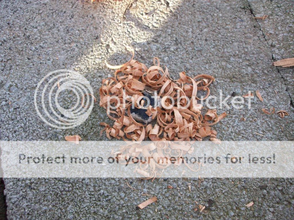

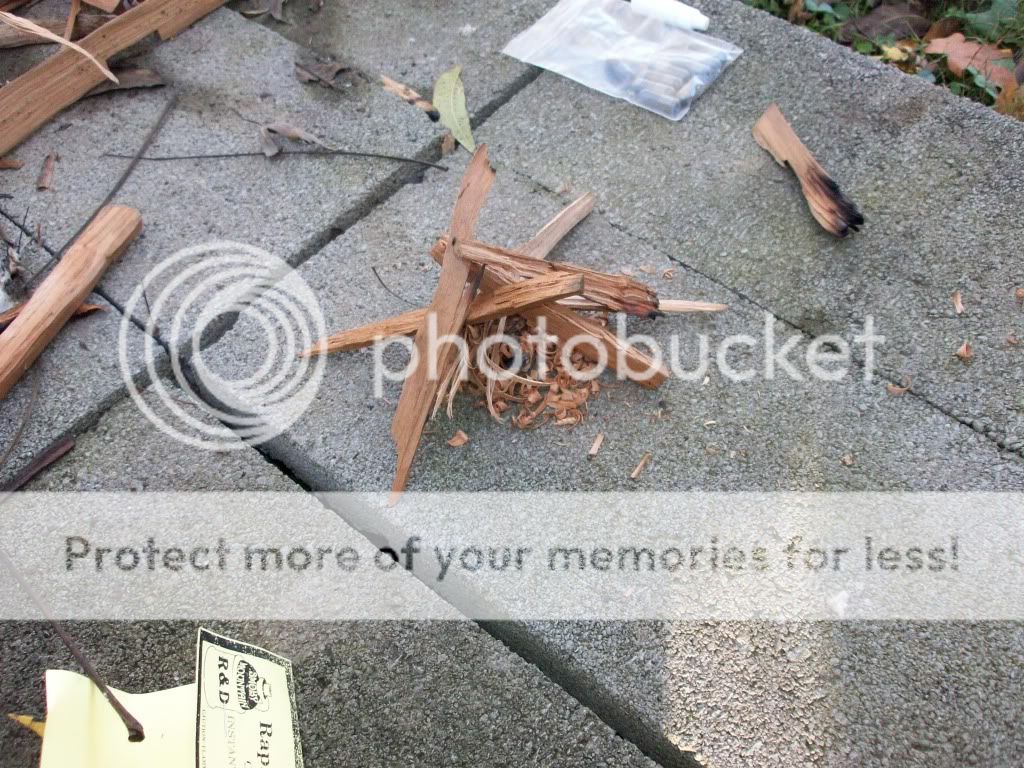

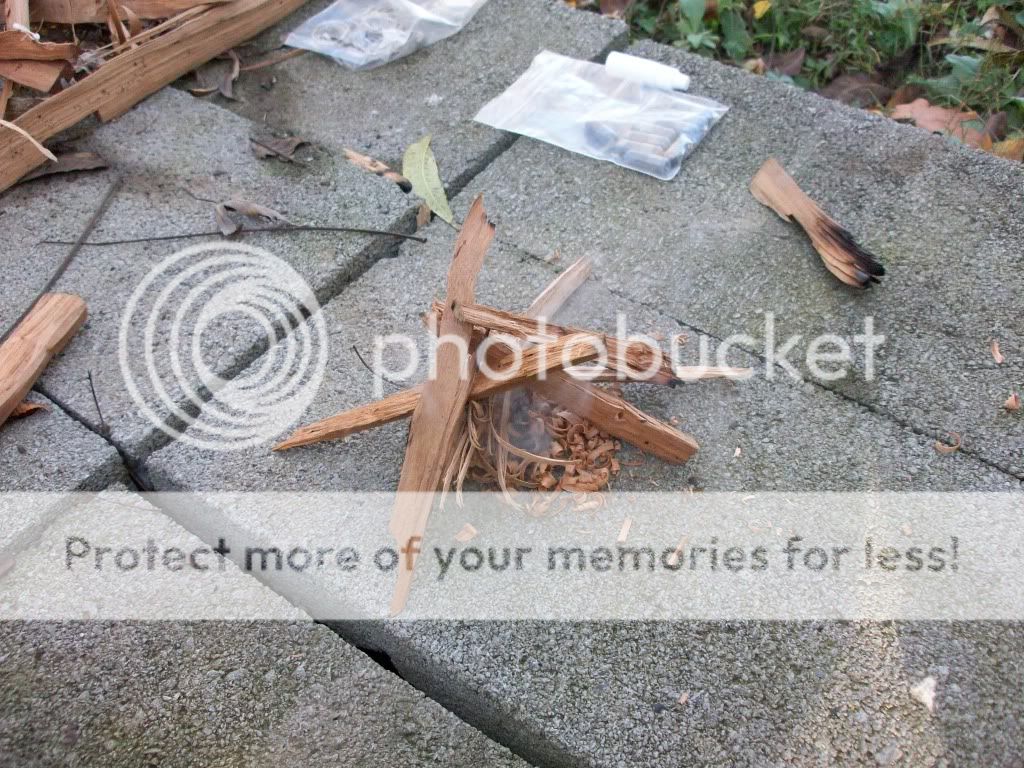

I piled my shavings on, and set 6 drips right on top of the pile. It kinda turned to gel and sat there. I have never done this before, so, I didn't know what to expect. I hurried to get all my stuff on the pyre. Yeah, the reaction takes about 2 full minutes, so, don't get in a big hurry, you got time to build the whole stack before it goes

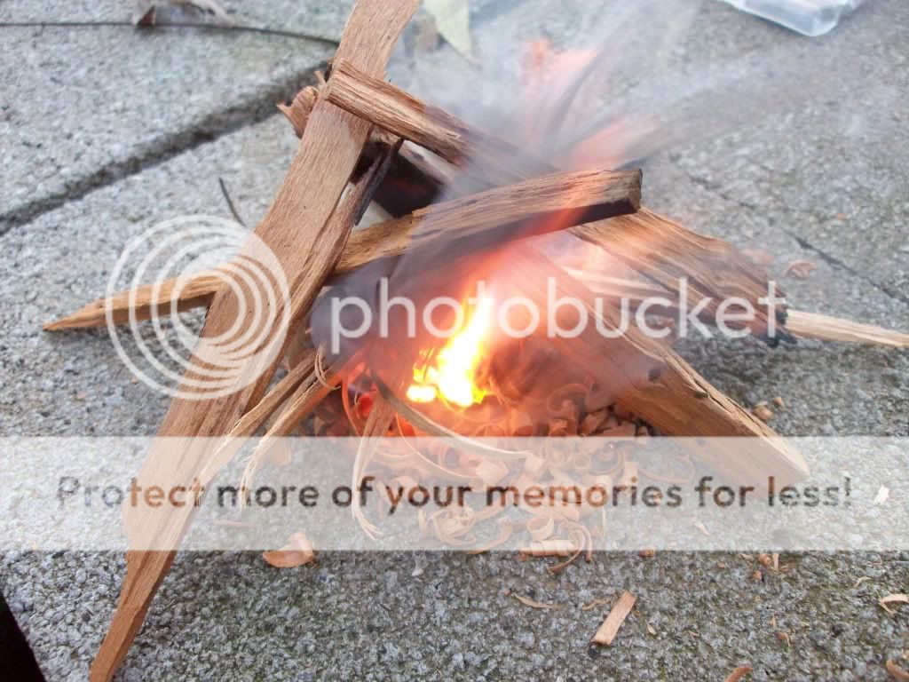

After 2 minutes, there was just a little wisp of smoke, and I thought "Slow burn, cool". Yeah, right.

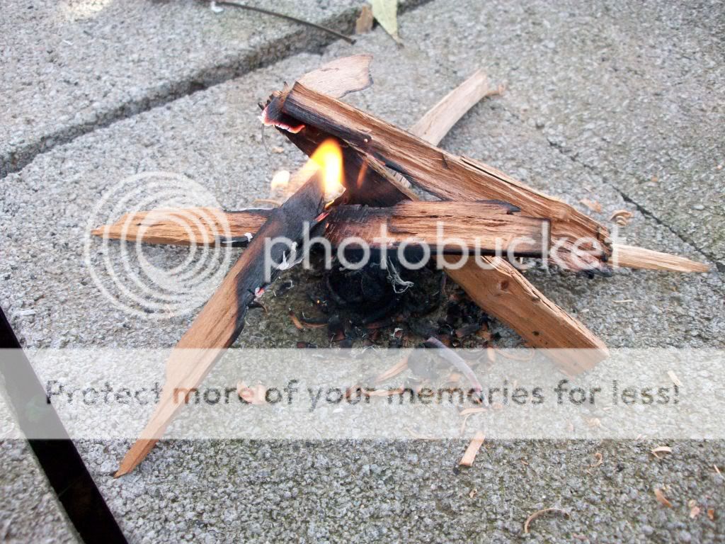

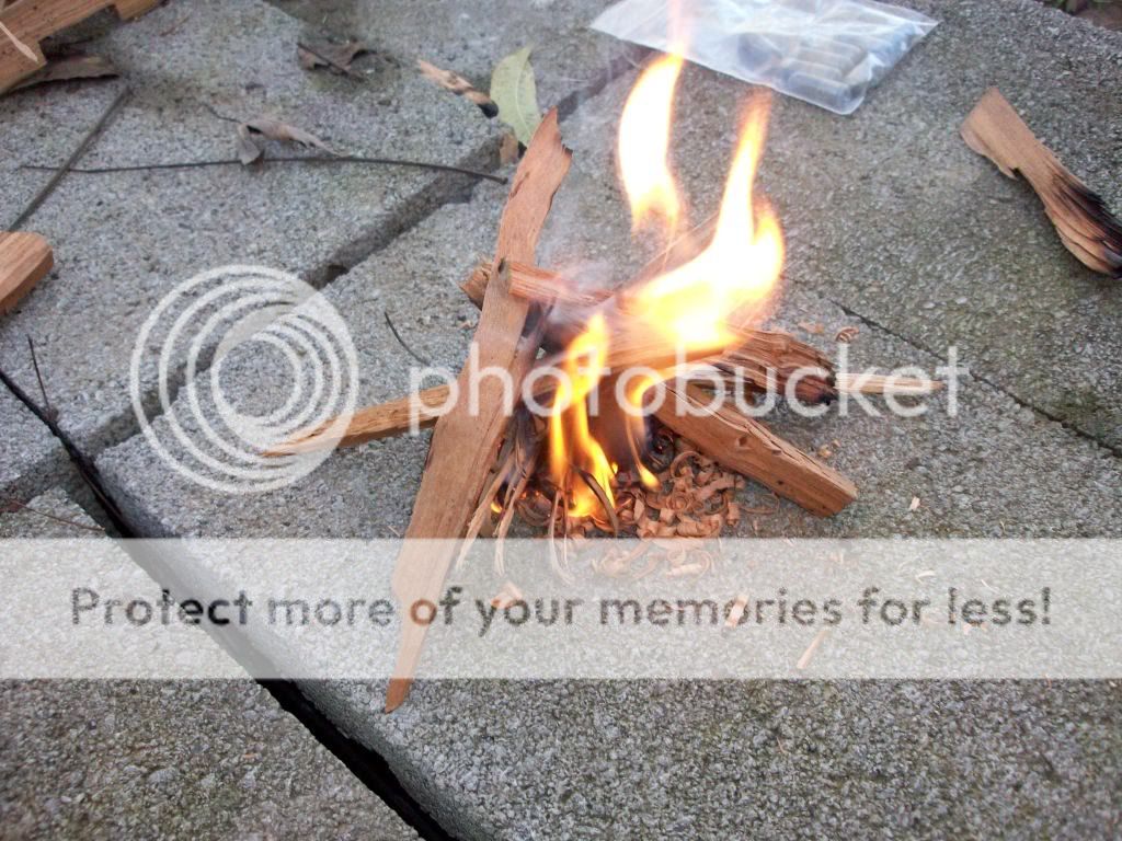

From tiny wisp of smoke to blaze up, about 3 sec. The heat was intense. I don't mean like, housefire intense, but this thing was burning a pile the size of a quarter.

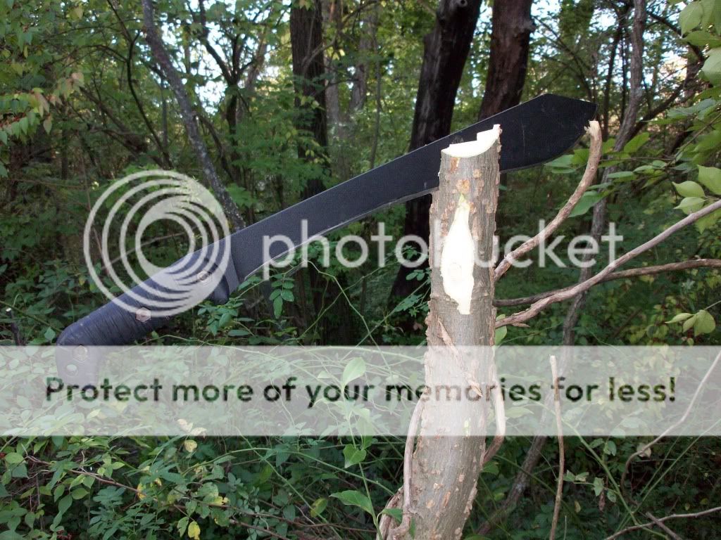

Solid fire starter. I kinda neglected it, 'cause I got a BK Patrol Machete in the mail today (thanks OwenM, I owes ya) and ran off to chop stuff. When I got back the damp wood was burning and all the wood shavings were tiny coals, easy to bring a fire to life from that.
Knif Pron, my new 'chete.
