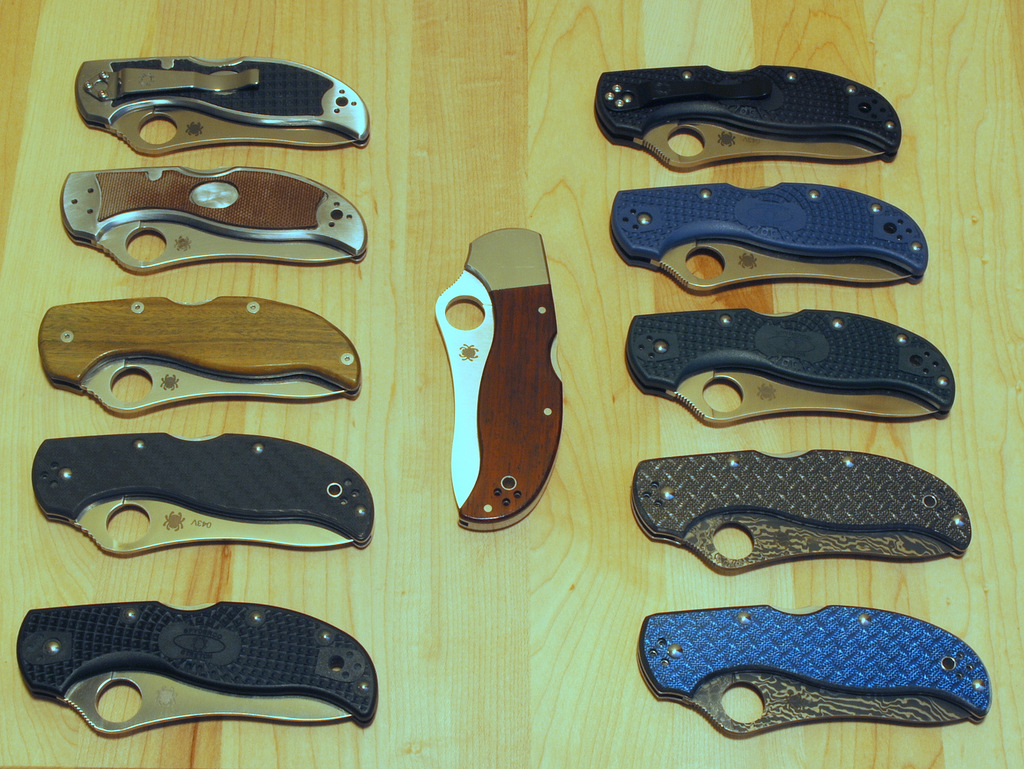

Very nice Deacon. What is the inlay on the model second from the top on the left? Micarta and pearl? Also, I want that CF sprint ;)
The inlay is brown canvas Micarta, the oval in the middle is just the SS "landing pad" for the clip that's part of the original Stretch's handle.
