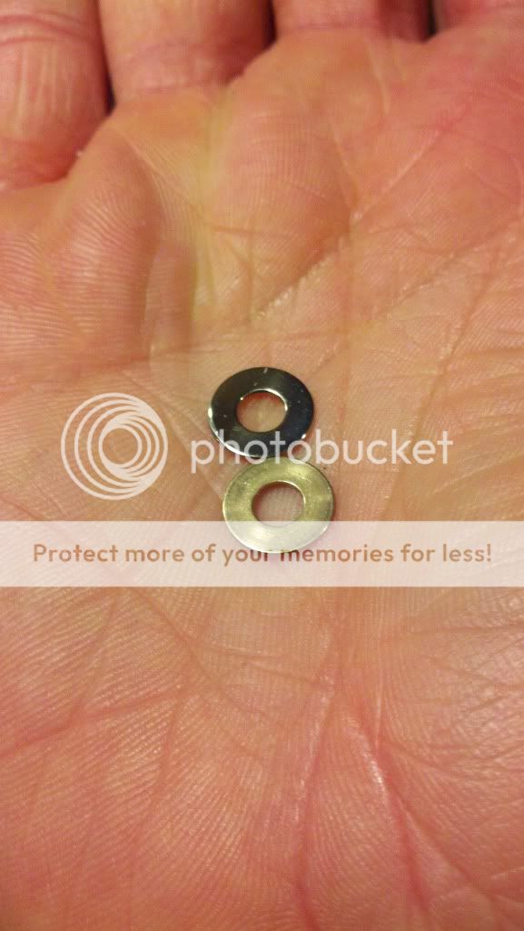

So I got my dad a spyderco sage 1 for father's day. I thought I would carry it for awhile and just flip it open and closed to break it in a little.
Well it's still not smooth. So I took it apart and polished all the mating surfaces.
(here's a good before and after)
The washers, lock bar, liner lock, blade tang, liner. Still, it is not as smooth as I was hoping.
Any suggestions?

Nano oil is also pretty awesome. Sometimes you do more harm than good with polishing if you don't lube it back up afterwards.
I hope didn't harm anything. I thought the worst thing that could happen is pinching the washers. I ordered some quick release, though.
I'm sure it's fine, I didn't mean you would actually damage the washers, just that you're removing all the lube from the system when you polish everything then you need to make sure to lube it up again afterwards :)

If you do a little searching on BF, you'll find lots of threads about lubrication. WD-40 isn't meant for lubrication - the "WD" stands for water displacement. WD-40 tends to evaporate quickly. Sounds like you are on the right track with quick release. Nano oil is my lube of choice - and there are lots of other good ones out there.
As far as polishing the washers/liners goes, I would urge caution. While this seems like a good idea many times, if you remove a little too much through polishing, it can affect the tolerances when you reassemble. I'm not saying not to do it - this can improve performance substantially - just be gentle so you don't bend the washers and don't remove much metal. :)

Good point! If you watch the youtube videos of CRK shop tour, it shows a guy at the end checking the fit of a Sebenza. If the blade has any play or isn't centered, he'll polish the washers just a bit and keep checking until its dang near perfect.

I've mirror polished tang/washers/liners before, tension on the pivot becomes a very light touch to go from loose to nearly locked up, by all means lube it up, but spend time getting the tightness perfect.

It's still not perfect. If I loosen the pivot screw the liner lock pushes the blade waaay off to center. I guess I got it the best it can be.
I figured it out! Under 30x magnification the detent ball on the liner lock wasn't perfectly round! With some careful sanding and polishing it is now much better.

how did you sand such a small ball bearing? i have a good supply of tiny ball bearings. if you had a micrometer or access to one so you could have measured it, i could have sent you one when i shipped out your knives yesterday.
I contacted spyderco and they told me it wasn't a moving part. It is just a fixed nub that the blade rides on. I put a piece of 600 grit sandpaper on the edge of a piece of granite and slowly went to work. After careful inspection it is much more round than it came from the factory. A little polish on the slotted wheel, then a dremel with xfine compound got it really slick!
