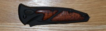

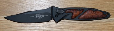

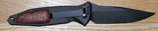

I changed the scales of this SOCOM. I think the snake wood looks much better.
However, this is my first time doing such thing (even the first time to use a dremel), the fit of the pieces wasn't that great. Should I use something to fill the gaps?

Looks good. Snakewood is fun to work with and it looks great.
I wouldn't bother filling the gaps. It would probably just look funny. Did the old inserts come out in one piece? If so, you could have glued them to your wood (with a small drop of CA) and used them as a template. If not, it was just going to be difficult, and you did well.
I could be the photos, but it looks like you could get more polish out of that wood. I keep getting improvement up through 8000-grit (1-micron) on snakewood. I use 3M finishing paper for this. You can almost see yourself in the reflection.

Actually, I'd say "be critical", and improve with everything you do. Just don't get hung up on it. I've never made anything that was flawless. If you think you did a perfect job, you aren't looking close enough.
That looks great. I hope you used stabilized snakewood, though; it has a nasty habit of cracking otherwise.
Thanks all for encouraging a newbie.
I know a need to do a lot better on the fit and making the wood pattern consistent in direction.
I'll leave this one as it for now and keep it as a memory of my first knife modding.
The snakewood is not stablized, but I "boiled" it in wax.
The big thing seems to be to season it properly and don't use thick pieces. I've never had a single piece of snakewood crack. Most nightmare stories seem to come from hidden tang-handles.
I've heard that the figuring causes stress in the wood and that less-figured material is much more stable (in the sense of spontaneous cracking). That is one of the reasons low-figure snakewood is so popular in violin bows. If that's the case, Jin Guo should be fine. He used the spotty, lower-figure material.
Phillip
(If you do ever end up with a crack, seal it up with a drop of thin CA adhesive. Works great for sealing fractures in wood.)
