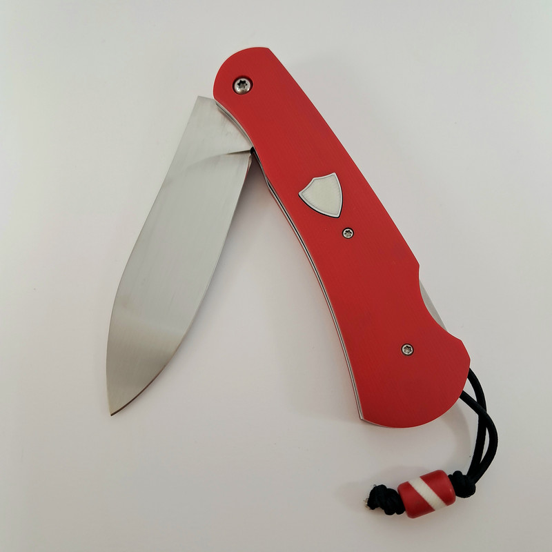

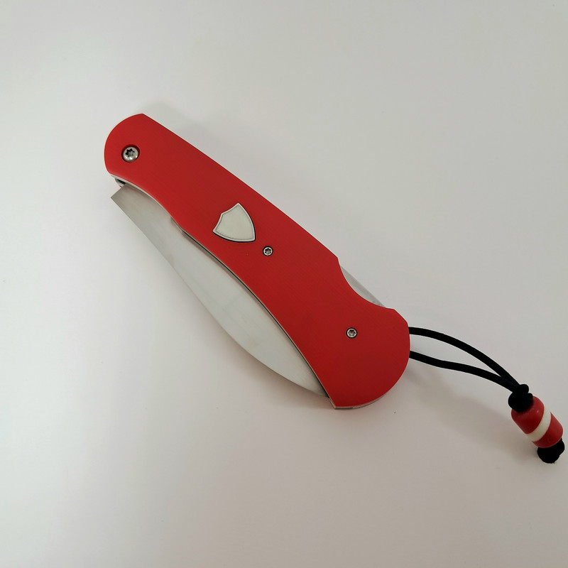

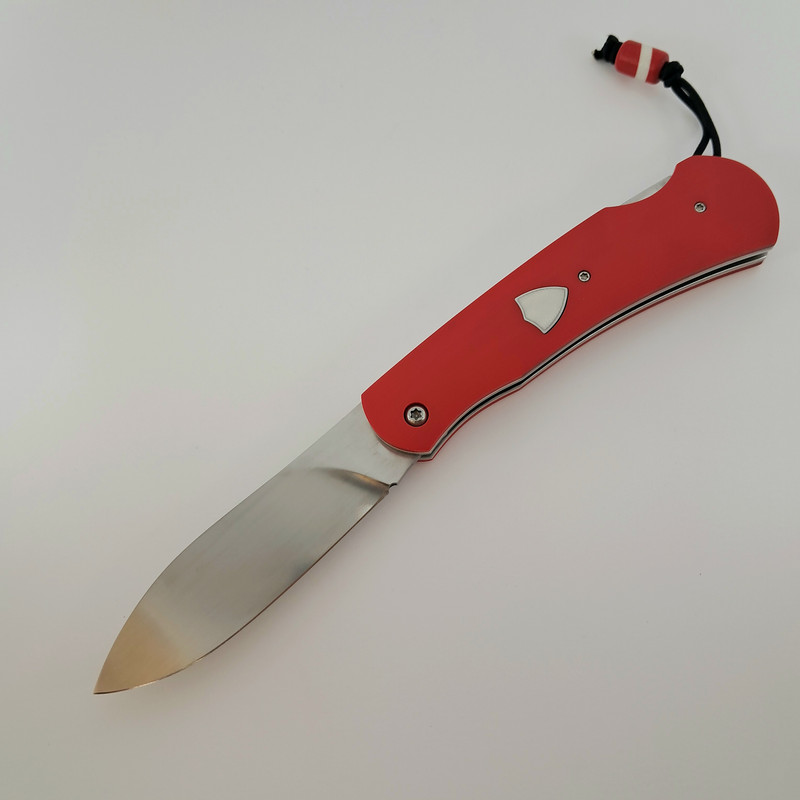

Greetings to all of you.
I would like to introduce you to one of my works from a few months ago.
It is a knife with a snap opening.
This can be operated from the insert in the middle of the handle
but the blade can be opened in the traditional way.
The locking mechanism is Back Lock.
steel: M390 3 mm
folder: 420 hardened
bolster: 420 hardened
spring - block: 420 hardened
spacer: 420 hardened
grip: g10 red
inserti: g10 white
cutting edge length: 90 mm
total length: 220 mm
I hope it is to your liking

Nicely done!
Wow, that is very cool. So much to love on that knife.
