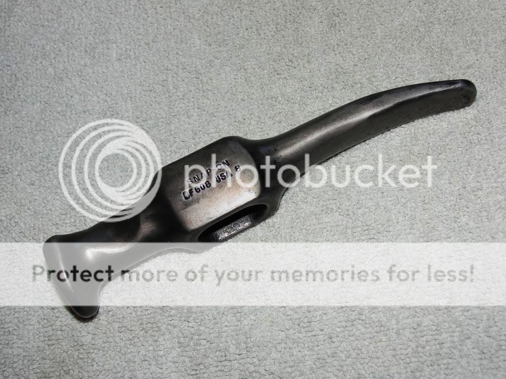

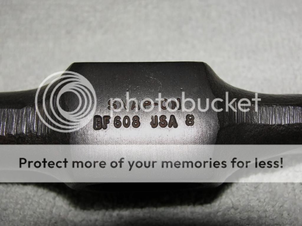

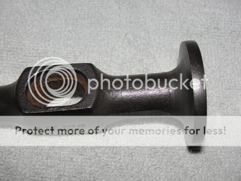

Not sure if this is the appropriate forum for a recent project I took on, but thought the "Snap-On" (Model BF 608) Auto Body Hammer holds a lot of promise for several different style conversions to use as a pretty serious cane handle. (including making a mini hatchet with spike pole)

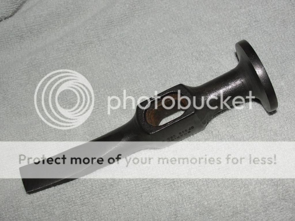

I was at first tempted to convert this into a mini hatchet on the hammer side, (short depth "blade" oriented in the same plane as the spike), and with a full pointed spike on the other. But living in New York State you have to be a bit more "conservative" in what you intend to carry, so I compromised on the changes to make for a less fearsome cane handle.

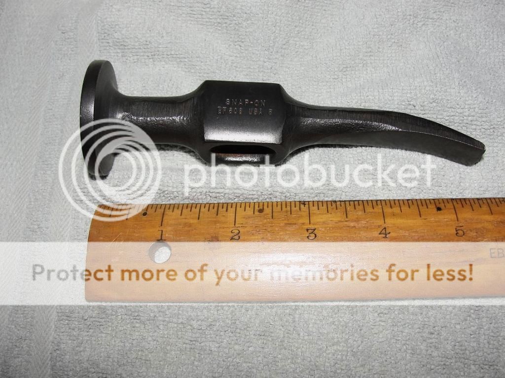

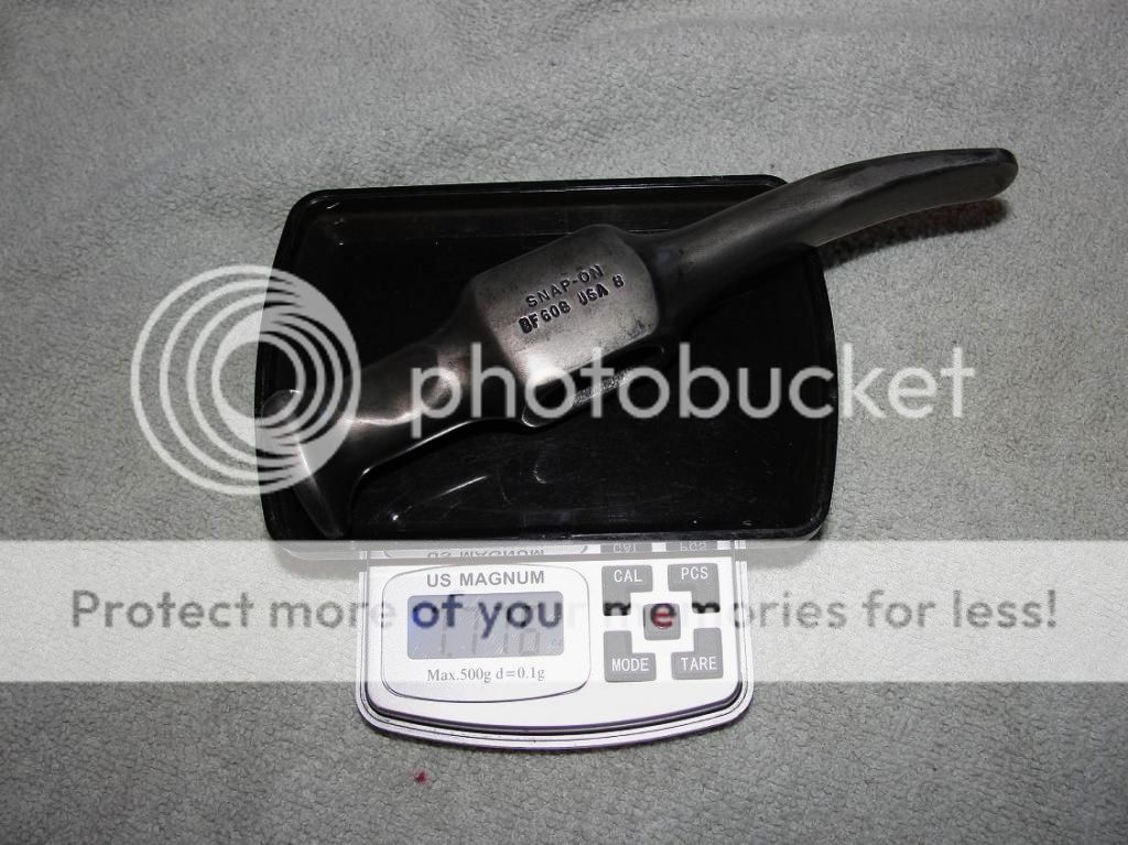

OK, so this is what I started with, a rather nice example but with the typical rough edges and utilitarian finish that I found uncomfortable in the hand as it came. But 5-1/2 inches of "possibilities". ;)
Pic #1

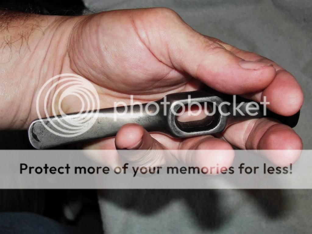

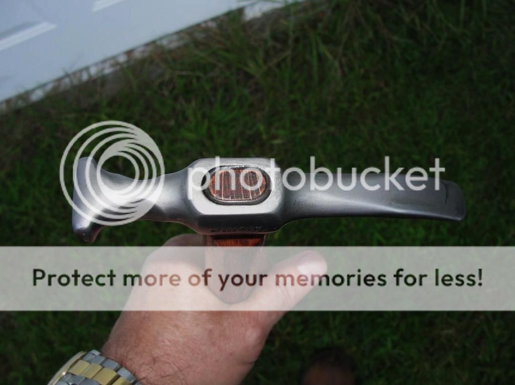

.....and weighing in at a noticeable 9.286 ounces:
Pic #2

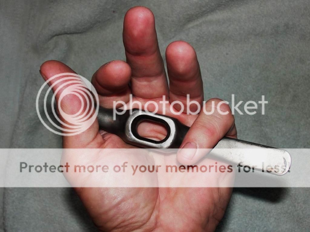

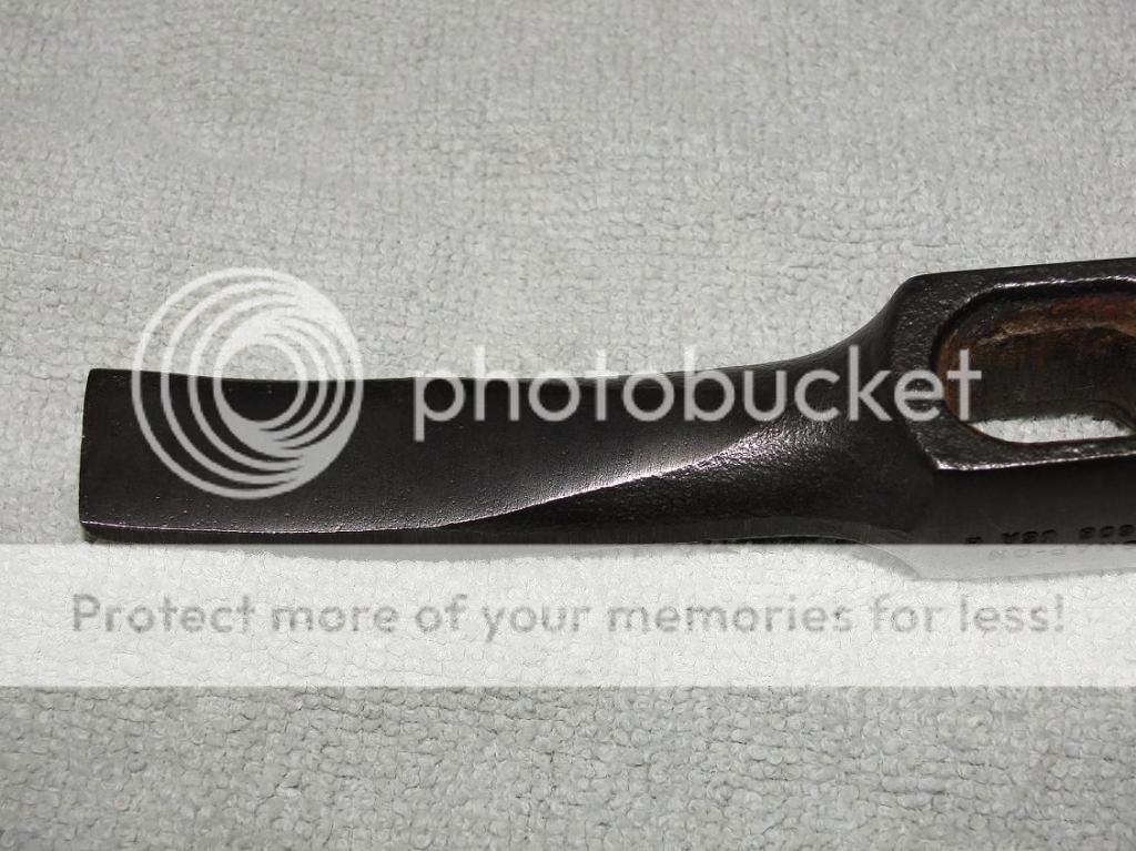

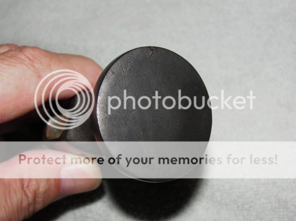

I'm pretty sure this is high carbon drop forged steel, and looks to be hardened a bit more at the hammer and spike areas. (as one would expect based on the quality standards "Snap-On" is known for). The very nice "ring" you hear when lightly striking this with a piece of steel also bears that out. Cast steel is dead sounding ;)

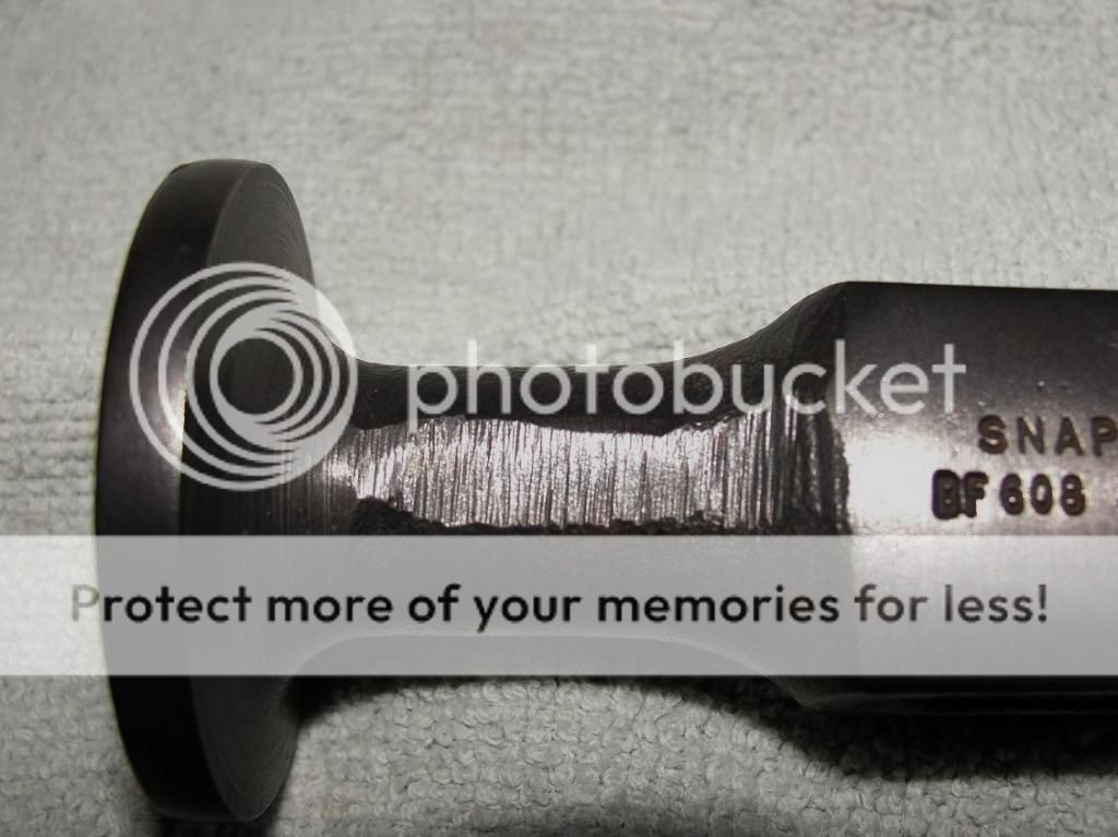

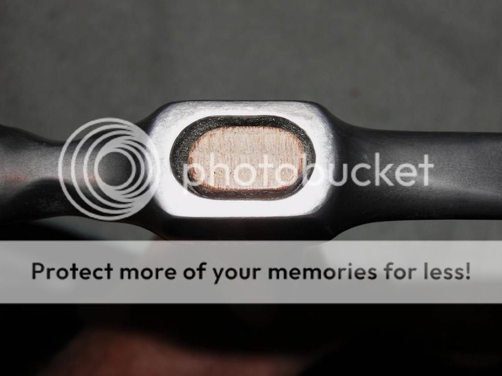

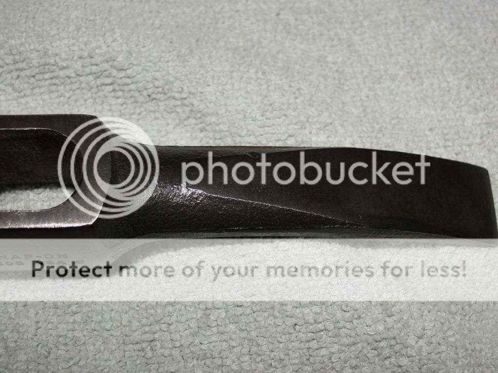

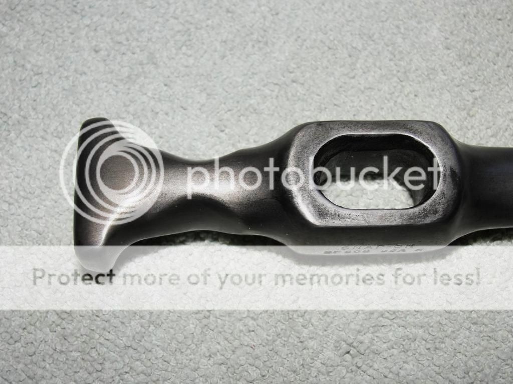

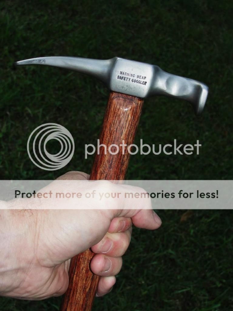

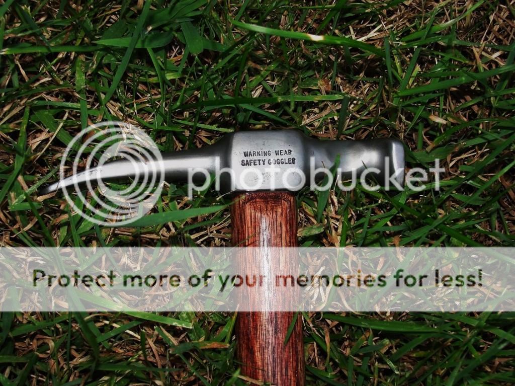

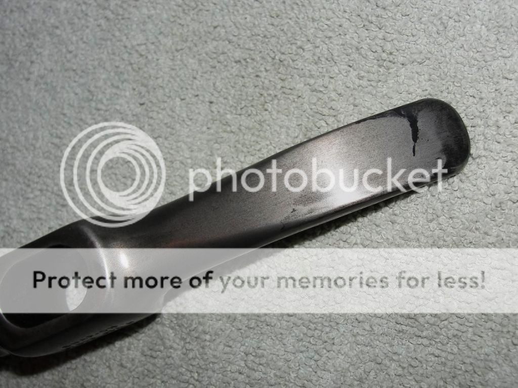

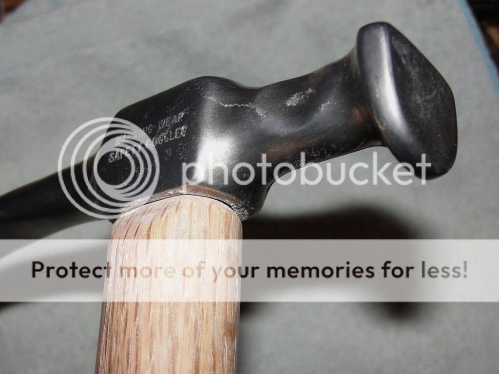

Here are some close up starting pics of the utilitarian finish in places where it doesn't matter for it's intended purpose. I took a lot of them so that others might get a better idea if one of these might work for a cane project they may be thinking of someday completing.
Pic #3
Pic#4
Pic #5
Pic #6
Pic #7
Pic #8
Pic #9 (1978 "Date Code" of Number "8" with splits separating down middle)

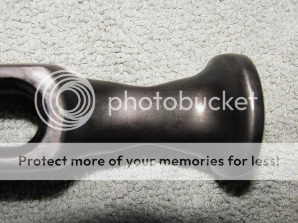

Pic #10 .....besides planning to eliminate a lot of the hammer face, ALL the back side sharp edges have a short shelf life! :D
Those SHARP contours and edges, and unsightly grinding marks HAVE to GO!

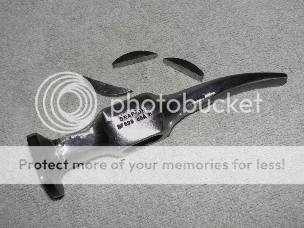

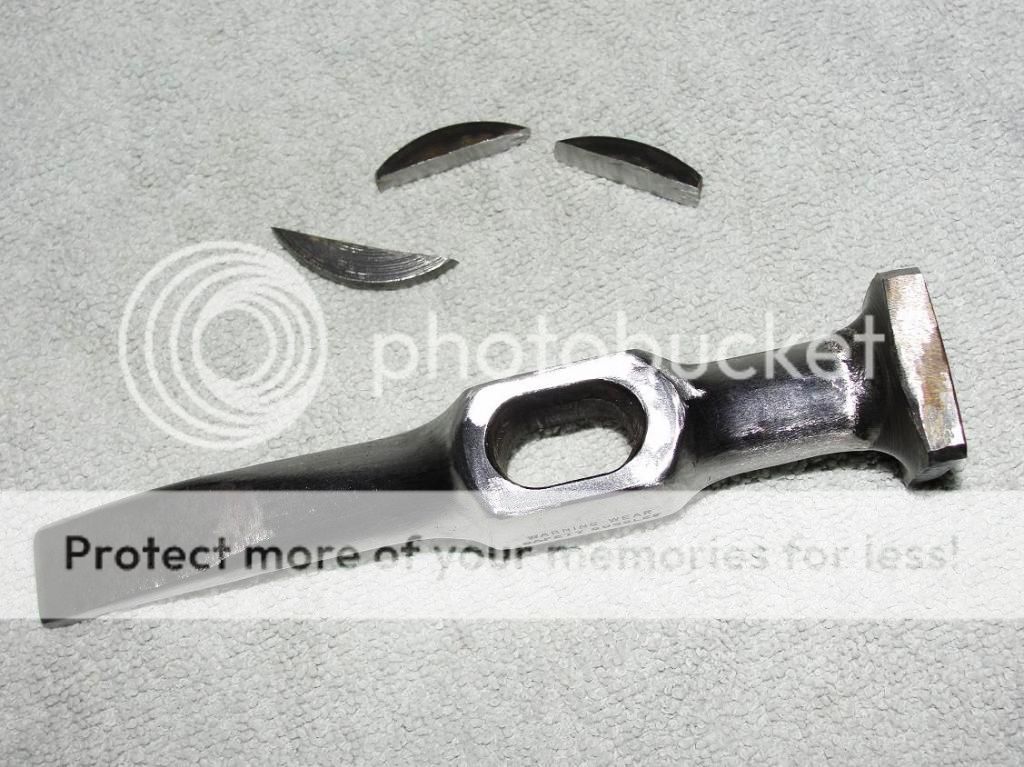

OK,...so that's what we started with. My first decision was to remove the top and side sections of the hammer side, in order to make for a more comfortable handle. Much of the sanding has also been completed using 60 and 120 grit 1/2" sanding drums on my flex shaft machine. Later hand sanding to 600 grit followed.
Oh,...definitely high carbon and fairly hard. Cutting these pieces off with several stone cutoff discs took awhile, and the SPARKS were really flying! I kept an eye on my cotton shirt, in case I might discover a new way to start a fire, ME as kindling!
:eek:
Pic #15
Pic #16

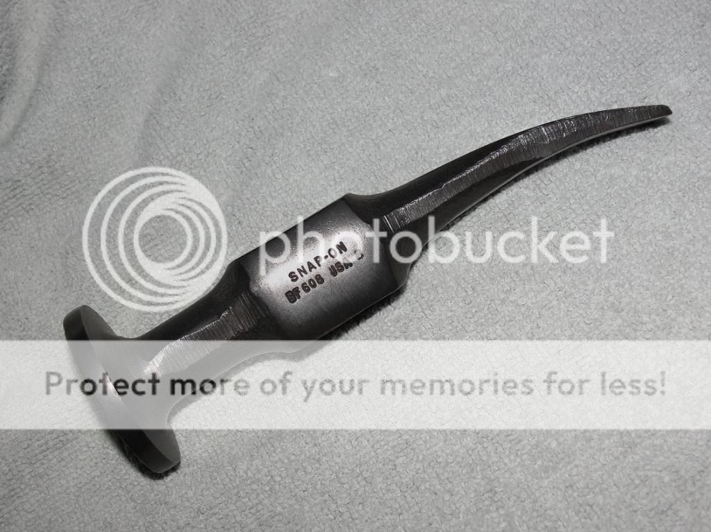

......and the still rough shape that I later decided to take down quite a bit more:
Pic #17

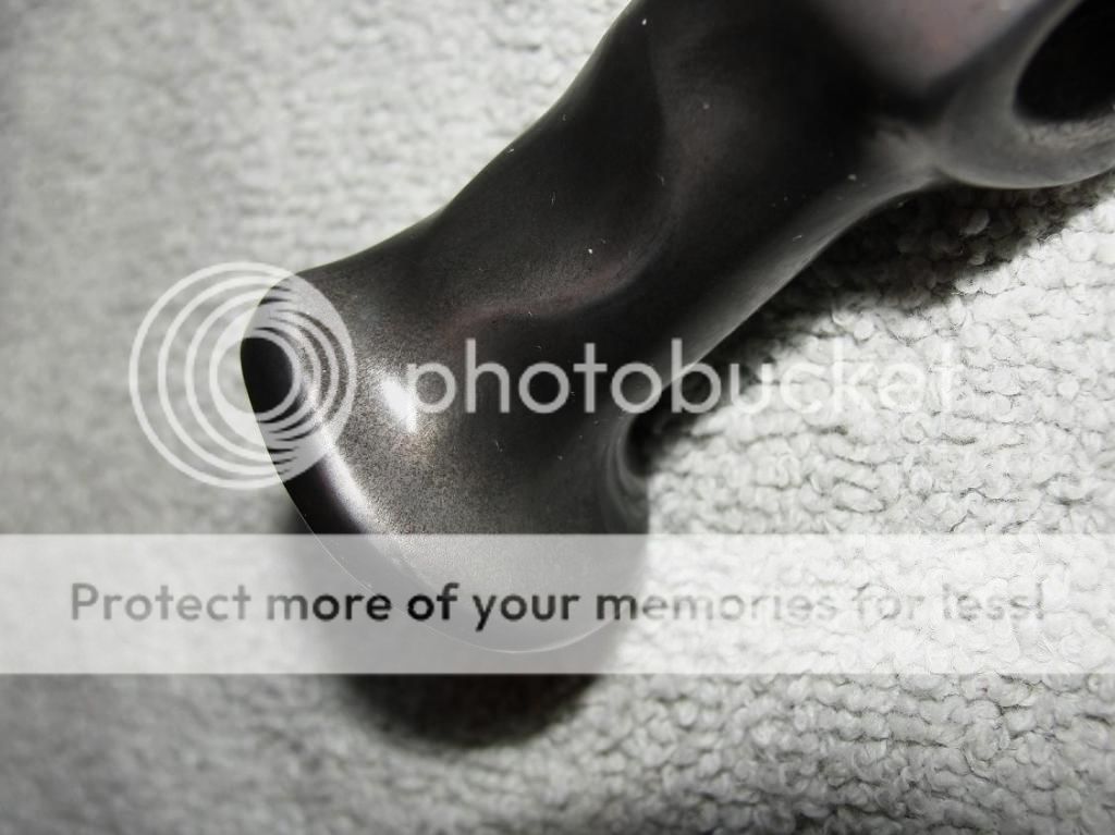

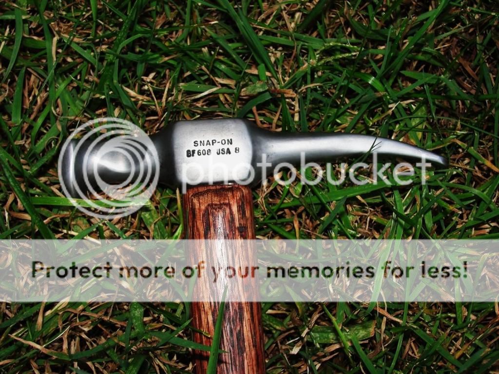

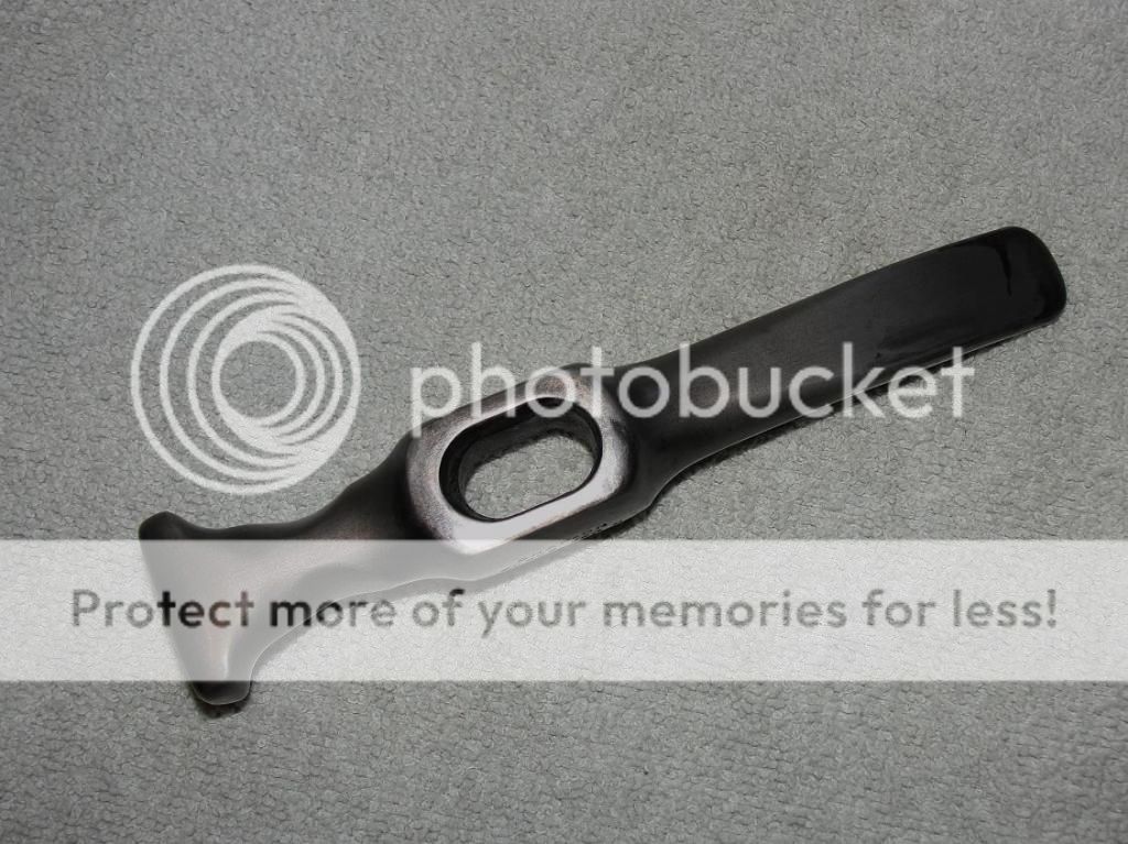

.....and after several hours of grinding and sanding, I ended up with this final configuration. (Compare to original in Pic #3)
Pic #18

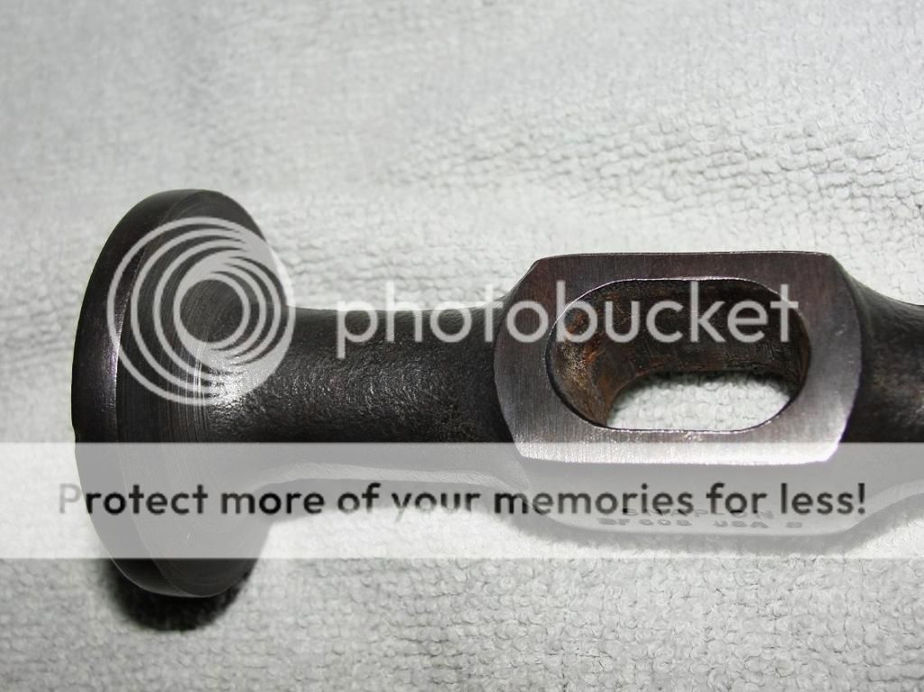

The grooves I added behind the hammer are there to make for a much more comfortable carry, allowing the space between my index and middle finger to slide right in. The area behind the hammer face has been smoothed out to a high degree, as your hand makes contact with this area a lot while carrying. (Compare with original in Pic #10)
Pic #19
As you can see, ALL the rough areas have been smoothed and shaped to a fairly high level. At one time I actually mirror polished the entire handle, but found I didn't like the "slippery" in hand feel. A hand brushing with red scotch-brite pads gave me the finish I wanted, and super comfortable in hand.

.....all the sharp corners around the shaft eye have been contoured and smoothed off to make for a comfortable surface for hand placement....... (Compare with original in Pic #12 previously)
Pic #23

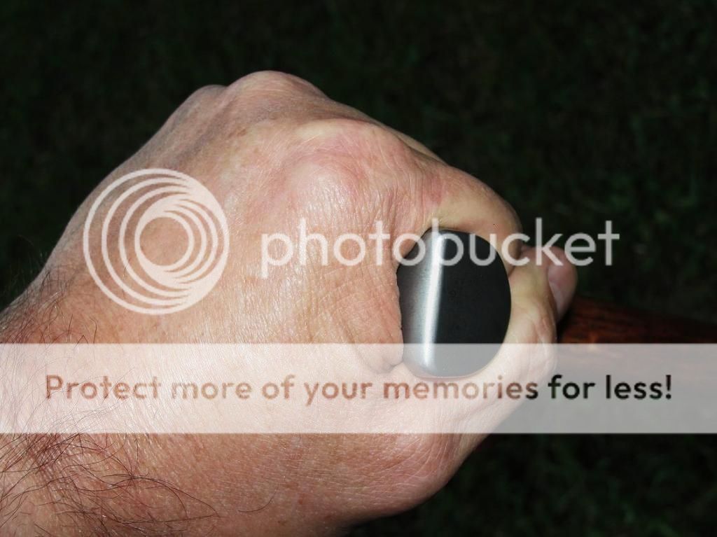

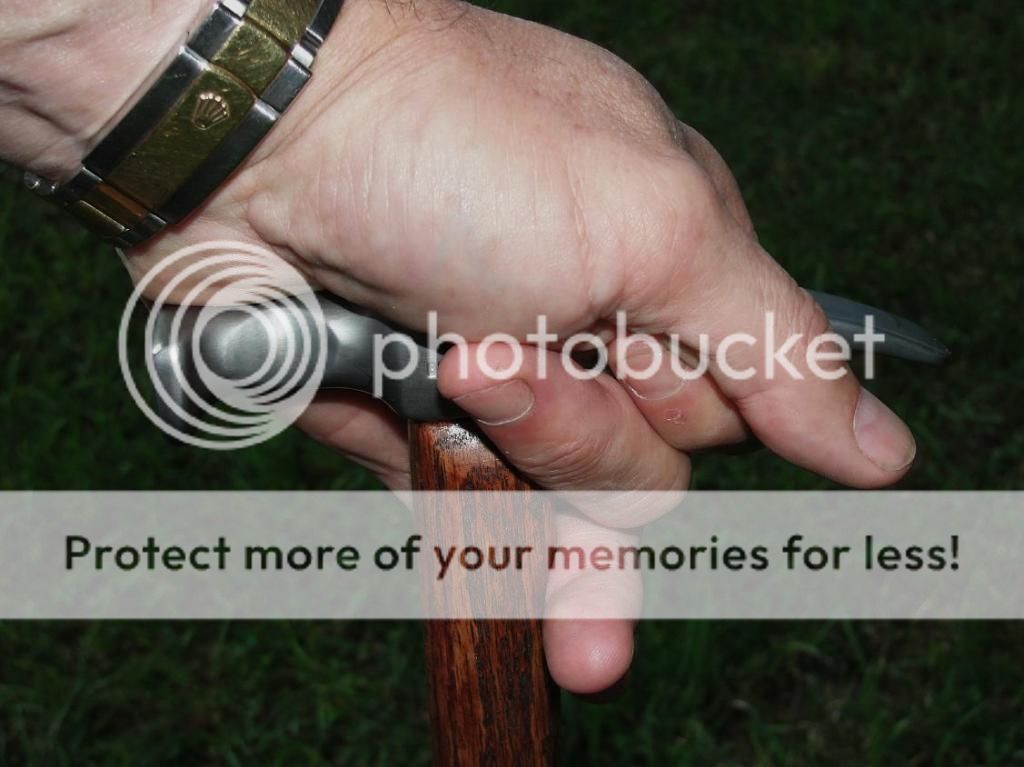

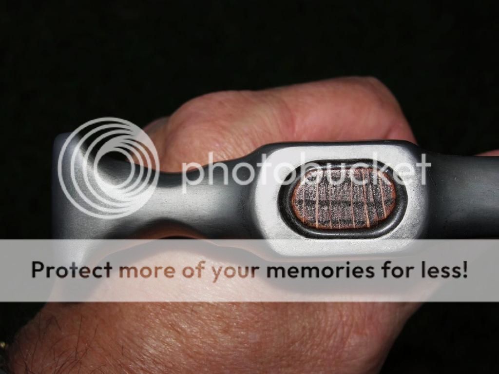

Here you can see one of the hand positions I can see me using regularly, once I find a cane shaft I like:
Pic #25
.....top view:
Pic #26

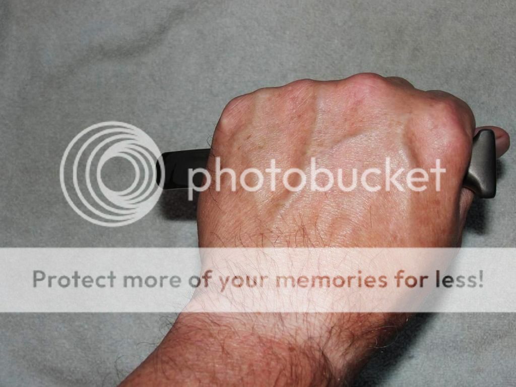

I found it also very comfortable to hold this way......
Pic #27
....top view....
Pic #28
Those finger grooves really feel great, especially smoothed off to this degree. I tapered the finger grooves deeper to the top, and that's how the space of the hand is shaped:

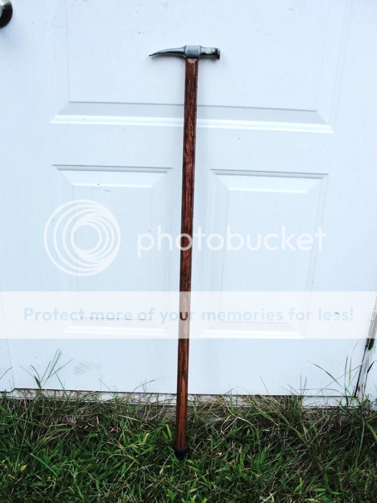

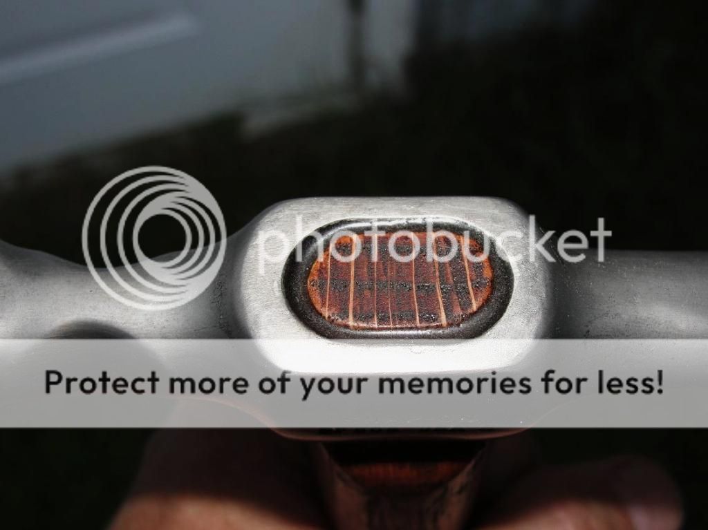

Well, last night I went to Home Depot, and picked up a decent looking 1 inch diameter Oak Dowel in 36 inch length. The grain structure looked pretty good, and had a "heft" I found appealing.
......a "worthy shaft" (until I eventually find an Ebony or Cocobolo shaft I like better), and certainly a bargain at just under $5.00

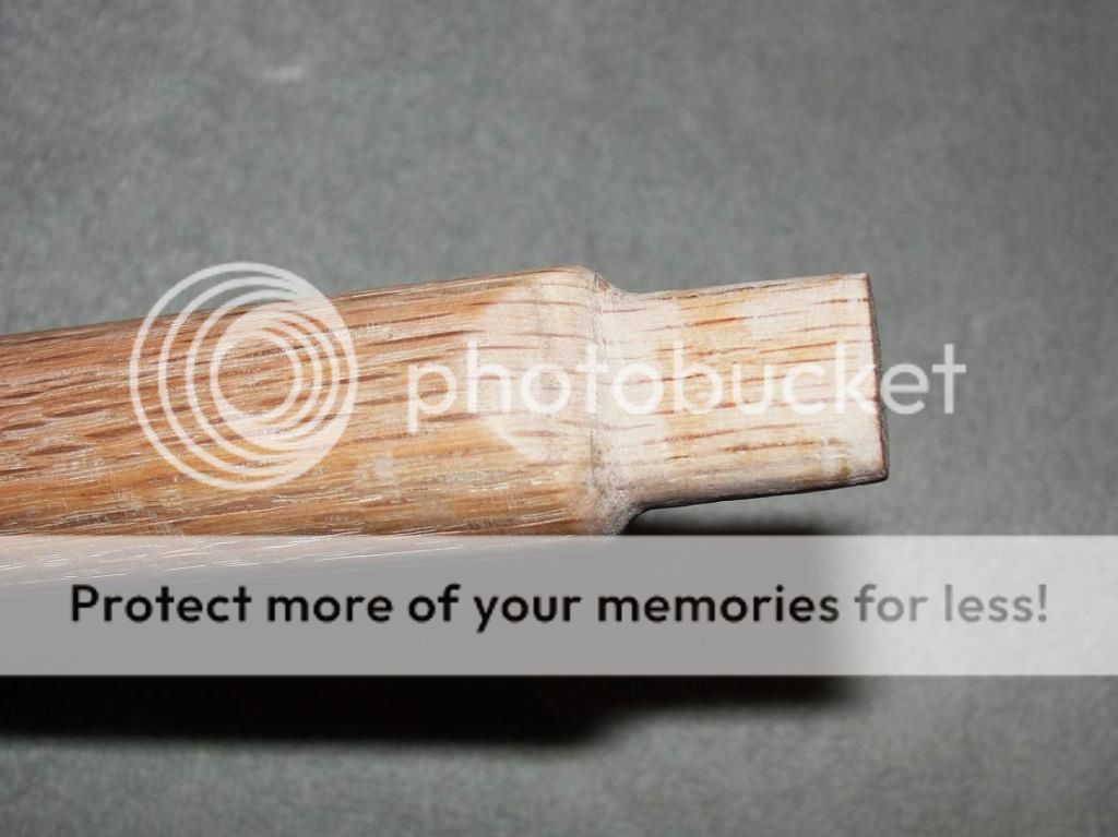

I went over the entire shaft with 220 and later 400 grip sandpaper, and carefully ground down one end to be a tight fit to the head's "eye". This Snap-On head had the usual tapered eye, on both the upper and lower openings, which funneled in toward the center.
Consequently, the shaft was fitted "tight" to the center section. Normally I would have split the wood and added in a wooden wedge, but I wanted as much wood strength to be retained in the center section, since I will be placing my weight against it and not generally using it as a hammer or pick. (not likely to "fly" off pressing downward on the shaft!) Splitting and adding a wooden wedge would have flared the wood over the top, and filled in much of the upper taper in the head.
Instead, considering I will someday be removing this shaft to upgrade, I decided to simply use high strength epoxy along with a very tight fit to the wood. I had to final seat the head with a few taps with a leather mallet. All parts of the joint were smeared with epoxy, and the head set home with the mallet. More epoxy was added to fill in as much of the tapering steel sections, and any excess wiped off with several Q-Tips dipped with a light coating of rubbing alcohol.
You can see the upper eye taper here, and a similar taper is also in the bottom.
Here's the trial fitting after having to tap on the head with leather mallet, and you can clearly see the funnel taper. There is some sanding dust still remaining, but no harm for just the trial fit. When I eventually re-shaft this I will probably remove the central head taper, which will allow for a thicker wooden section within the eye. Used as a cane handle a better choice I think.
....under view but the funneling is covered:
.....and the shaft after tapping the head off the final fitting. (all done with a hand held 1/2 inch drum sander using 60 grit and my flex shaft handpiece.)
Last night I stained the oak with a mahogany color, and wiped most of it off after the recommended 15 minutes. A few hours later and before I went to bed, I added a coating of low gloss Hormsby's Tung Oil finish. (no finish or stain where the epoxy was going) This morning I epoxied it all together.
After setting up with high strength epoxy for 7 hours, I took the cane out this evening to 2 local malls. I made no special attempt to hide the head, but simply used it as a walking aid as one would expect. While grabbing a bite to eat in the food court I placed the cane against the bench seat, and had no trouble with anyone questioning the cane's head.
Full length....(but the flash washed out the lower shaft color)
The epoxy neatly filled in around the head taper:

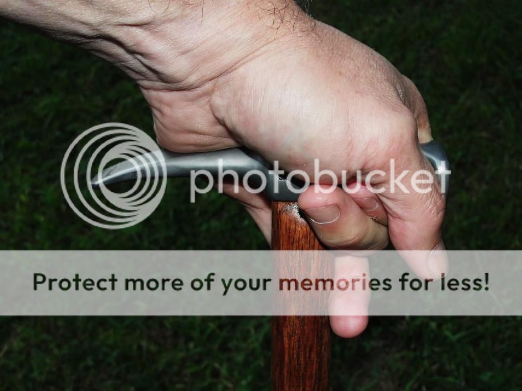

A few comfortable hand positions....
.....the most common hold,.....horn back.
I like this holding position the best, as it is affords a lot of leverage to swing the cane forward. In an emergency, it will allow a very quick "attitude" adjustment with the lower shaft, a move some might call the "nut cracker" :rolleyes:
.......also comfortable and allowing a bit more finger room, .....horn forward:
....and horn to the side which rounds up the useable holding positions:
......all in all a fun and worthwhile project.......

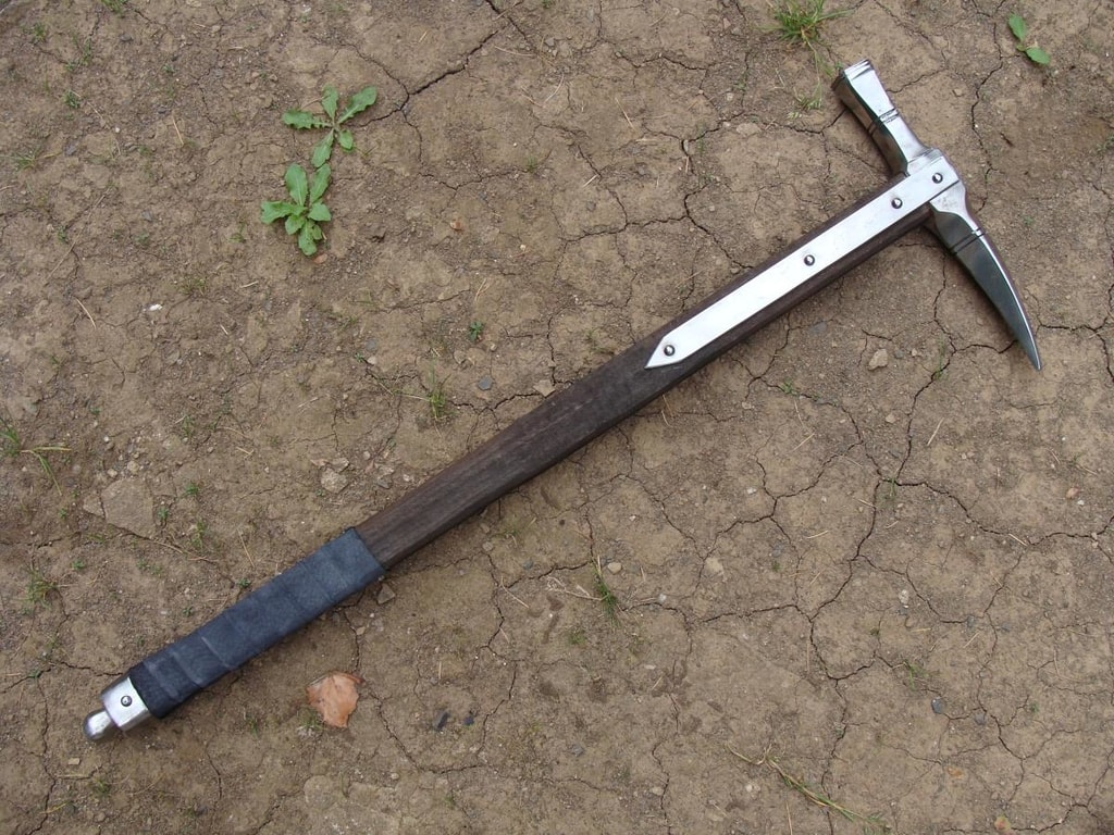

Congratulations! You have re-invented a medieval warhammer. Swords were found to be semi-useless against full plate armor so the most used battlefield weapons were warhammers, maces and poleaxes.
Ummm,...that's exactly NOT the look I went after! :(
I "could" have ground a point onto or sharpened the flat end into a razor edge.
Instead, I rounded off the original flat shape and made the edge as UNSHARP and smooth as possible. The hammer was reduced in size for comfort but not shaped into a point. As much as possible all consideration was given to becoming a cane handle, and away from a war hammer/body piercing spike weapon.
Living in New York State such is life.
.......now if I were living in Texas???? ;)
So re-invent a war hammer I think not,.....but I will say "repurposing" an item is a time honored tradition,....and one in which I often partake. :)
