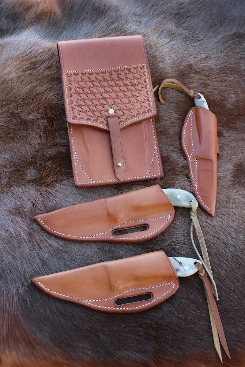

A lot of old military flap style holsters were secured with posts. Often times they were designed with an easily replaced strap if the the fastening around the post became too worn. Britsih holsters for the Webley, German holsters for the P38 (1944 model) and Cold War hosters for the CZ52 and some of the Tokarovs are examples. I took this thought into the design of my Range Flap hoster and my Scoped Rifle Scabbard. Pop one rivet and replace the strap and back in business. However like Paul said I've never actually had to do this because they simply don't seem to wear that much. But I could if needed.
This Pack Pac I made is the same. Pop the top rivet and replace the strap.

The top sheath has stingray inlay. The bottom one has a removable belt attachment so you can use it as a waistband carry instead. Kinda cool
