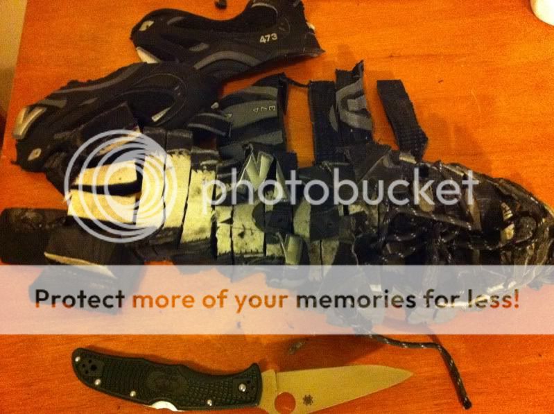

first up was a spyderco endura 4 ZDP-189 FFG:
ZDP
after the test, ZDP wouldn't cut the newspaper either with or against the grain, but it still cut cardboard pretty easily.

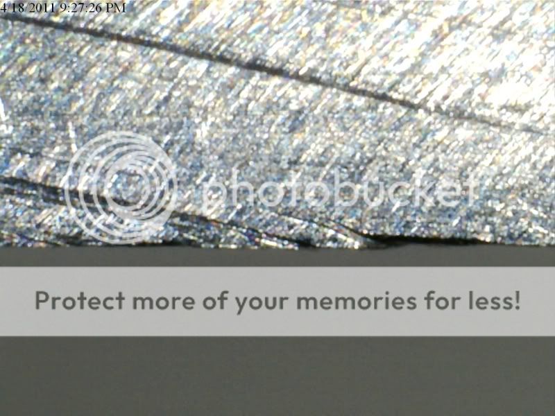

next up was my spyderco para 2 with S30V.
S30V
after the test, S30V wouldn't cut newspaper either with or against the grain. S30V also wouldn't cut cardboard.

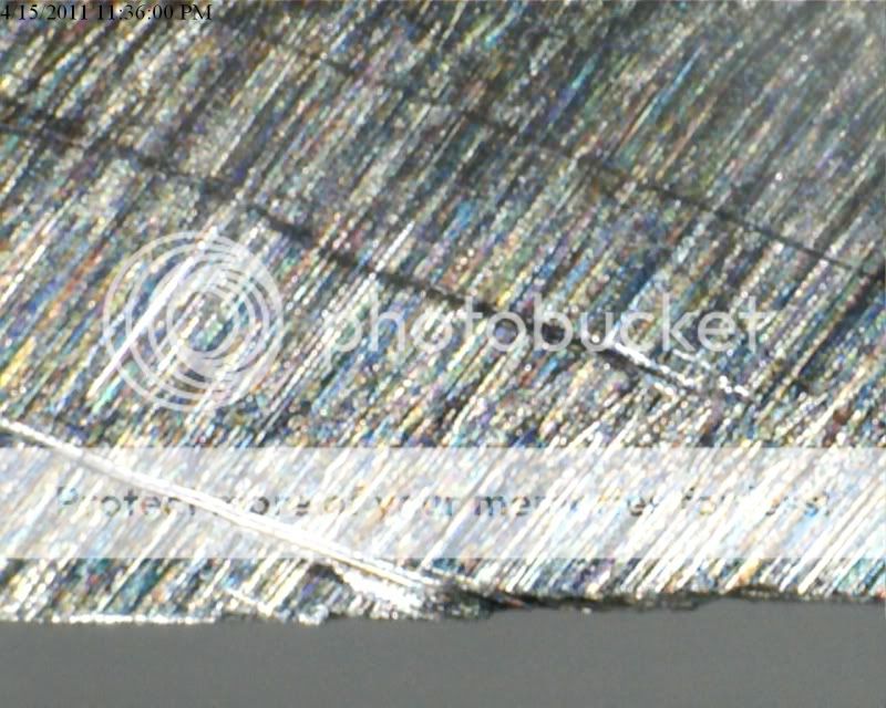

knife #3 was a spyderco 52100 mule.
52100
after the test, the 52100 wouldn't cut newspaper either with or against the grain, but it was able to cut cardboard pretty easily.

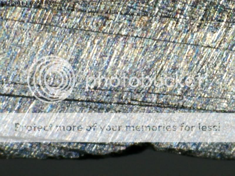

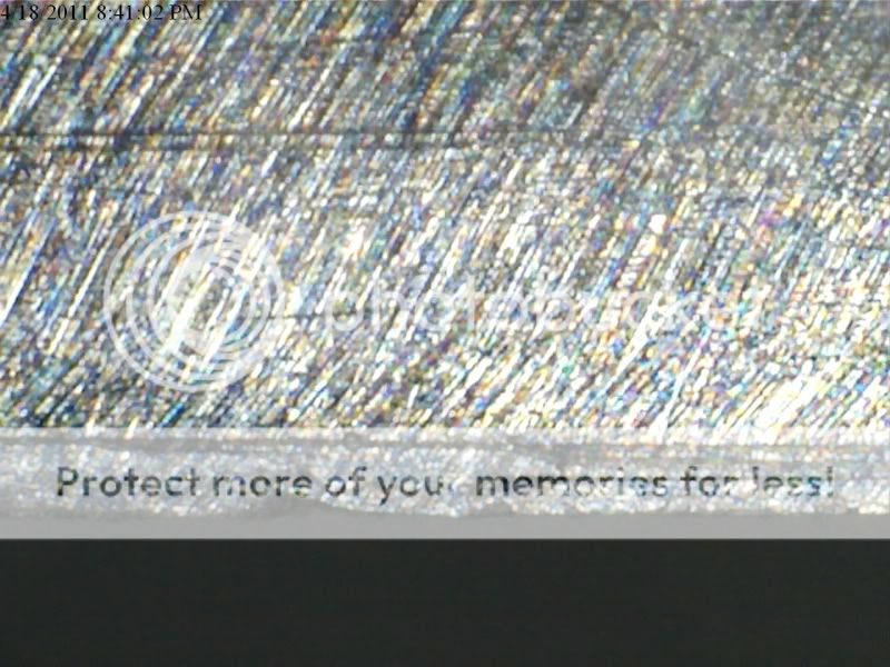

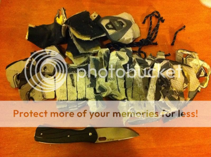

knife #4 was a buck vantage select large (420HC steel)
420HC
after the test, the 420HC wouldn't cut newspaper either with or against the grain, but it would still cut cardboard pretty easily.
p.s. out of the four knives tested so far (the 3 spyderco's were full flat grinds) the vantage select had a little less resistance while cutting. it was probably the fact that the buck has a very deep hollow grind.
