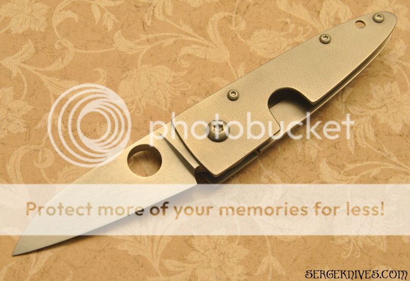

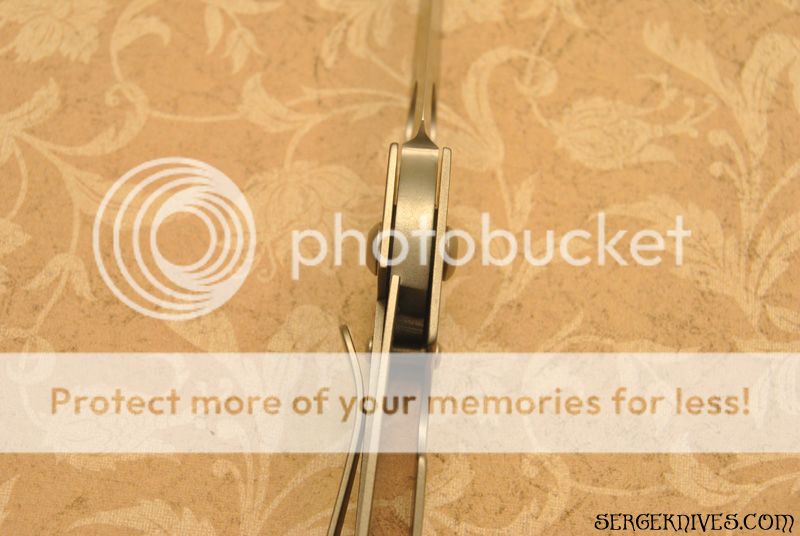

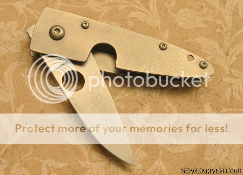

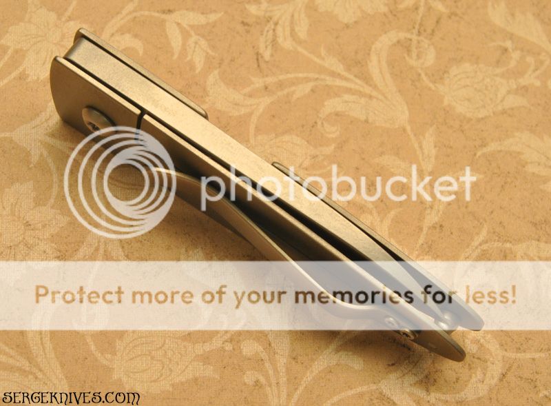

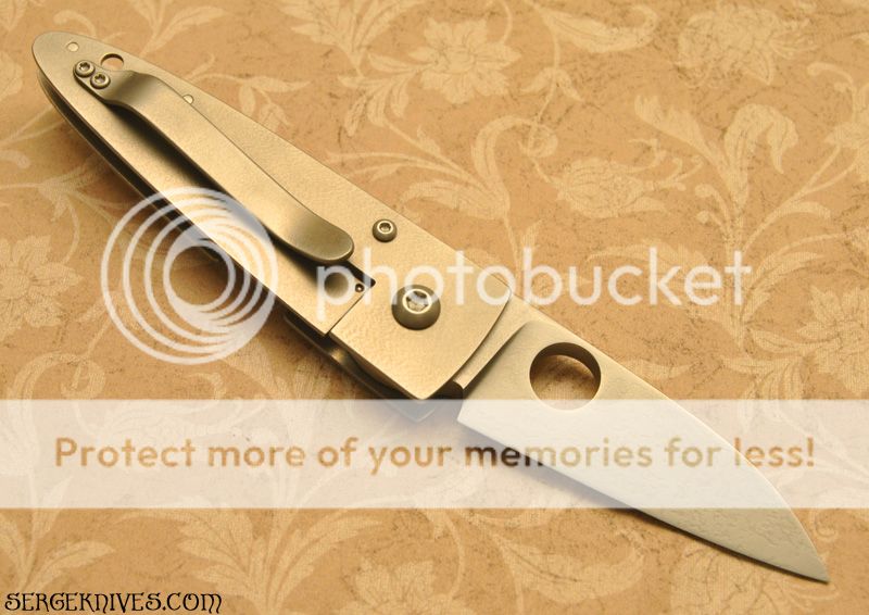

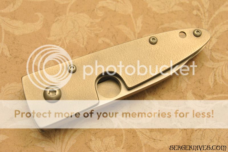

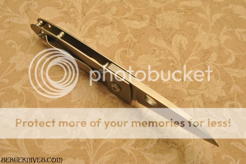

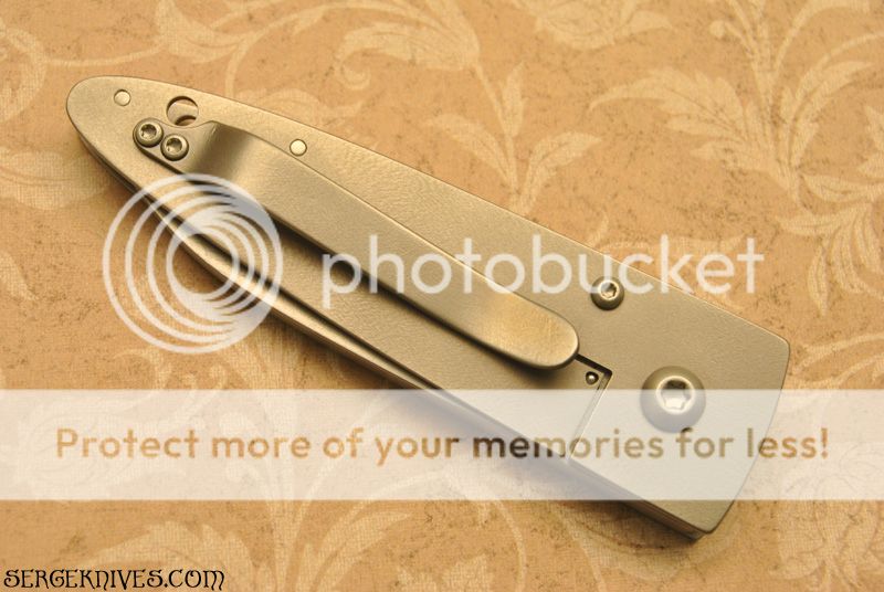

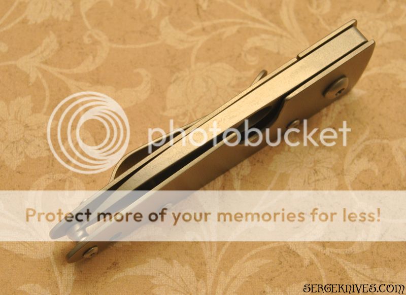

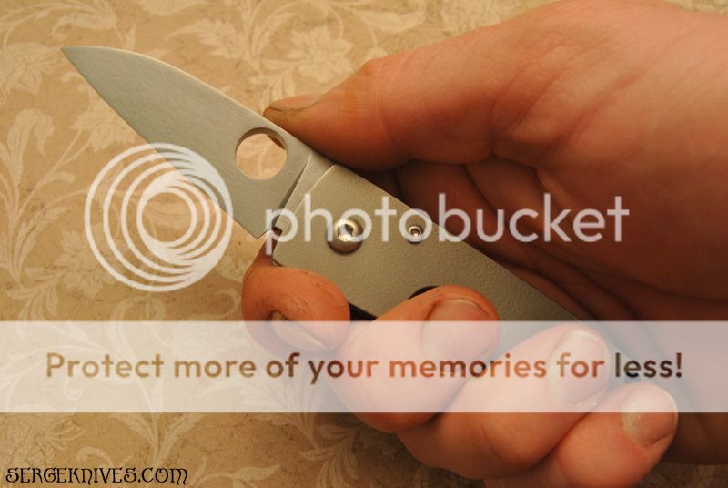

Just finished this one an hour ago. The concept for this one is a lightweight thin edc knife, with not much flash. The handle is 6AL4V Ti, with a orange peel finish that I also beadblasted. The blade is .200" 1095, with an antiqued and blasted finish. The liners are .05" thick and the knife weights 2.14 oz. The overall length is 6 1/8", closed length is 3 5/8" with a 2 1/2" blade. All screws, standoffs and the stop pin have been blasted, custom Ti clip. Spyderhole is licenced by Spyderco. Hope you guys like it!
Will you just stop for a while! I will never be able to decide which knife to save up for from you if you keep putting out such excellent knives so fast!
Maybe I'll just come stand outside your shop hoping that you'll let me sweep your floors or something. I love your style.
