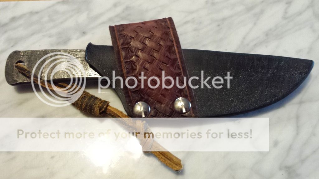

Well, it turned out nicely. I would post up a photo but the knife is being traded out and I tooled the leather for the new owner. Once he has it in hand, I will post again and add the photos.
The main reason I went with the sno seal over the snow-proof product was after one coat of comparable thickness, the sno seal held off water while the other still absorbed some...
I have two coats on the tooled area, and one coat on the inside. It is a kydex cross draw sheath with a 2"ish leather strap for a belt loop that is reversible for left/right side or back carry.

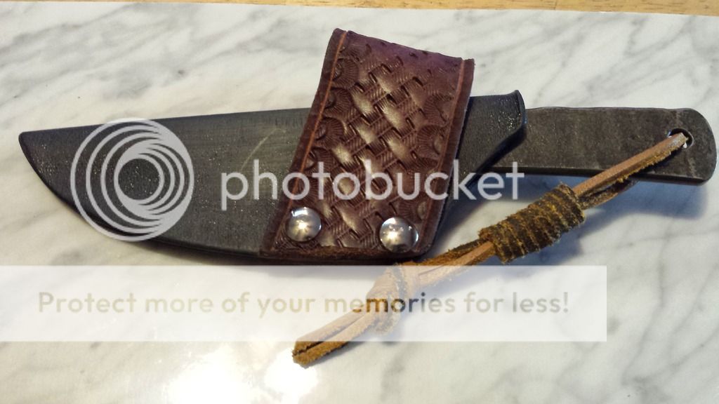

Since the sheath I made is a kydex hybrid, I only needed to add some water resistance to the strap. I used a shoulder from Tandy, and some corby's from a local saddle shop. No dye or stain was used, and the dark brown was achieved by using the Sno Seal alone.
This is the finished product. I sanded the kydex to smooth it out a touch instead of using the inside since I wanted some texture still and the inside to remain smooth.
I just soaked the leather in warm water for 10 secs or so, tooled it, then let it sit for two days to ensure it was thoroughly dried.
Then I warmed it with a blow dryer and applied my first coat, let that soak in expedited by the blow dryer. After that was soaked in I let it sit for a few mins and then I repeated the steps including a coat of the inside of the strap.
