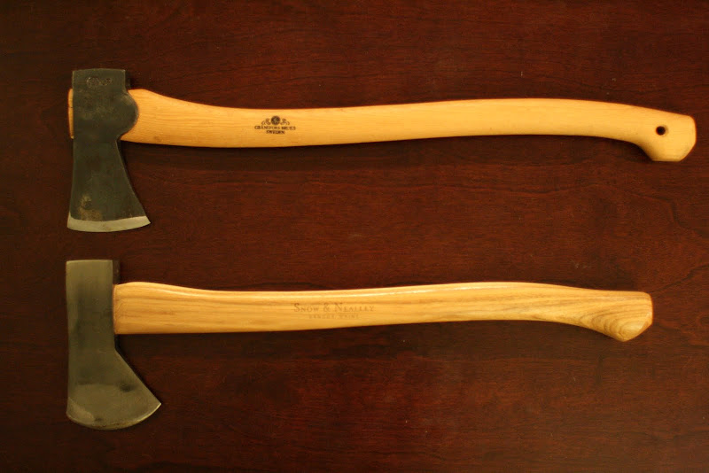

In this review, I will try to compare the Snow & Nealley Hudson Bay Axe to both the Gransfors Bruks Small Forest Axe and the Scandinavian Forest Axe. Below you can see the Snow & Nealley Hudson Bay Axe next to the Gransfors Bruks Scandinavian Forest Axe.

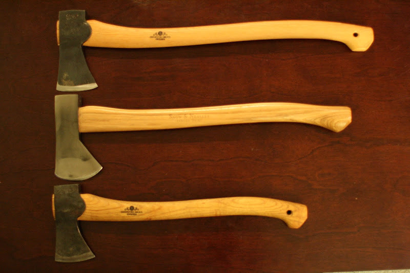

Here you can see it next to the Small Forest Axe as well.
The Snow & Nealley Hudson Bay Axe has an excellent handle. It comes in at 24 inches, an inch shorter than the Scandinavian Forest axe, and 4 inches longer than the Small Forest Axe. It has a great shape, and is very comfortable. It is one of the best handle designs I have seen. The grain of the one I got was good, although not perfect, and it did contain some hard wood.
The head of the Snow & Nealley Hudson Bay Axe has positive and negative aspects. In the picture below, you can see it next to the Gransfors Bruks Scandinavian Forest Axe. You will notice how smooth the transition is between the bit and the eye. This is exactly what I like to see in an axe head. This axe gets it exactly right. It does not have the abrupt transition and concavity that you see in the Gransfors Bruks. This creates less impediments for the wood, improving splitting performance. On the other hand, the bit itself is much thicker than I like. It is not horrible, and is clearly a design characteristic, bit the thicker bit impedes the chopping performance. (There was paint on the top portion of the head, which I sanded off)
The head is attached to the handle with a metal wedge, and it held securely during testing. The bit is longer than that of the Gransfors Bruks Scandinavian Forest Axe.
The balance of the axe is fairly good. The bit is heavier than the poll, so you see it leaning down a bit, but overall, it is not bad. This is important as it increases control of the axe during a swing.

When it came to chopping, the Snow & Nealley Hudson Bay Axe was significantly outperformed by the Gransfors Bruks Scandinavian Forest Axe.
In fact, it was also outperformed by the Gransfors Bruks Small Forest Axe, and axe with a lighter head ans shorter handle. This is clearly a result of the thicker bit.
