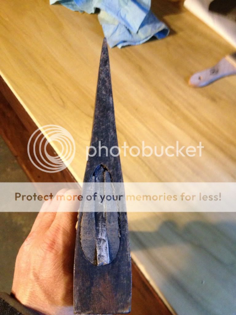

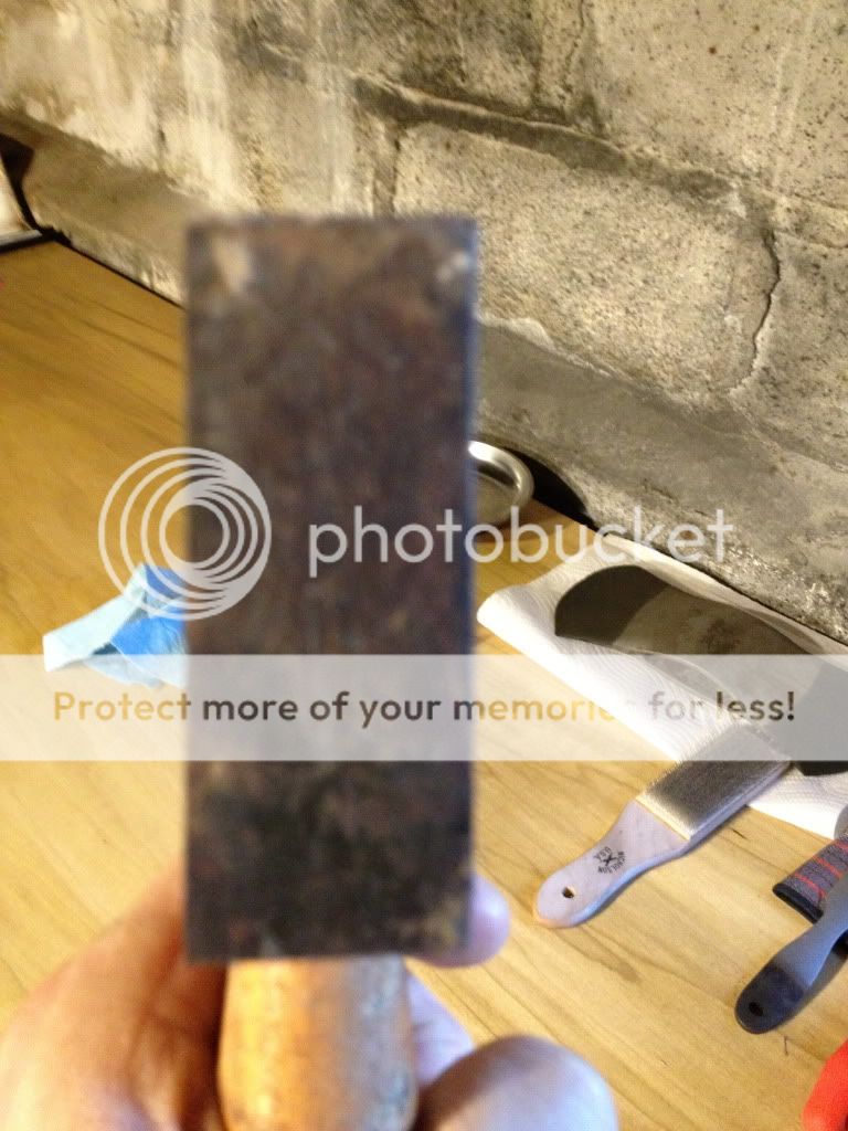

Here is is from the top (note the wedge shape) and back (note the very clean pole)

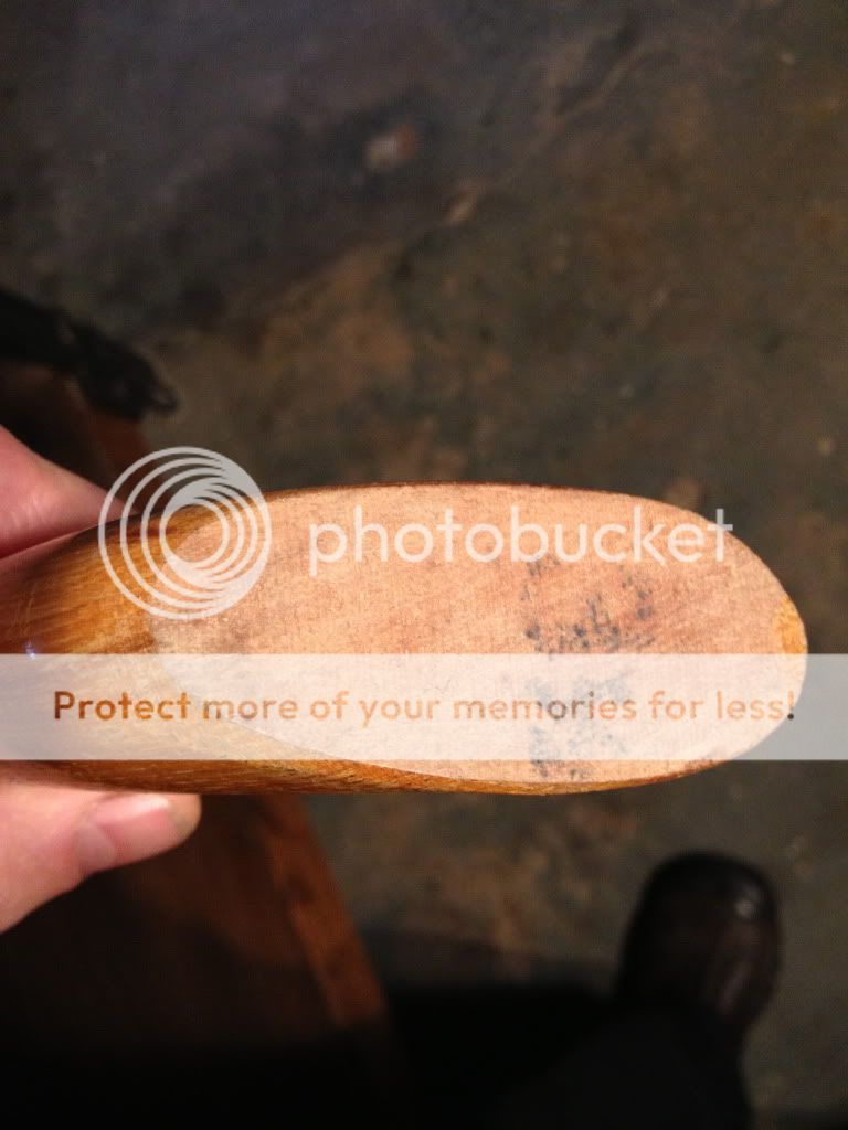

The end of the haft was never cut off, and is pretty clearly marked "3 1/2".

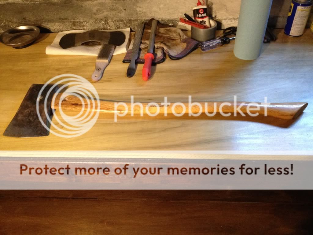

Finally, an overall pic that shows the short slender haft and overall condition.
Any thoughts on how to clean this one up without a bunch of grinding or etching?
Thanks.
Brass wire cup on a 4-1/2 angle grinder. Cleans it nicely and leaves more of the natural patina in place than a steel wire brush.
Wow!
That thing is beautiful. You had better watch out though... Coop might find you and steal that one from you :D

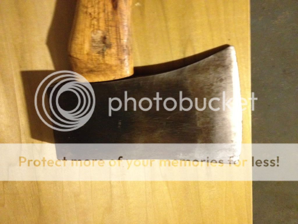

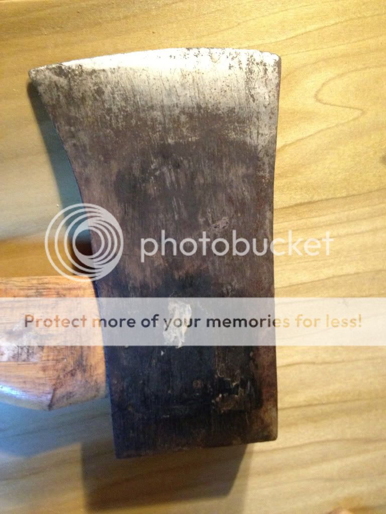

Here are a couple photos after a small brass brush in a drill. The second shows the only stamping on the actual head "3 1/2".
Also, once some of gunk came off the head, I noticed it is not as completely triangular as I first thought. It is actually hollow ground/forged through the middle before tapering again toward the edge.
