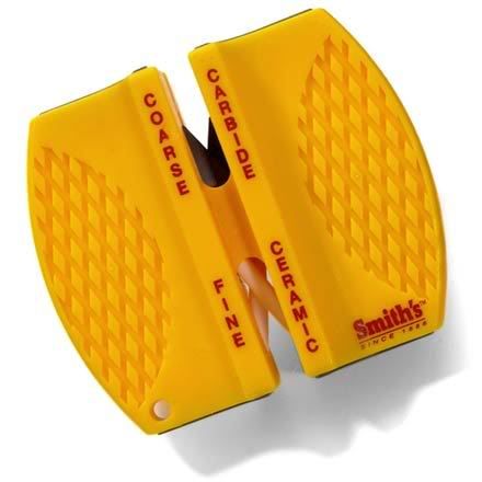

Generally I think you should avoid any kind of "slot" sharpener, especially those that use tungsten carbide and are very hard on your edge.
I guess those are alright for the field or for touchups and things. Thats all I have mine for.
The carbide part on some of those little sharpeners is such crap. It scrapes metal off your knife, and you can see little slivers of steel on the countertop. Not cool. This is the one I have.
