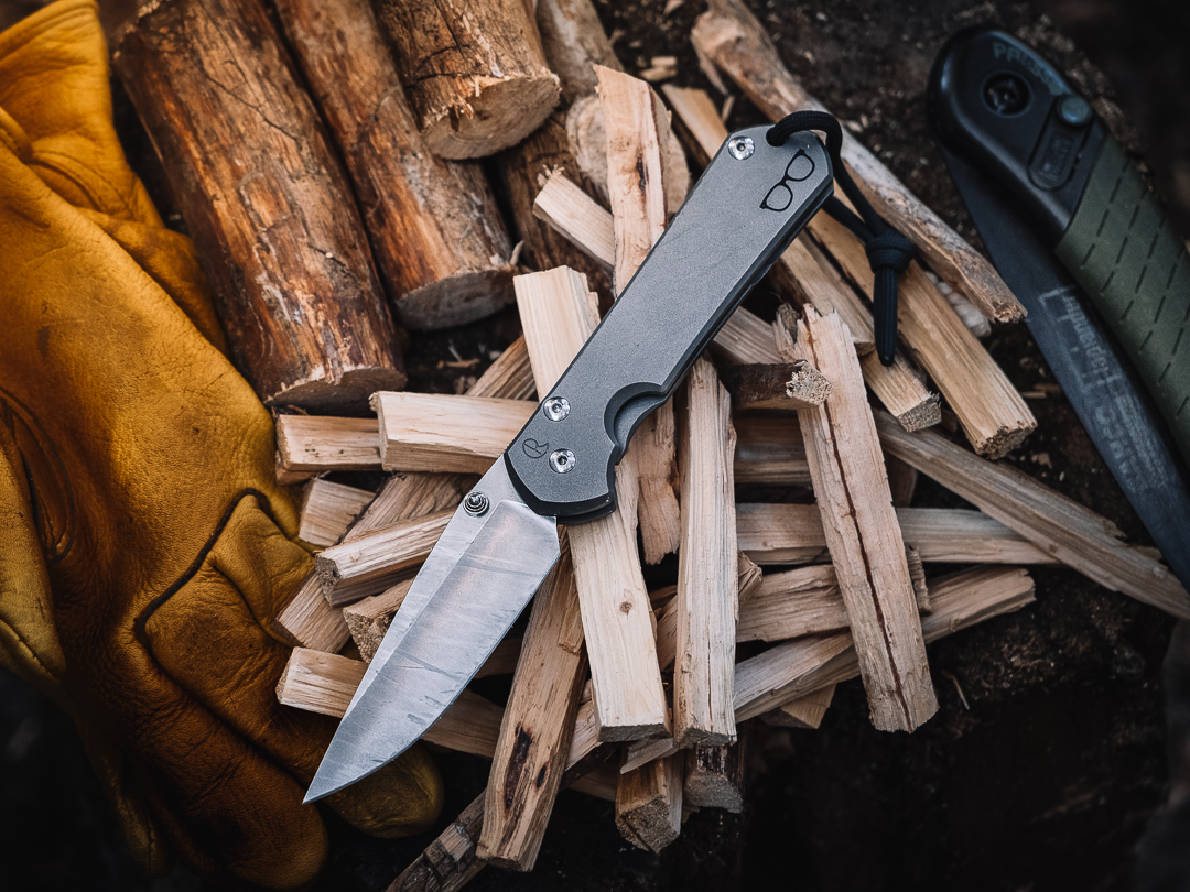

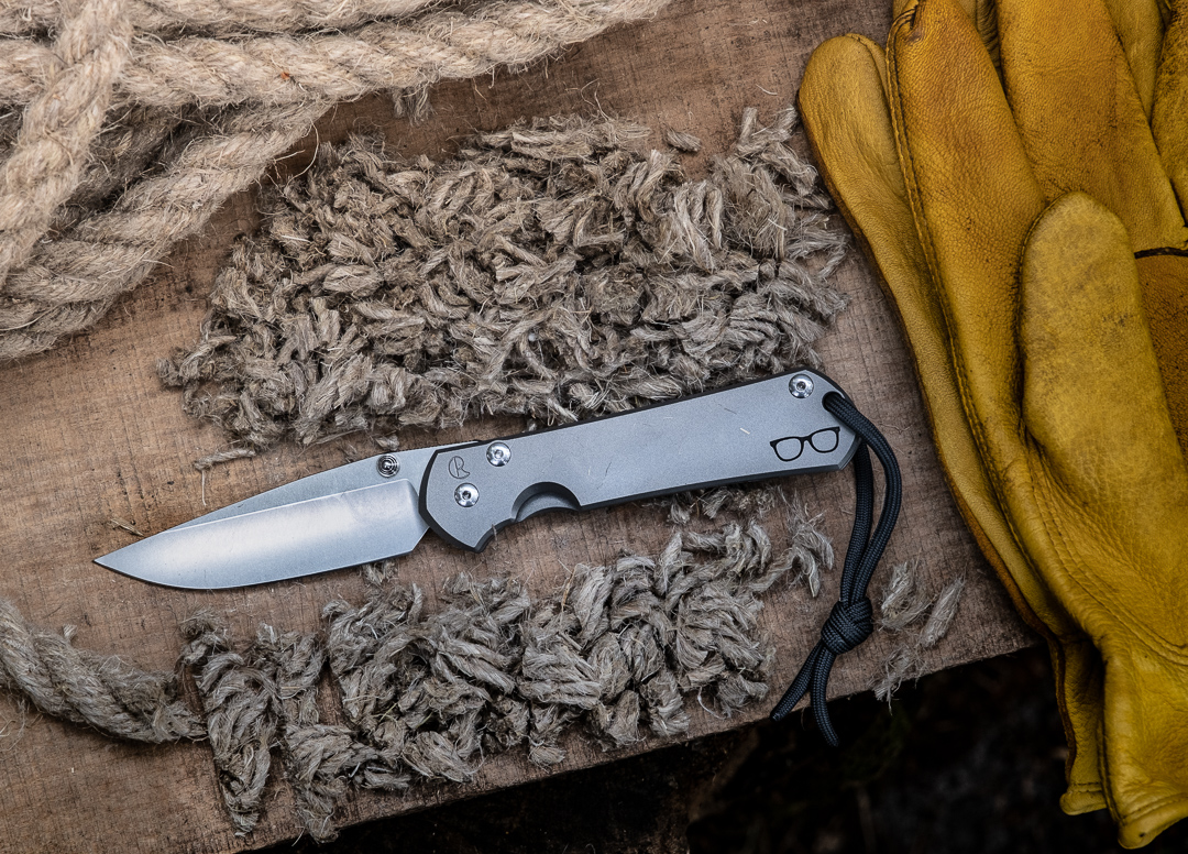

I can say I really checked well how good it is at cutting / edge retention, especially compared to S35VN, S45VN, Elmax, LC200N, and m390. To some extent also vs K390. For regular cutting (food, rope, whittling) it's clearly better than S35VN. Seems to hold edge also longer than my Inkosi in S45VN and some of my Elmax folders too, but the difference is not so big. Compared to m390 (TRC Knives, Spyderco) it's more or less the same... maybe m390 in TRC holds the edge even longer? I know how it sounds, but really, m390 is amazing in edge holding.

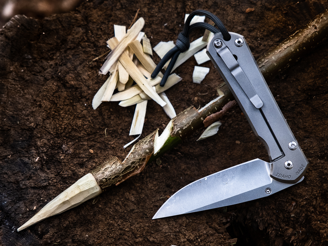

Toughness... well, I tried some batoning, notching in hardwood, etc. so I can compare it against other folders. But honestly, comparing it to my big fixed blades in 3V or Vanadis 4E makes little sense and it's more like a feeling than a real fact. It seems to be as tough as my 4" custom puukko in Vanadis 4 Extra (with an edge thin enough to compare it to Sebenza). My 3V knives (Benchmade Leuku, CRK Impofu) both have a considerably thicker cutting edge, so it's hard to compare them. With the same geometry maybe it'd be similar? I'd need a 5-6 inch fixed chopper in MagnaCut to determine that. But for sure it's way tougher than S45VM, m390, S35VN, and other classic folder steels... with the same or better edge holding. And that is amazing!

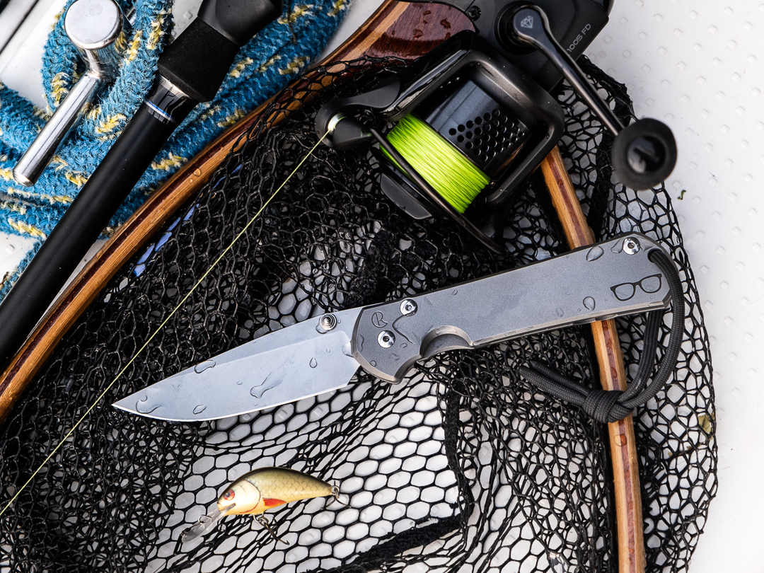

Of course it was not scientific experiment but as I said I used MC on a boat for 2 weeks (incl. fishing, cleaning catch, cutting wet rope, kitchen stuff, etc.). It was in humid environment (or just wet) almost all the time. After two weeks the blade didn't exposed even a single slightest dark spot of stain or rust. In my book MC is simply totally rustproof. I cannot see any way to make it rust except on very clear purpose by treatment with some specially prepared chemicals etc. (which can be done to any steel I believe). It's the new "SALT approved" material by Spyderco and I'm sure Sal did his job well with R&D in Golden.
