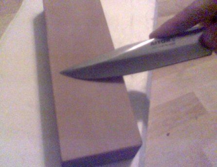

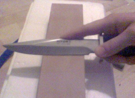

I get the angle from doing a couple strokes at the base of the blade first, using my index finger as a guide. I have a couple of positions I hold it against the spine, depending on the knife. The full length stroke ends to a slight touch to my finger so I know it's right. I try to hold my finger just a hair over the stone, so I don't get any needless abrasion against it. Still I have broken my skin many times. If I've been sharpening for a while, and get the "touch", I check the angle only so often, and minimize this problem. It's usually worse if I haven't been sharpening for a while.
Some pics; the first one illustrates the grip I use and using my finger to assure the angle. The second one is the start of the honing stroke. What's missing from these is my other hand, which I used to hold my cellphone (sorry about the bad quality of the shots). I lay the tip of the fingers of my other hand on the edge of the knife to increase control and control the pressure. Without this, it would be pretty much all over the place. Good lighting is also essential, sunlight is the best IMO. Most important thing is patience though. If you want a good edge, you have to concentrate. It's yoga.
For the other side: I tilt the stone a bit, switch hands.
