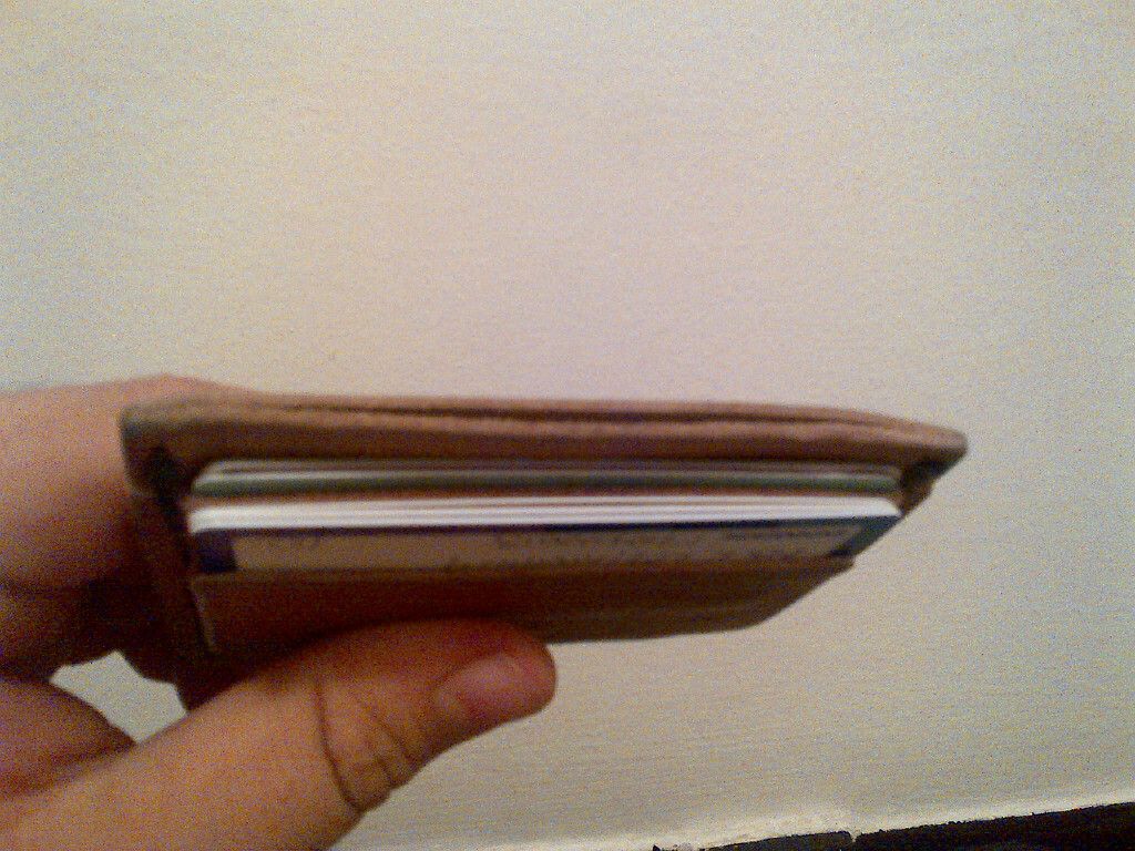

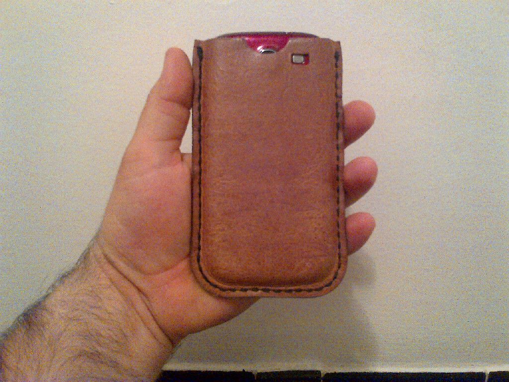

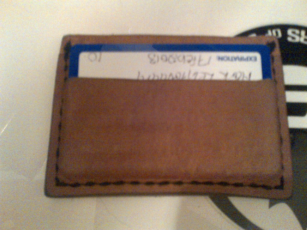

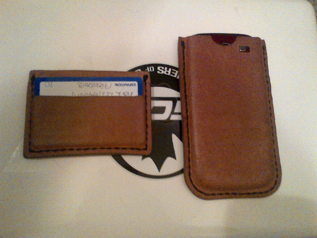

Well, I guess the pics speak for themselves..... ;)
I am pretty happy with how they came out, as I have never done anything like this before.
The next ones will be even better. I have some new ideas, and reallly doing it, and trying it out is the only way to learn with stuff like this.

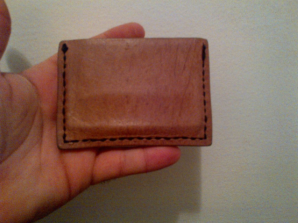

All hand stitched.
I use a very fine/sharp flat screwdriver to make the holes/slots for the stitching, but before punching any holes I use a ruler and scrape a faint line in the leather to follow. I then punch out all the slots on this line.
Then it is hand stitched using a saddle stitch.
Honestly I don't have a single purpose built tool used in the process. Just what I already have and making it work.

One thing I learned from making and repairing many leather items in the saddle shop is this;
Use round holes for sewing, oblong holes for leather wiping, decorations etc.
What ends up happening is the oblong hole punch cuts the leather in one direction and encourages the leather to rip from hole to hole.
The round holes usually punch a non-directional hole and push/compress the leather that actually will grab the thread and hold really well.
One time saving thing is to get a stitch marking wheel. The cheapy plastic handled ones work fine for occasional use. Then just use the marks you want.
You can also use a drawing compass to mark your stitch line. It will be nice and straight.
Did you use any glue?
If you ever want to burnish the edges, you can use an antler, bone or hard piece of plastic.
There are a lot of time saving tricks you'll learn as you do more.
