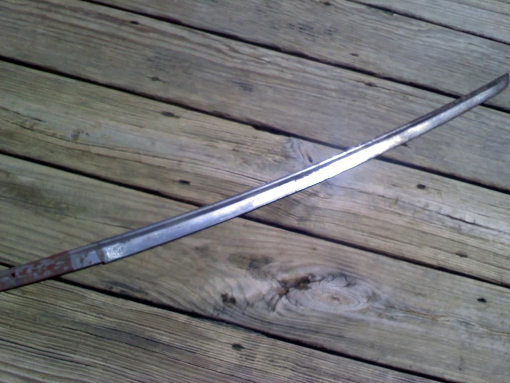

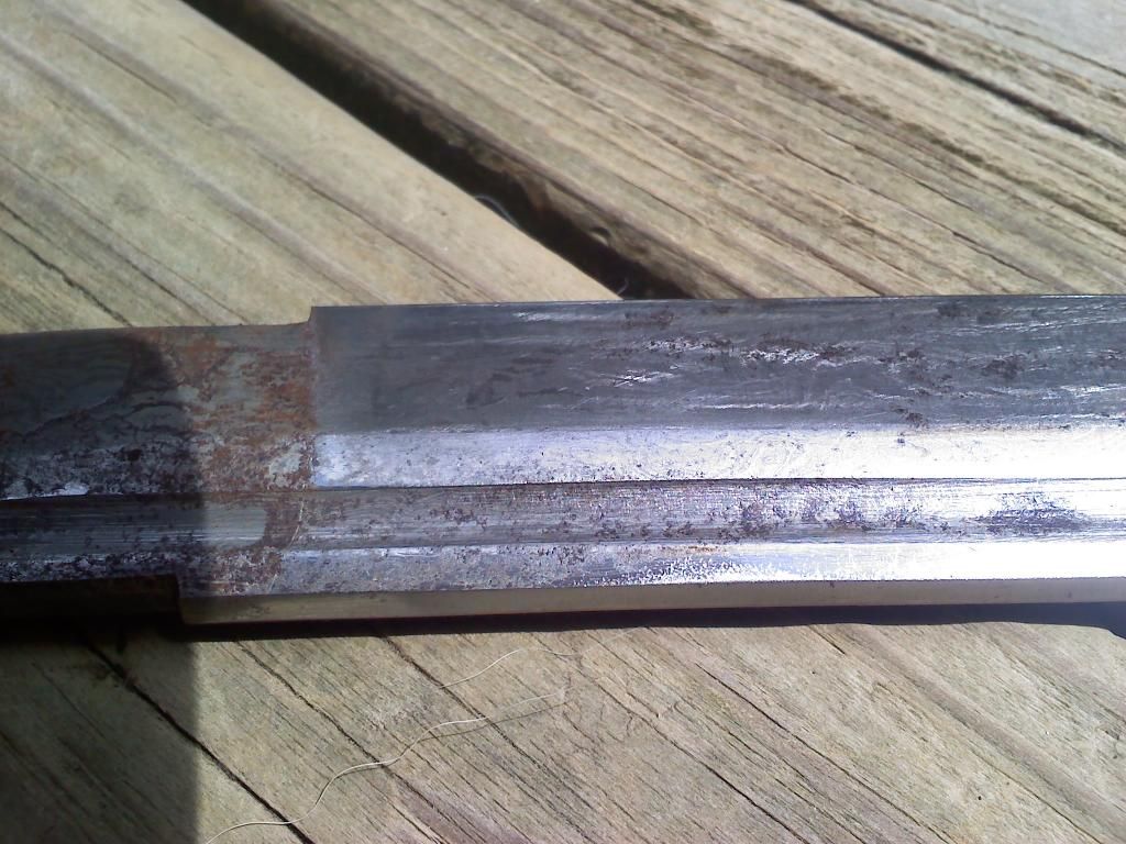

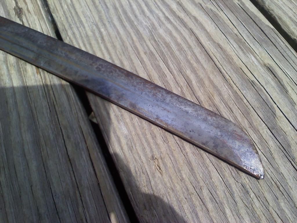

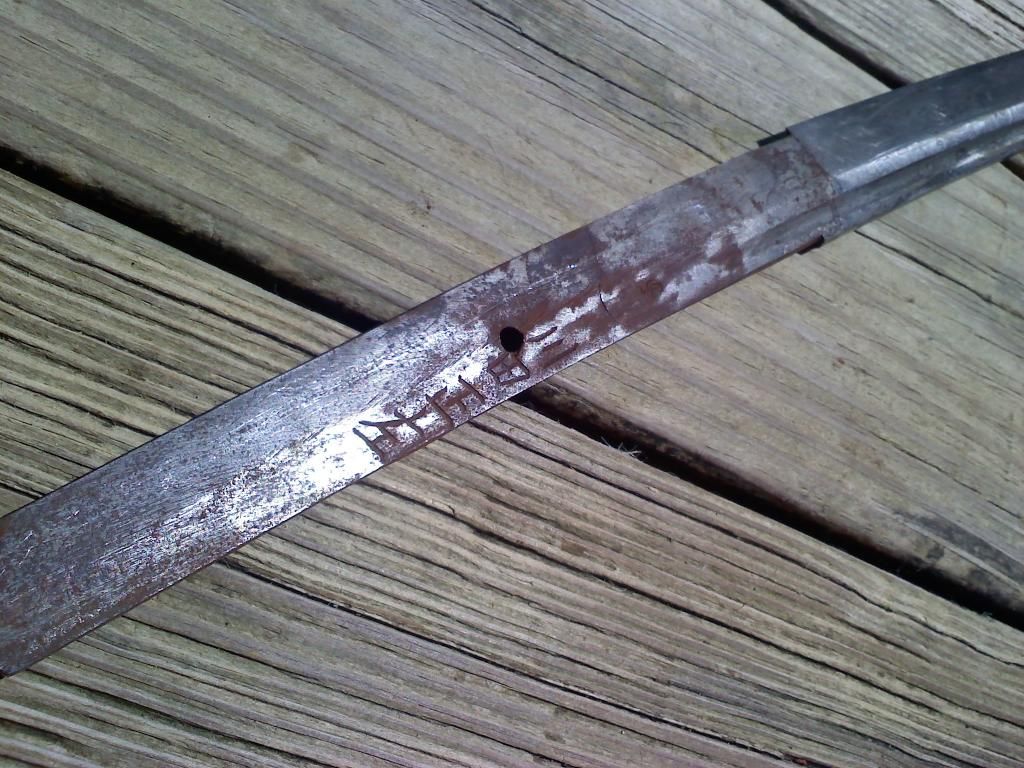

I'm not very good at discerning fakes from real or establishing whether or not a sword is worth restoring so I'm hoping one of you gentleman has some insight on this piece. It came from my step-father's pile of oddities and he's known for finding the odd gem in a pile of garbage but since he's in a coma and not likely to come out of it, I have no way of knowing where this sword came from. Judging from the poor condition of the blade and it's mountings, I assume it's been sitting in someone's basement for a long time but beyond that, it's a mystery. It lacks any yokote line and the grain is extremely suspect. There is also no clear hamon, no obvious yasurime, and the habaki has a stamped "serial number'. Basically, I have severe doubts about this sword but I'd hate to send it down the river if it was actually "something". The cracked nakago makes it pretty un-savable, even in the absurdly low likelihood that it's real.
I can recognize and appreciate a real nihonto when I see it but when it comes to this rusty stuff, I'm at a loss. I've seen nihonto up close that were in bad shape and was quick to say "fake" only to be proven wrong so I'm just looking for confirmation that this sword is, in fact, scrap metal.

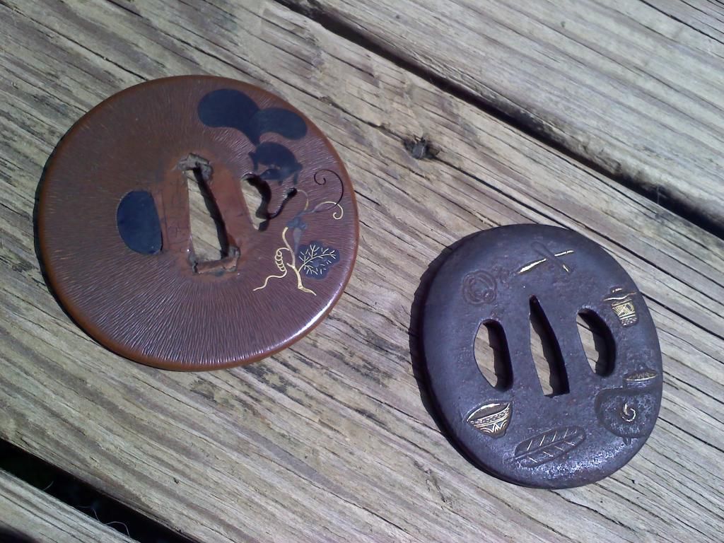

it up a bit, it could be used as a weed wacker. Nice tsuba!

Something seems way wrong at the kissaki. Hard to see what the cross-section shape of that is.
I think it could be cleaned up and make a wall hanger, but I sure would not swing a sword of unknown origin and steel in a businesslike fashion at a target. At least not without full armor on!

For what it's worth, the swordsmith's name on the tang is Kawada Seisa (Last name, first name).
No idea who he was, Seisa is not a modern Japanese first name, probably last seen pre-WWII.
Take the following for what it is worth which may be zero. Based on what I can see, the tang on your sword looks full length. AFAIK, antique swords used in WW2 had the tangs cut shorter and a 2nd hole drilled to fit the military mount. Prior to that swords used in the military had full tangs but also had a second hole drilled. The original hole was made via a round drift during the sword manufacture and won't be as precise as a drill bit. The second hole is made with a drill bit at the time the military mount was fitted and will have clean edges (usually). Yours has only a single hole which looks like it may have been drilled with a drill bit. But yours also has a fairly long fuller which I associate with machine made (power hammer & die vs. hand forged) Japanese military sword. Could it be a pre-WW2 made for the military sword? I am sorry but I don't know but... If I found this sword at a flea market I would not rush to do yard work with it. It has very pleasing lines which is definitely a characteristic of legit Japanese swords. There are a lot of things about it that do not scream fake to me and definitely warrant having it looked at by an expert.
