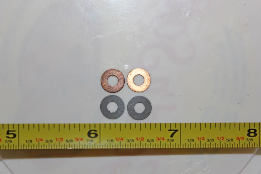

I grabbed the sculpted blue/black G10 model with the S30V Bos heat treated Non-serrated black blade. Upon opening the box, I was taken back by the feel of the knife. It felt great! The pocket clip is a great lowrider and the handle shape it very comfy. The blade is very sharp out of box and centered perfectly. Lock up is solid. I can see the draw and appeal of this knife. I am glad to have it in my collection. NOW, for the MAJOR disappointment.......there is significant side to side blade wiggle. It has nothing to do with the tightness of the pivot screw, but is a result of very small washers that allow the blade to rock back and forth. WHY, WHY, did they put such small washers in this thing? There is plenty of room for larger ones, which I plan to add myself, but a slightly larger pivot screw and larger washers would have given this knife a top rating. Why the short cut? Why are the designers at Buck missing this? This is supposed to be one of their best folders. I will keep the knife and improve it the best I can. I real do like it, but I have to say so very close, but no cigar. Does anyone know where to get larger bronze washers?

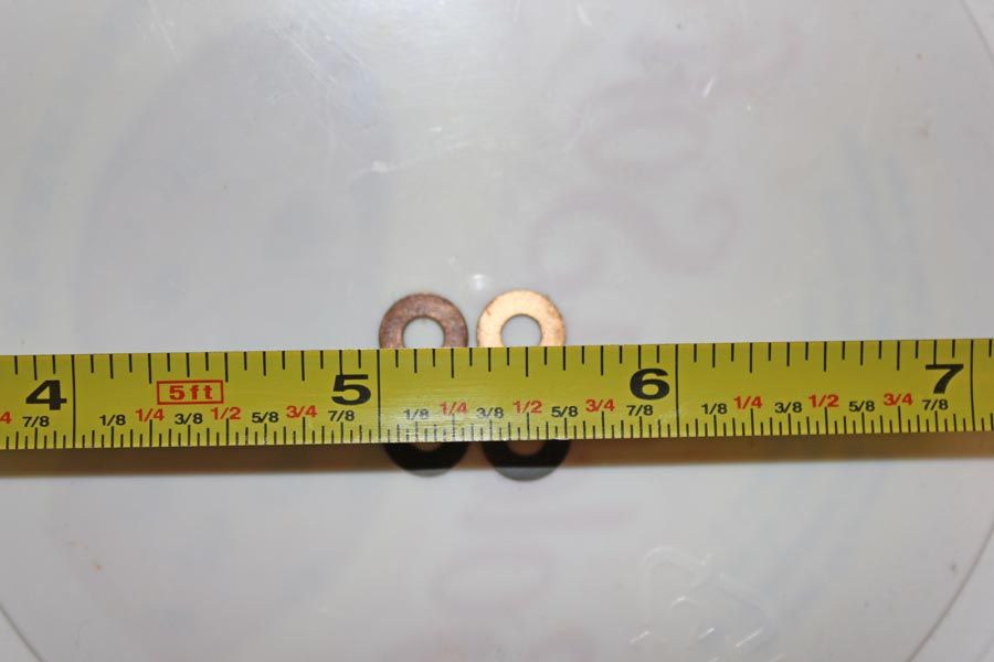

I've had a few of these apart and all have the same size washers whether they are the standard or Force models. I've never had an issue with blade wiggle either before taking them apart or after.
As you can see, the washers are pretty substantial in diameter @ 5/16". The bronze colored ones came from a standard Vantage and the grey ones from a Force.
