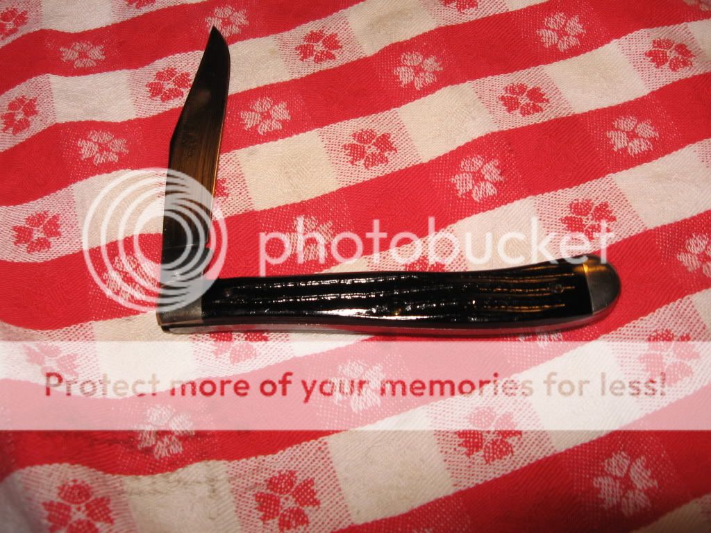

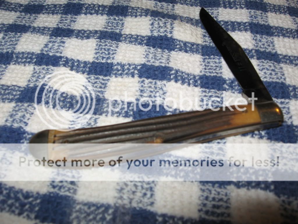

I got this Queen Cutlery #11 a couple of years ago as part of a trade and knew the condition when I traded for it. I know it wont see any pocket time in this condition so what would you guys do? Have the scales replaced? Or just let it be a desk drawer beater? The damaged side appears to have been scorched or melted by some type of chemical. The section of the blade on that side that is exposed has a cloudy appearance also. This is a sweet knife to give up on. Help me out guys.

Ya might soak it with mineral oil and see if it does anything. I don't know that it will, but there is nothing to lose. As Mack mentioned, it would make a good candidate for rescaling if it bothers you to much.

What I would do with that scale is buff it,use buffing fat/polish on a soft rag mop ( mask up your bolsters though-you dont want them blingy-yuk), you may be surprised, then sharpen it up, and get used to it being in your front pocket

Wouldn't surprise me, if it was a display case knife at some time in the past. Pretty common for one scale to change color, if only one side is exposed to direct sunlight. It appears to be the mark side on this one, which makes sense.

That knife looks like a good candidate for a dye job. I would give that a try before replacing the scales.

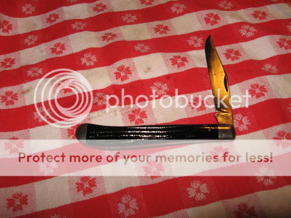

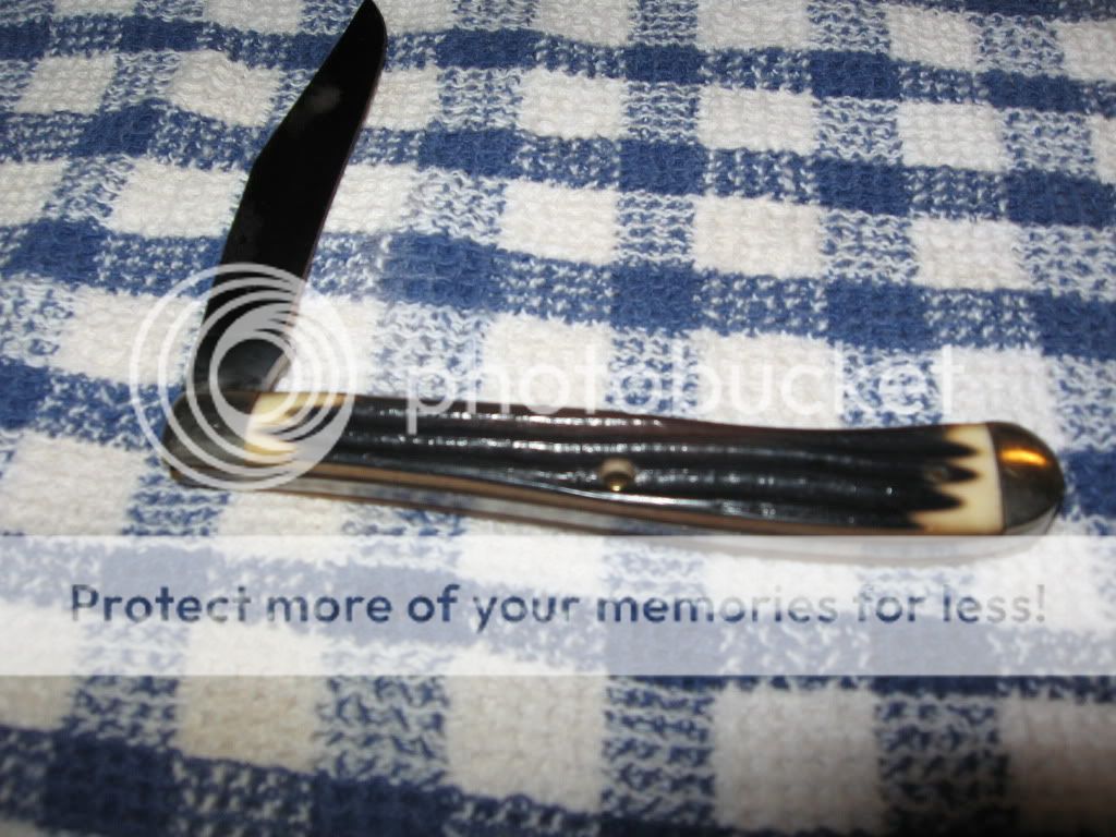

WOW.... That turned out great!
Thanks for posting pics of your new old knife Keith. I hope it gives many years of good service.
