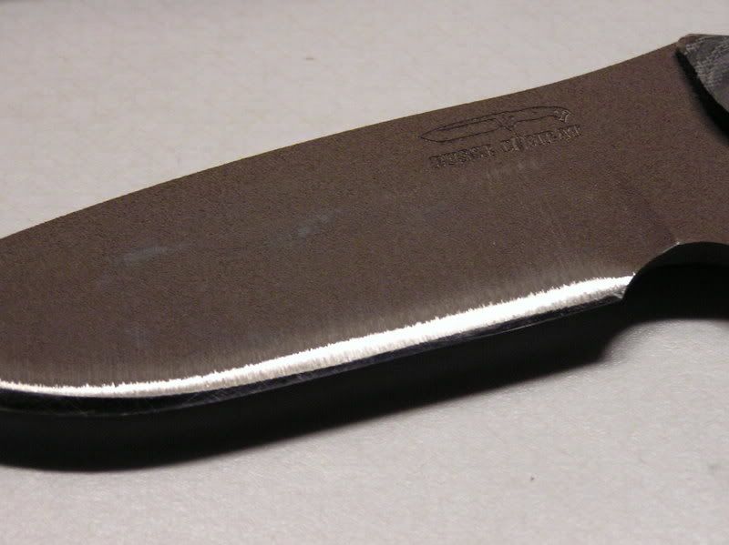

Let’s see if we can find the right forum …
attachment.php
I'll re-post some of what I said in the EDC thread - since it is more relevant here -
Sharpening is a much, much debated (and emotive) topic -
although I cannot disagree the single edge bevel angle is important -
in this case the more acute the better (within reason of course).
For the "average Joe" 45deg total inclusive is a good general edge bevel - and this is the point - on an EDC - which generally is for general purpose - this angle is actually pretty good - I mean, really, how many people actually shave with their EDC - as a real preference over their razors?
Again, yes, cutting through cardboard a more actute bevel will show advantages -
but I do not think it's the actual final cutting edge that's the main contributor -
I think it's the narrower/thinner profile behind the edge that's doing it.
Personally I think a single edge bevel is not really optimal.
This forces the bevel behind actual cutting edge to follow that angle.
Many, many sharpening instructions and books including the "Razor Edge Book of Sharpening" by John Juranitch - (which has been a sort of "bible" of sharpening for many years) - recommend a secondary or "transition" bevel - that is a bevel between the blade face and the actual final cutting edge, that is thin/acute - then the final edge bevel can be put on that's more suitable for the steel in use.
See also this very useful site -
How to Sharpen a Knife by Dee Griffin, DVM University of Nebraska, Great Plains Veterinary Educational Center
(This is so good I saved a copy several times :o, just in case the page ever disappears.)
On knives I use I try to put a sort of semi convexed edge - but the final cutting micro edge bevel is still the old trusted 45deg inclusive (ie: I lightly finish on some crock sticks set at that angle before stropping) - they seem to work fine for my EDC -
Convexed Edge
Vincent
http://picasaweb.com/UnknownVincent
http://UnknownVincent.Shutterfly.com
http://UnknownVT.Shutterfly.com
http://clik.to/UnknownVincent
