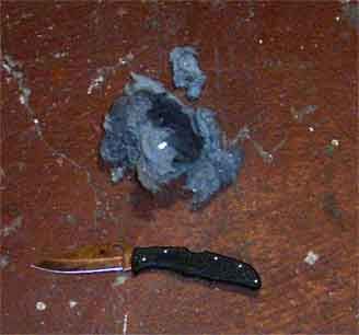

Mainly based on recent comments about instability of lockbacks with lint I used a cup of lint and a bag to check out the probability of contamination leading to failure :
http://i7.photobucket.com/albums/y269/CliffStamp/Spyderco/endura/endura_lint.jpg
It took on average about 8 sessions of shaking for 30 s to get the lock bar to not fully engage. The knife was also covered in lint by this time, and you could feel the bar mashing against the lint when opened. It just too a couple of seconds with a toothpick to pop the lint out.

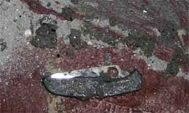

Ok but how about worse contamination so after cleaning out the wood stove I used the soot to get the knife fairly dirty, but it was trivial to clean with just a rap to knock the the dirt out, even if I hand packed it in :
http://i7.photobucket.com/albums/y269/CliffStamp/Spyderco/endura/endura_dirt_packed.jpg
So going to the extreme I made a paste, packed it in and then covered the entire knife in the mud :
http://i7.photobucket.com/albums/y269/CliffStamp/Spyderco/endura/endura_muddy.jpg
A couple of raps and the knife opens perfectly. The handle is also secure with the muddy grip, the checkering is very secure. Clean up was just a few minutes with soap and water.

Thanx Cliff, Reality is a firm, but honest teacher.

I demonstrated it can happen, several times. What the above is meant to illustrate, partly, is the probability and nature of the problem as well as issues with cleaning a knife without having to take it apart, even in fairly extreme circumstances.
I did this as well with a liner lock, Military, and three times in a row I had problems with engagement before six shakes. It doesn't take much lint to induce a resistance to the lock bar on a normal opening and thus the lock had partial engagement.
My Military normally opens to two lock bar widths (so there is a full lock bar with past full engagement), however after just a few bag shakings, this was reduced to just 50% engagement, and now the lock bar can experience shear failure.
I don't think any locking knives will function well if very dirty, so this doesn't show that the liner is problematic in this area, just that it isn't a critical specific weakness inherent just to lockbacks. Note as well that lubricant will make the situation worse as will humidity or food juices.

The problem with simulating this is the very low probability which is why I simulated a very high lint, and very loose pocket with the knife not being used in a clip and slammed around heavily.
The best way to examine this numerically would be to just do large sample testing, the real problem there is getting real data, since the indicent rate is so low, just a few people screwing around could drastically effect the results.
