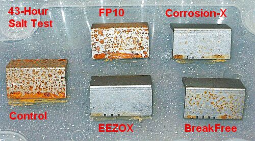

If you are interested in finding the best rust protection here are some links with comparative tests and reviews
http://www.6mmbr.com/corrosiontest.html
http://www.ctmuzzleloaders.com/ctml_experiments/corrosion/corrosion2.html
http://d2.myfreefilehosting.com/d2/Gun_Oil_Test.pdf
